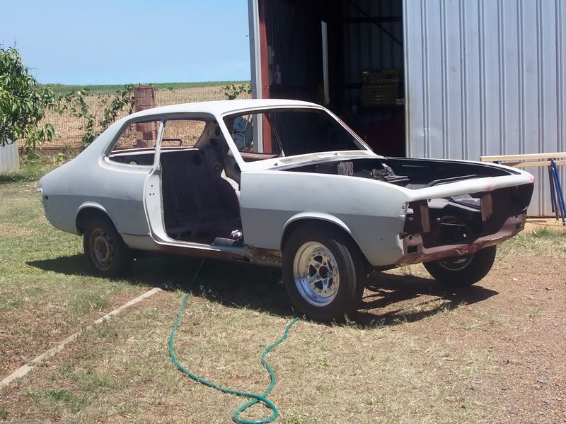

Posted 05 November 2006 - 05:41 PM

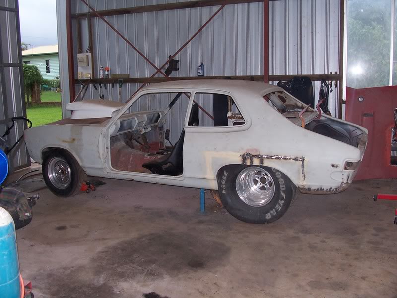

Heres a pic of the start of my pro street torana. Its going to have a blown 386ci small block chev in it out of my hk monaro which used to be 8/71 on it when it was in a circuit boat. I've got 15x3.5 and 15 x 14 aluma star wheels for it already as well as 4 link brackets, bars and shocks etc. I'm going to paint it Red hot which is a VZ commodore colour.

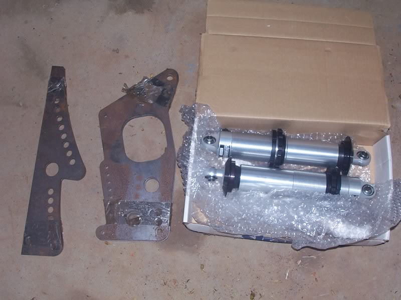

Posted 05 November 2006 - 10:01 PM
This is a pic of the four link brackets i got from Ken Lowe and the strange shockers i got from VPW. I look at mcdonald bros brackets but i liked the prostock style allowing the sway bar to be mounted to the top of them instead welding another bracket to the diff for that as well

I've put HQ stubs and discs on the torana and fitted my Weld aluma star wheels with front runners. Haven't got a lot done due to working on the monaro as well. Next step is cutting out the firewall and dummy fitting the engine and box and getting the car sitting where i want it before i cut out the rest of the floor etc.

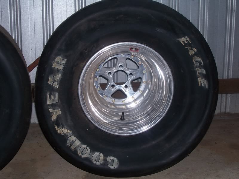

Posted 21 November 2006 - 07:46 PM

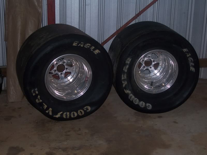

I've measured up the spacing between tyres i've got on my current rims. They are 33 x 17 x 15 which are 21 inchs side wall to side wall. With this width i won't have enough room to get the weld on the inside of the fourlink bracket closed to the diff centre. Luckily i Got a pair of 33 x 15 x 15s off Kerry Treymane which would of come off one of their prostock cars. They've done 20 passes with heaps left on them for $100. You've got to get a bargain sometimes. :rockon:

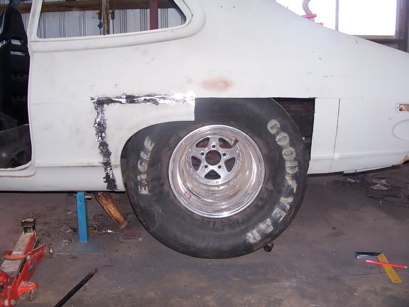

Posted 09 December 2007 - 02:41 PM

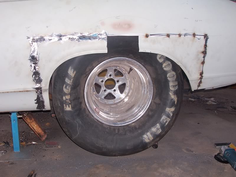

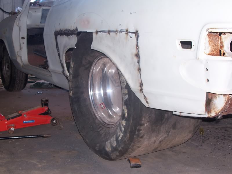

Haven't done much to both cars for a while due to working away but now i'm home everynite so i try to put an hour in each nite in the shed. I've got the rear floors and inner guards out of the torana and started to stretch the wheel arches to allow for the 33 inch tall tyres.I'm pretty happy with the way their turning out. :D

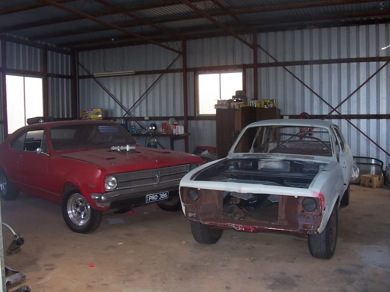

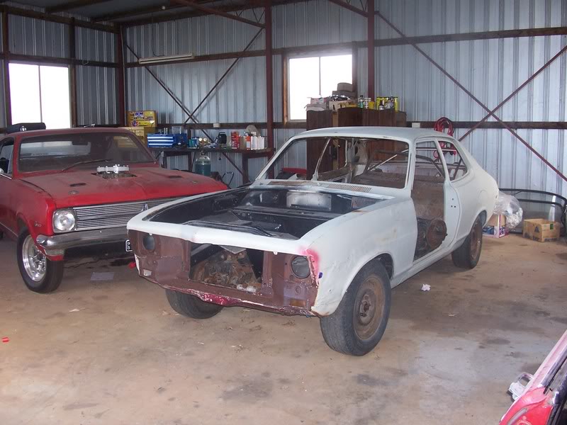

Haven't done much to the torana lately as been flatout finishing the paint on the monaro. My fourlink brackets are Junk so i'll have to get another set. Got them from a place that used to build a lot of dragsters and altereds so i thought they would be good to deal with. I was so wrong. :furious:. Any way heaps a pic of it at the moment.
