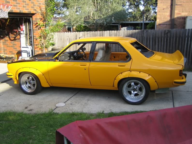

This thing is going to turn some heads when finished. It looks fat with those 315s on the rear.

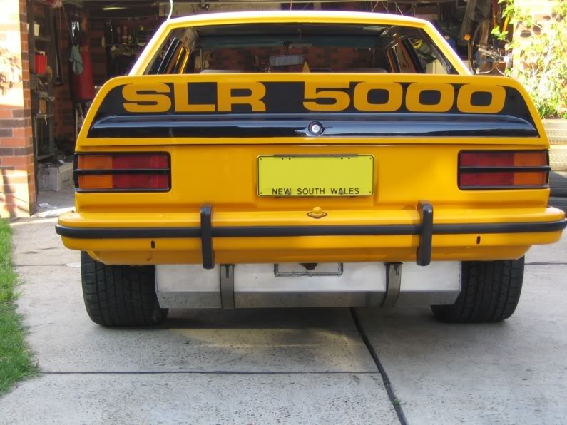

Those number plates should trick the speed cameras. Looks great.

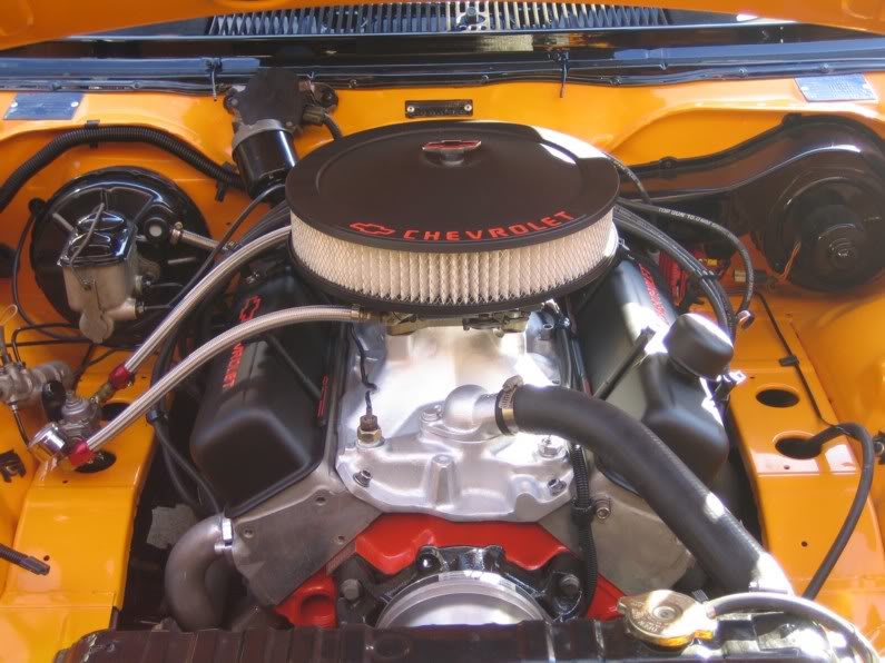

very nice. is that a chev in there, i cant believe the clearence on the extractors

What a ripper. The matte black rocker covers and air filter housing really set it off, and those Simmons are awesome; never seen them with dish!
What's that black hose that runs along the firewall under the wiper motor? Is that filled with wiring or something? Looks quite discreet; I like it.

that would be the wiring Heath, similar to mine, but mine goes under the booster

also keen on engine bay look.. 350 fits well.. amazing how there is soo much clearnace either side..
think its because its a smaller angle between the "v" of the banks.

ALX76, yep its a chev 350. There have been some comments on the clearance on either side of the engine. As far as I know the chev and 308 have the same 90deg angle on the banks. The difference is the head design and lower rocker covers on the chev make them narrower across the banks. Correct me if I am wrong and if I am I know I will cop it.
Engine is quite healthy, and has propelled the LH donor car to a 11.7 @ 116mph pass at WSID.
The headers are custom made, they were sourced from another unfinished project so came at the right price. They are 4 into 1s, 1 7/8 into a 3 inch collector. They are a very tight fit.
Heath, your are correct that black hose is the wiring loom.
LOWS2 and Makka, wheels are 17 X 8 on the front and 17 X 11 on the rear. Rear tyres are 315/35/17 (Nutboy will correct if I am wrong)
