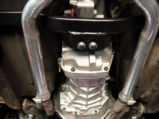

A few questions for you Craig...
1) Where did you get the cross member from?
2) How far back did you need to bring the hole in the floor?
3) When you cut the hole in the floor, did you actually cut into the arch support or only the thin stuff?
4) Was that engine a tight fit at the back?
5) What extractors have you got? Are they a custom VN / Torana style or are they just standard torana ones? (not sure if the exhaust ports in the heads are the same or not).
Cheers!

I didn't fit the engine & g/box, a local panel beater fitted it, i just have to wire it & fix up fitment problems.
The engine has the wrong engine mount brackets fitted (HQ), which caused extra problems with the extractors. The engine sits lower & further forward then it does with the original Torana V8 mounts. This causes the extractors to sit on or touch the outrigger leg on the X-member.
Pacemaker did the extractors, took several reworks, but eventually they fitted.
The bell housing needs to be cut away for the extractors to pass through.
The gearbox X-member is from CRS, & to fit the T5 in, the sub frame brace needs to be cut & boxed, approx 40mm in from the spot welded seam.
Kaz's photo's shows it fairly well. Thanks Kaz.
Use the stock VN type cable clutch bell housing & the clutch pedal from a 6cyl Aussie 4sp UC torana. The clutch pedal needs to be modified to suit the longer V8 clutch fork to get the pivot ratio correct. Use a std UC 6cyl aust 4sp clutch cable.
I'll ask Kaz nicely to take some more pics of the modified clutch pedal & dash panel next week. Then I'll explain some more about it.

I'm actually quite suprised the modifications needed to get the T5 to fit into the Torana. I would have thought it would have been a more straight forward fit (no cutting of the bellhousing & cut and boxing of the subframe).
Is there any reason for using HQ mounts? Does it give you more bonnet clearance for the 5 litre EFI or is there another reason you're not using Torana V8 mounts?
The fitted gearbox looks the goods! Well done.
