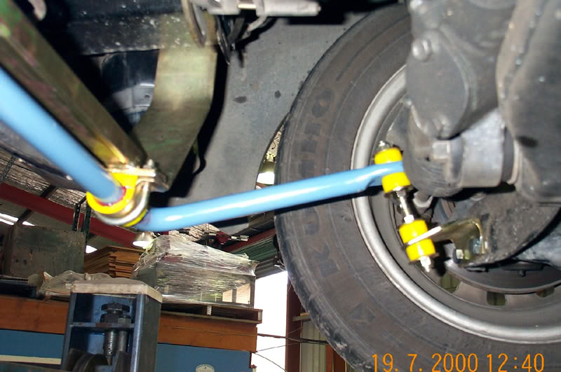

I received this email from Whiteline a couple of weeks ago.
Thanks for your interest in Whiteline products.
The part numbers to suit your Torana are as follows:
Front - BHF37      RRP $235.00
Rear  - BHR37      RRP $235.00
           KU4         RRP $65.00
           Please note, a KU4 U-Bolt kit will be required to accommodate the axle tubes on a 9inch diff
Please find the photos of these bars attached. We no longer powder coat our swaybars in this blue, it is in a silver metallic, but for illustration/orientation purposes there is no change in the bars. I can't confirm if these bars will accommodate a non-standard front spoiler or brake ducting as we've designed the products around a standard vehicle.
In regards to final pricing and purchasing information you can contact one of our distributors in your local area such as Autobarn, Burson, Coventry or Repco stores.
If you have any further questions please let me know.
Kind Regards,
Wayne Vickery
(Ph: 61 2 96030111
2 Fax: 61 2 98202500
* Email: waynev@whiteline.com.au

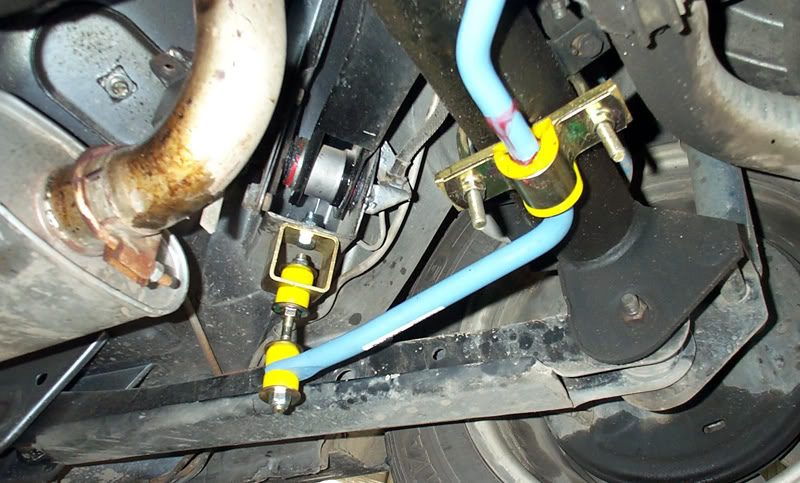

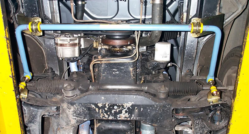

Front
https://cache.gmh-to...tch/hf35_01.jpg
https://cache.gmh-to...tch/hf35_02.jpg
https://cache.gmh-to...tch/hf35_03.jpg
https://cache.gmh-to...tch/hf35_04.jpg

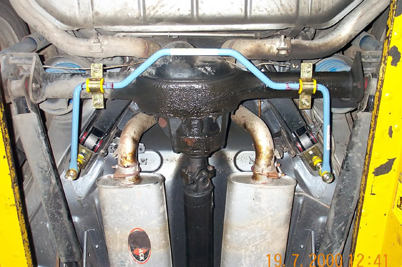

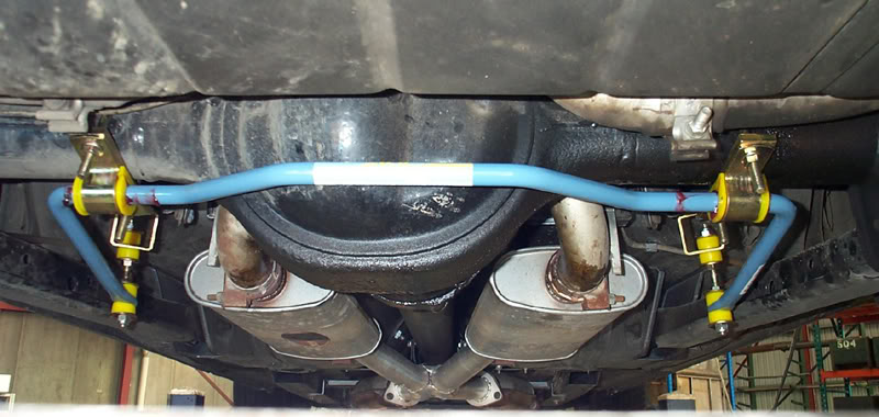

Rear
https://cache.gmh-to...tch/hr37_02.jpg
https://cache.gmh-to...tch/hr37_03.jpg
https://cache.gmh-to...tch/hr37_04.jpg

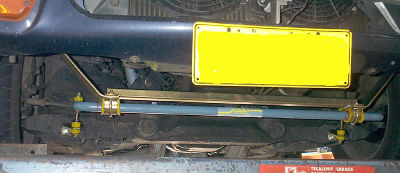

Yes, the Whiteline look the same as the old Selby's front mount bars, they mount "directly" to the front rails (no surprise given Whiteline is the old Selby's).
#4 ls2lxhatch
Posted 08 May 2007 - 05:19 PM
In this picture you can see the bar has a selbys sticker.

You guys are so QUICK! I am guessing the Whiteline one fits OK with the std front spoiler and brake ducts?. Hard to justify the extra cost of the KMAC..adjustable or not..Strange the rear Whiteline uses the axle as the twisting part and the stock rear bar fits to the trailing arms?..Guess they know what they are doing.
P.S. He gave you the wrong number..the forward mount Whiteline is a BHF 35...not a 37.....37 is std replacement rear mount one.
Edited by rorym, 08 May 2007 - 05:32 PM.
#6 _The Baron_
_The Baron_
Posted 08 May 2007 - 05:35 PM
Rear pick up point are very similar to A9X.
Edited by The Baron, 08 May 2007 - 05:36 PM.

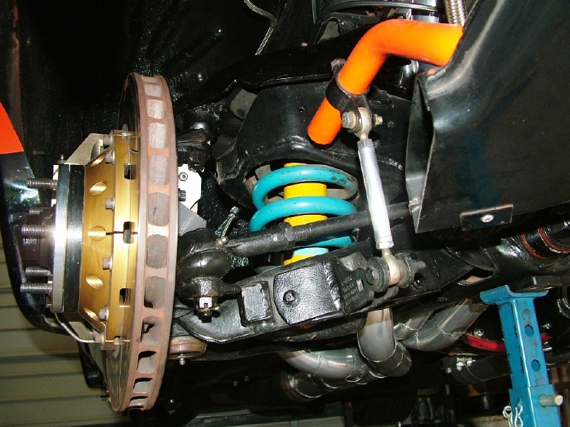

Litre8
Is your front bar available from Whiteline? It looks like a good setup.
http://www.litre8.co...ont_discs_1.jpg

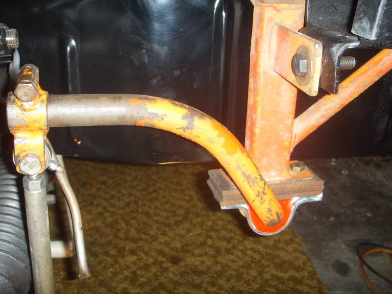

this is a mix of old and new kmac components.
must say that the old components are more rigid than the new in their construction
as you can see the "delete side splash guard" comment is a weird one.
Edited by arrimar, 08 May 2007 - 05:59 PM.

#11 arrimar
arrimar
  • 3,134 posts
  • Location:brisbane
  • Joined: 13-January 06
Posted 08 May 2007 - 06:03 PM
the rose jointed link pins are special order if you require them. the standard ones they send out nowdays are quite different.
the lower control arm bracket is a piece of crap in my opinion. soft as putty and needs some mods i reckon.

Im going KMAC on mine Rory, Darrens hatch has the whiteline
#13 _rorym_
Posted 08 May 2007 - 07:30 PM
Hmmm...Twice the price and the only thing that was swinging me was the huge lower brackets bolted to the arms...but Howard says the later ones are a bit softer?...The Whiteline ones..brackets ,,look quite flimsy compared. Still dont know.
I could get the Whiteline and get stronger lower brackets made. If the rose jointed are are extra the KMAC is looking way over priced. Might be easier to get the Whiteline and improve it. Howard, is the lower arm bracket in that pic ^^ the old or the new?
Edited by rorym, 08 May 2007 - 07:32 PM.

This is the Kmac bracket I have.

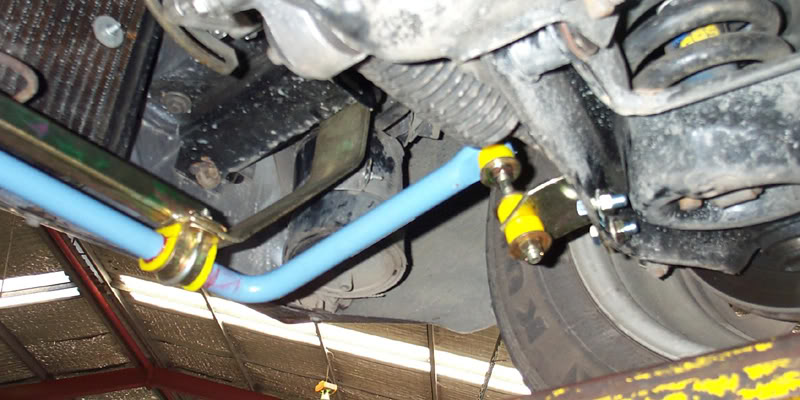

Howard...got a pic of the front bracket holding the bar?...u have nearly convinced me.
#16 Litre8
Litre8
    Thrillseeker
  • 2,399 posts
  • Name:Howard
  • Car:1976 LX SLR8000
  • Joined: 05-February 07
Posted 08 May 2007 - 08:01 PM
here it is, note the droplinks in the previous pic are ones I had made up, Kmac ones use neoprene bushings.

Bugger that it cuts into the brake duct. :cry:
#20 _rorym_
Posted 08 May 2007 - 08:15 PM
Just looked back at the Whiteline one...brackets look REAL flimsy now.

I believe the more recent Kmac brackets clear the brake ducts (my setup is 1990)
