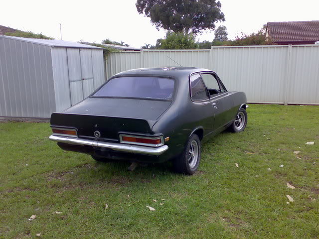

So... off to EBAY to buy a shell/roller/complete car.
Ended up buying this beast - not too pretty to look at, hehe
Posted Image
She's rough, and needs some work, but it's a good starting point... It's complete, and almost runs. Has her fair share of rust, but it's all repairable, and these cars are getting rarer. Also, you can't get much of an LC 2 door for what I was paying

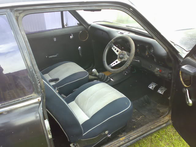

The interior which I didn't plan on keeping, but thought someone else might like it.
Turns out the door trims are a bit dodgy and screwed on, and the back seat is kinda screwed in too. So, I'll probably have to buy some new door trims and rear seat for my 'complete' LC, instead of just getting the existing ones retrimmed.

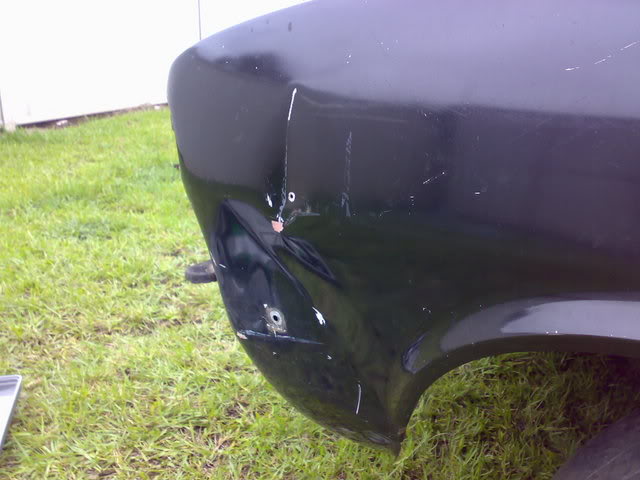

Nice dent... passenger side was dented, drivers was repaired with bog falling out

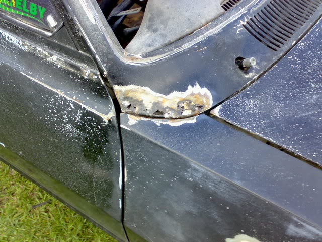

Both sides of the front cowel had been bogged and looked fine, but when I sanded a bit, I discovered the rust - look at that paint work, ouch.
Posted Image

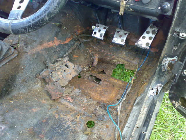

The floor is pretty awesome, we saw it was rusty when we looked at the car, but we didn't realise it had been repaired once before! Both drivers and passenger side had a new floor pan welded over the top of a rusty floor! And... the 'new' floorpans were now even rustier than the ones underneath!
Must have had something to do with dodgy siliconed up sunroof
It also needed a rear drivers floorpan.
Posted Image

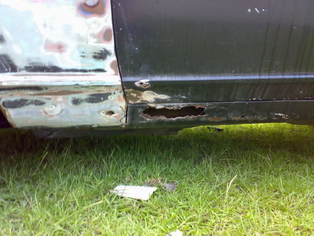

Both sills needed replacing, along with the bottom of both front guards. Passenger side was worse than the drivers side.
Posted Image

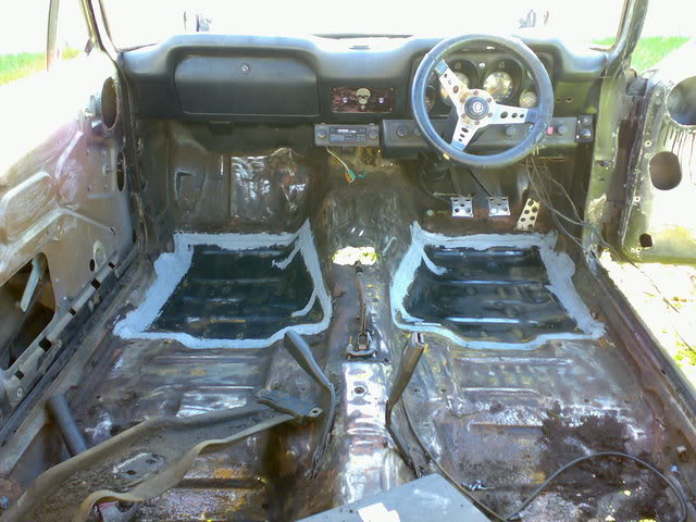

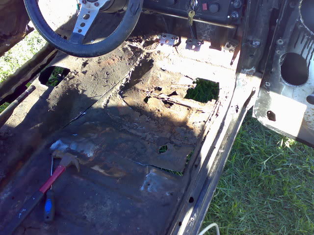

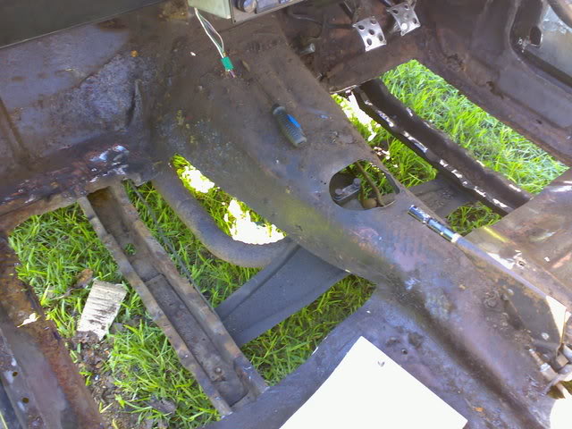

The Floor

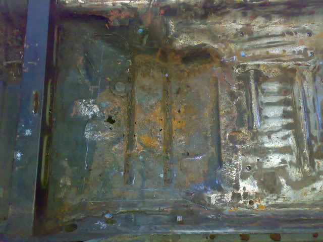

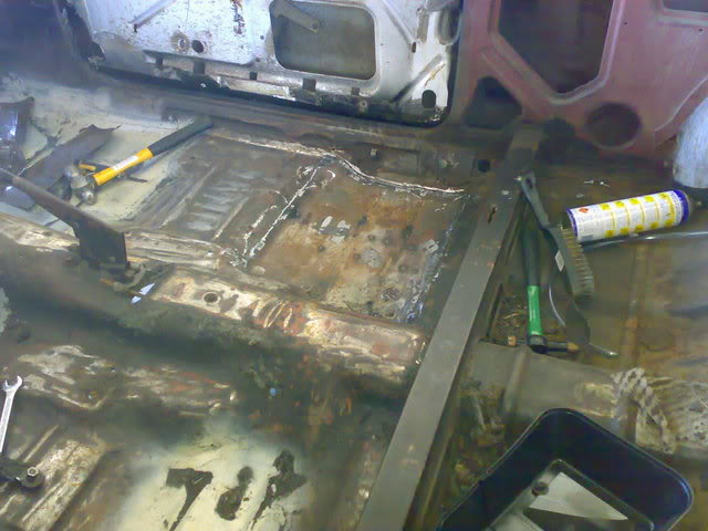

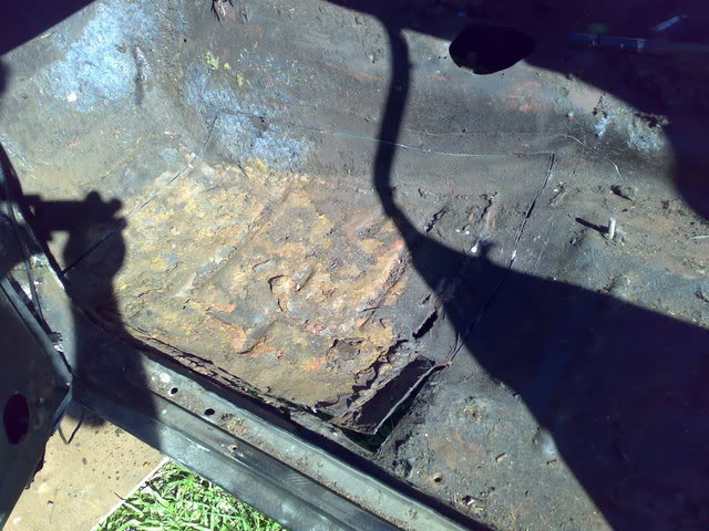

So, the floor was really rusty.
The two front floor pans were rusted, and then had extra floorpans welded directly over the top. Crazy!
Anyway.... I ordered some replacement front floor pans, had my brother come around, and this is where we were at.
Posted Image
This is the passenger side floor pan... the 'new' top one wasn't too rusty, but there was one underneath that was #@$^%&, so out they both come, and a new one will go in. This is cut out, and actually only had two spot welds holding it in.
Posted Image
Another shot of that super flintstones style drivers floor... gotta love it! All cut out, ready to be seperated from the chassis. This side was much harder, had a heap of spot welds and the floor was rusty, so I couldn't see where to drill them out.
Posted Image
Is this how a rust free floor is supposed to look? :)
Posted Image

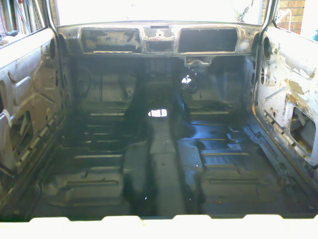

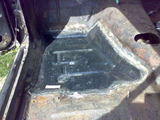

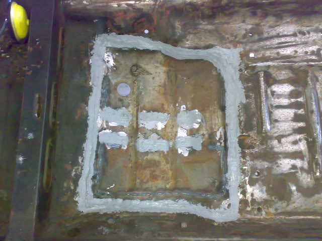

Once we'd cut out both floors, we found we needed to do repairs on both sides of the car before the replacement floorpans could go in. That's my brother on welding duty... couldn't do it without him!
Posted Image
After a couple of repairs, and welding a new floorpan in, this was how she looked.
Posted Image

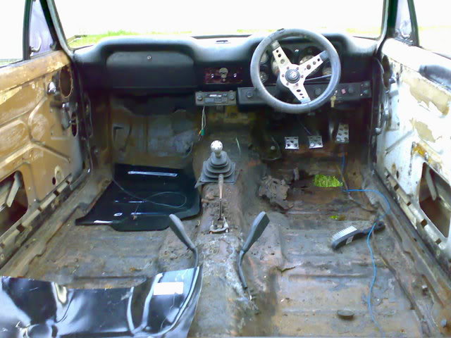

Fast forward.... both sides are cut out, repairs done, welds ground back a little. I probably went a bit overboard with the seam sealer, but I wanted to make sure no water would get in anywhere :)
Posted Image
We chased a few holes on the passenger rear floor, so that's all good.
I needed to source a replacement pan for the drivers rear, as that was too far gone. I ended up getting one off this forum from a member named 'limo', thanks bud!
So, that's all welded in and seam sealed aswell.
The floor is now rust free :spoton:

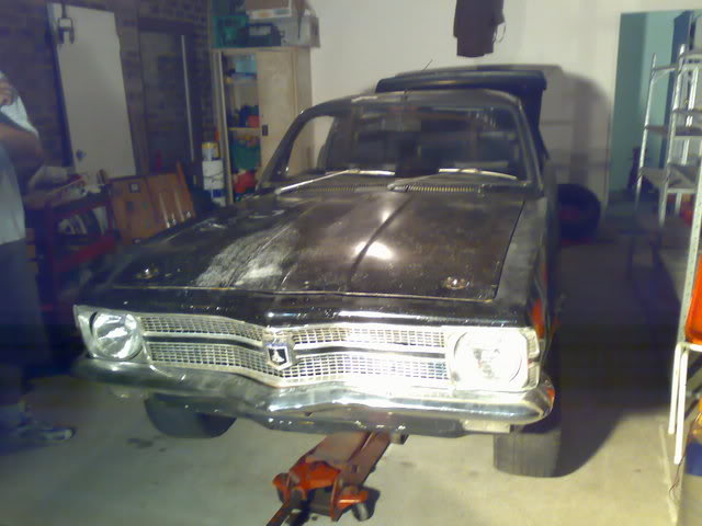

More of The Floor

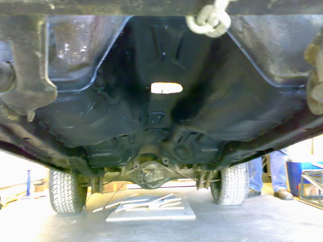

Here's a few more pics of the floor.
The repair I did on the rear pan a couple of weeks ago, and the painting I did today.

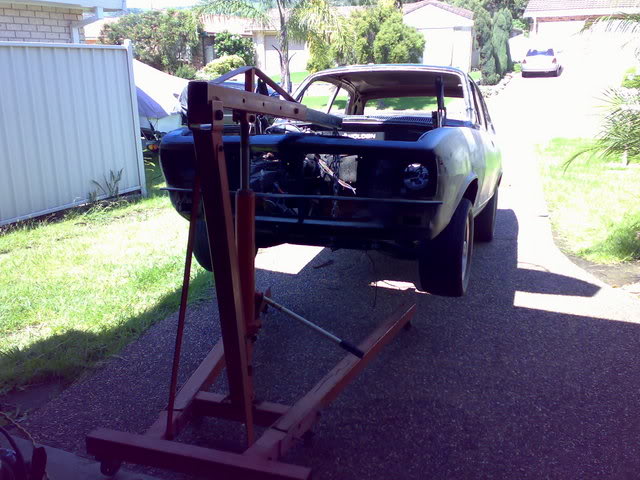

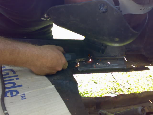

When we had to weld underneath the floor, we lifted the whole front of the car up with an engine hoist. Then my brother got under there and did all the hard work :spoton:
Posted Image

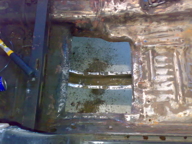

The following is the rear floor pan in it's rusty glory, then a hole, then welded, then seam sealed.
A bit overboard on the seam sealer again :)
Posted Image
Posted Image
Posted Image
Posted Image
And then today, after I finished doing some other welding for some other repairs, which I'll post about later on, I decided to paint the floor and make it look respectable again :)
Posted Image
Posted Image
That's the most recent thing I've done, but there's still a few other repairs for you guys to catch up on. I'll upload some more pics in the next day or two and show some other things that have been done :)

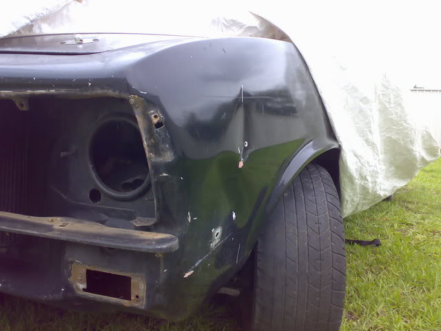

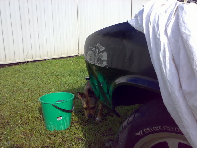

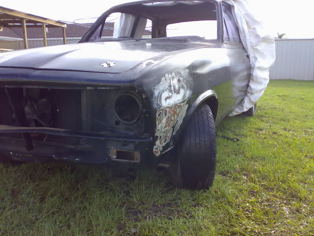

Front Guard Repair

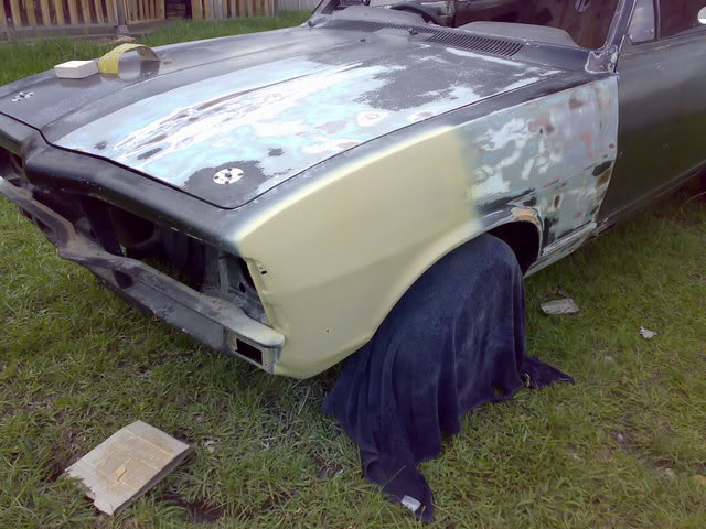

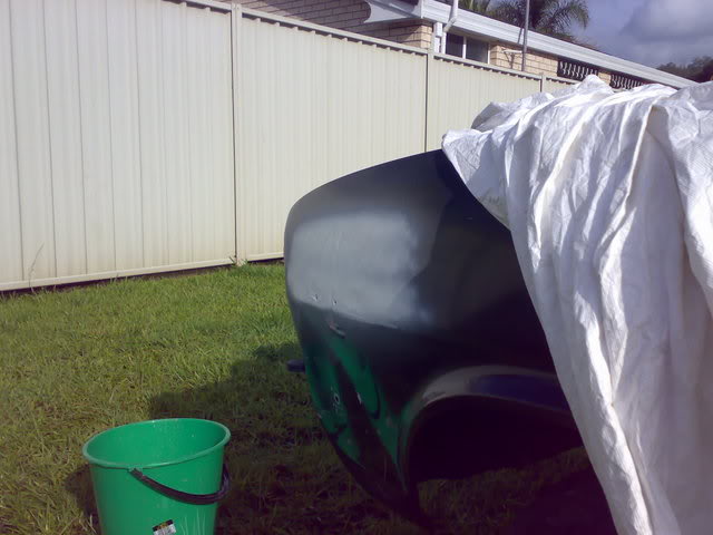

It had nice dents on both sides of the front guards. The passenger side had been untouched, the drivers side had a repair a while back, and the bog had cracked, and moisture got underneath and the metal was pitted.
I don't have any pics of the drivers side repair, but I did take these ones of the passenger side.
This was how it looked to start with.
Posted Image
Posted Image

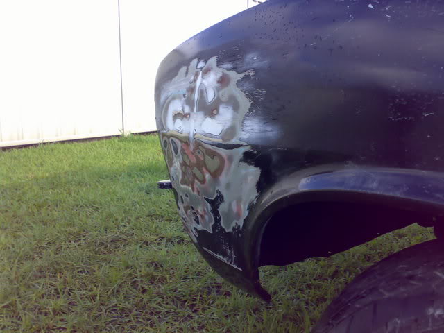

I started on it with a hammer and dolly (never used one before, I'm just winging it here!)
To make it more noticable for me as to how it was coming along, I sanded it a bit to check out how low the low spot looked.
Posted Image
After some more banging, I threw a bit of paint on there to give me a better idea again.
Posted Image
Then I started on the bottom dent, using the same process.
Posted Image
Starting to look like the original shape!
Posted Image

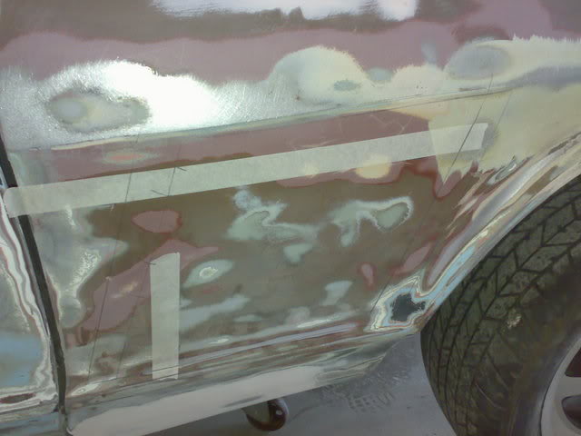

After I got it as close as I could I sanded it back a bit and then put a wipe of 'contour restorer' over it, gave it a sand, and the result looked ok. I chucked some paint on it cause I can see the lines better on it that way.
Posted Image
It looked good, but when you ran your hand along you could feel a low spot, where it was a bit flat and shapeless on the top. So since then it's had another wipe of 'contour restorer', and it feels pretty close now :)

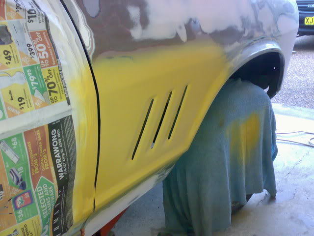

Posted 26 June 2007 - 06:25 PM
mmm... flutes...
Now it's looking like a torana!
My flutes finally arrived after about 3 weeks or more.
I've got other pics of different stuff I've already done, but this makes it look like a real torana, so I'll post these first :)
I started on it yesterday after work, and finished today after work.

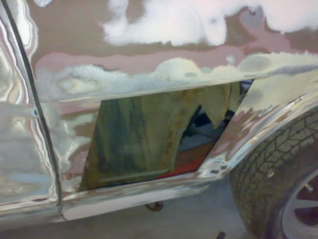

Before Shot. Was marking out where to cut. Made a mistake, that's why there's so many lines. Good thing it's me cutting it hey... :) (edit- maybe I should name the car 'Neapolitan' ;))
Posted Image
That's a big hole....
Posted Image
We've all seen welding, bogging and sanding before, so we'll skip to this one :)
Posted Image
mmmm.... sexy.......

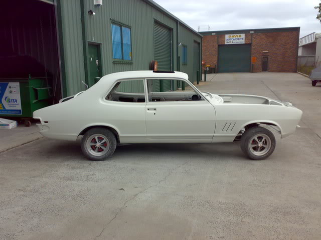

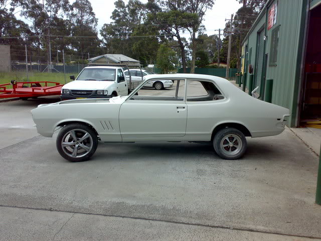

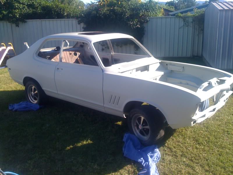

So....
This is how the car looks at the moment.
Most of the lines are good now. Needs a lot of little things fixed, assorted imperfections and little dents that show just how hard a life the poor things had.
Posted Image
Check out how huge this 17" commodore wheel looks, hehe :)
Posted Image
I think I'm nearing the end of my patience and ability here though.
I might spend another day on it, then send it off to a panel beater for a once over and the actual spraying of the colour. Still undecided...

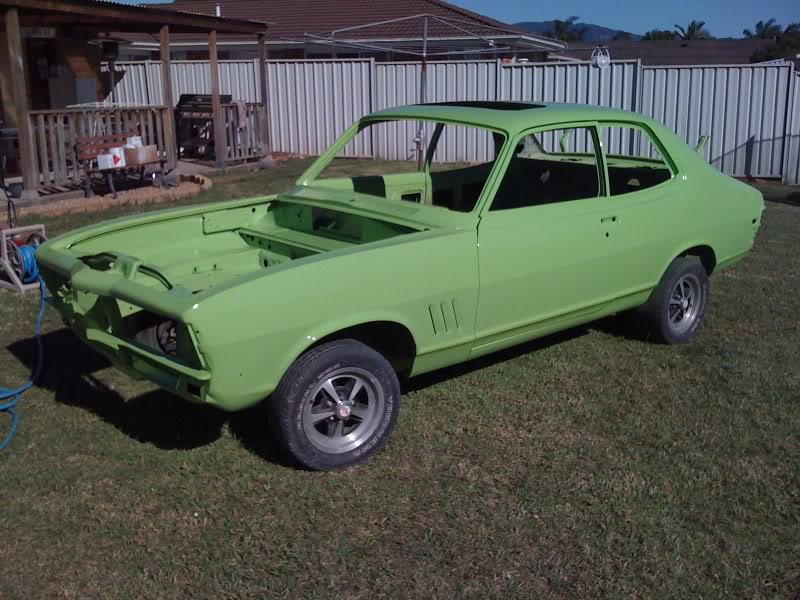

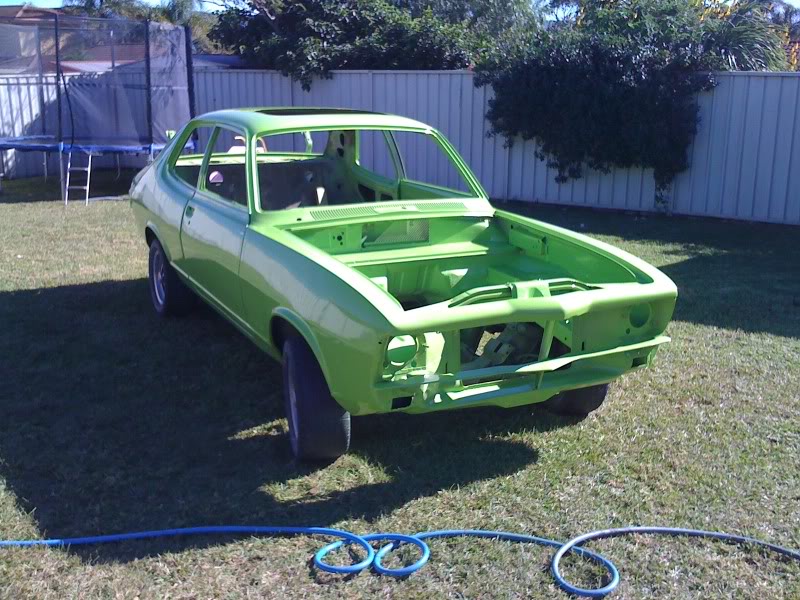

So after a 'little extra work' I decided I'd paint it Lina Mint. I would have preferred a red colour, but I had zero confidence in my body work, so I thought I'd go for a lightish colour which wouldn't exmphasize my lack of talent as far as sheet metal is concerned.
I went to the local paint supplier... no Lina Mint 2k. They ended up mixing some up in acrylic and matching it for me.
Here we are, just before paint.
Posted Image
And just after paint
Posted Image
And the other side
Posted Image
I DON'T LIKE THE COLOUR.
ummmm
SHIT.
I think it's too dark for Lina Mint. It's too bright... I was expecting something a bit more pale. The photos don't demonstrate just how green this green is.
Oh well, it's progress at least! The wife likes the colour, she originally suggested orange. So to have her approve the green I don't like is a little validating for me.
Stay tuned for more!

hahaha. Oh Bedford, the dilemmas we face when building these rotten cars : )
I don't mind the colour actually, but you forgot to fill the big hole in the roof. If you put the blackouts on it, it might make it look a little less green??
I think if the missus likes the colour then she wont be upset when you stick a 383 stroker and T56 in there : ) I think it needs it. Well, I think every car needs it : )
p.s. your baby is beautiful. Congrats.

I can see what you mean, but before you get too worried about the colour try adding some contrast. Sit the bumpers, grill, tail lights in place. Play with some black contrast using some tape or something. You might find its not nearly so bad when its not all the same solid colour.
Haven't seen this thread before, looks like you've done a good job bringing it back and I'm sure it will be great to have it driving again! :burnout:

Photos don't look like they show the colour at all.
I hate reading things like that... very disappointing. But there is always a chance that it will really 'grow' on you. When I bought my car I thought bright green was an awful colour, now I like every bright colour pretty much hahaha Toranas should be nice and bright, and Lina Mint is tasty I reckon.
With some black around the windows, maybe some black on the sills or a GTR style offset twin stripe in black, I think it would look incredible. It's hard to visualize a car's colour well when it isn't assembled so there is no contrast.
You can always paint it another colour if you want to...
