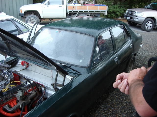

Been reading and posting for a bit now, thought it was time to put up my ride, its a 73 4 door LJ.
I found it from up north in NZ, had been looking for a while and this one was mint so snapped it up.
Pickup

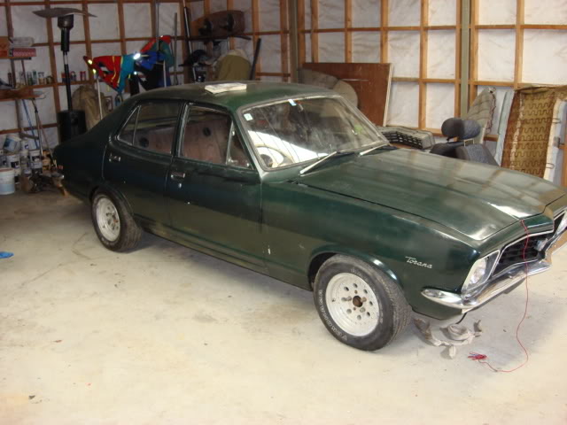

Home

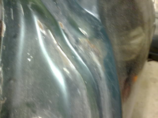

Rust - The biggest bit of rust is on the left rear body pillar

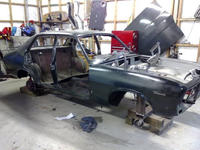

Stripped

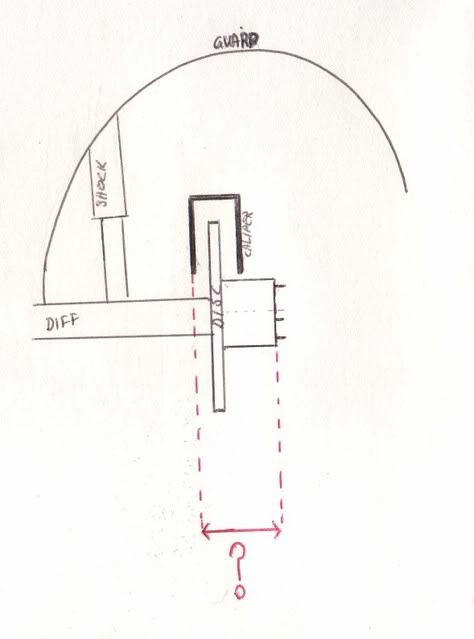

#9 _onefifty_
_onefifty_
Posted 02 November 2007 - 12:08 PM
So i went to see some diff peole today, you might be interested in this shunty.
Went to Diffs R Us and rough quote was $1300 shortened and mounted etc, but i have to supply my own diff.
And the place you suggested, Steelie Gears, I assume it was tony i talked to, anyway was $1600 which includes a VN LSD supplied from him, I think ill go with Steelie Gears.
Both dudes were pretty onto it and recommeded i get my wheels first to find out the overall length i need. Only thing is i want to get Simmons and i need specific measurements of where my hubs, calipers etc are going to be :blink:
I can not go to short because the the inside edge of the caliper must clear the shock, but how short can i go. So does anyone have a measurement from the hub face to the inside edge of the caliper please? i have drawn a pic if it helps.
Then i should be allow for some room, calc the hubface to hubface measurement for diff builder and get the shortest diff possible? I think. Will this work?
Thanks
Steve

#11 _onefifty_
_onefifty_
Posted 03 November 2007 - 07:56 AM
I want to get Simmons FR17's, so 7" is the widest i can go, with a 215/40R17. Would that be ok?
I want to get the most dish possible (i know it wont be that much), that is why i wanted to get the diff as short as possible first.
What do you think?
