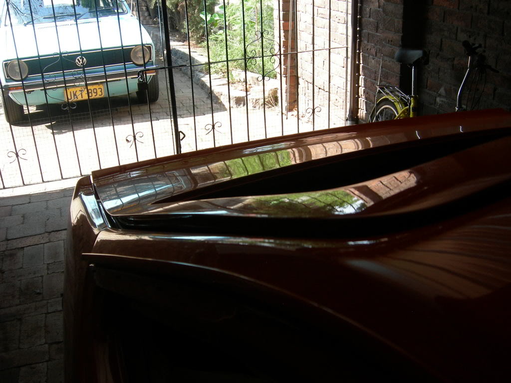

#17 _Chamois hatch_
_Chamois hatch_
Posted 20 February 2009 - 02:55 PM
i purchased a hatch seal 6 months ago, panel shop said the hatch lid sits perfect without the seal...but the seal makes the hatch lid sit about an inch high, absolute rubbish.....
here's the problem....
im still am going to try to make adjustments but its not looking good.
Edited by Chamois hatch, 20 February 2009 - 02:57 PM.
#18 _les_
_les_
Posted 20 February 2009 - 05:01 PM
Chamois hatch
Give Lance Corby a ring at Rare Spares 03 93036400 on Monday or email him lcorby@rsp.net.au he is our fitment guru I have already sent him the link to this topic

#19 _ass308_
_ass308_
Posted 20 February 2009 - 05:47 PM
hey chamois hatch,least u got the rubber to go around the top corner,and stay in the channel.i cant do that.my hatch however,shuts way better than that.theres something way wrong there :(.do u have a packer between the hinge and the hatch ?.im not suggesting a packer would lift it that high,unless it was a inch.but i am curious,as changing packer size,for me,by only a little bit,bought my hatch down nicely.
are u sure thats a hatch seal ?,it looks big after studing it for a while
i am currently hitting my door rubbers every day with rubber majic,and it seems to be working.they were,old stock bought years ago.been through several summers on the car,with the doors shut and they still wouldnt shut properly.
#20 _ass308_
_ass308_
Posted 20 February 2009 - 06:31 PM
hey chamois hatch :)
theese arent the best shots but i just snapped them off.the hatch seal i got from rarespares
does your rubber look like that.
i dont want to insult u,by asking if its in the right way :<_<: .but are u sure it is ?.your rubber sits way to high,to be like mine
