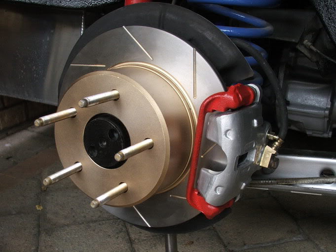

Hi guys I just got my new backing plates back and I know all you guys want to know how to do it so I took some pics and will give you the details
Basically the centers need to be welded up and bracketry removed, rotated and replaced
I dont really know how to explain it so I will put up the pics and hope they help
New backing plate with hand brake mech moved.
left is original Right shows that the brake caliper holder part and hand brake mech has been moved.
(the part shown on left is what needs modifying)
Flip side of same. (note hand brake lever slot)
The end result.
Torana brake lines fit but I need new ones as mine were cut.
The next photo shows why I had my brakes put to the front (they hit the shockies BAD)
I hope this can help you guys as I found it confusing but it is an easy conversion once you put your mind to it.
P.S. I was told to use the torana hand brake cable and find a cable company to put commodore ends on that..

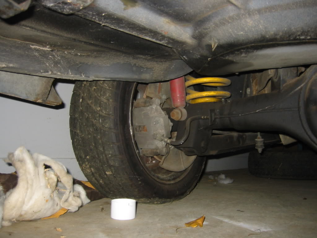

Yeah, my diff is shortened. Here's how close mine is:
QIKSLR; looks like your very close to touching there! How much have you shortened you diff by?
Im wanting to run vn disks too but i have gotten my diff shortened by 2 1/5 inches either side. Ive dont think it would clear the inner gaurd or shocker?
#14 _QIKSLR_
_QIKSLR_
Posted 27 June 2006 - 08:28 PM
nah im still using a bango
Ah, I reckon it's an oil seal issue.
355LXSS, I think my diff is only shortened an inch all up, so I reckon you'll definately will have problems. However if we can work out how to do the above mod, we'll all be sweet.

#16 _toddy_
_toddy_
Posted 07 July 2006 - 04:06 PM
Ok Guys
I havent been on here for a while and I am guessin that you all need to know how the hand brake works
As in the pics the backing plate needs to have the hand brake mechanism removed and rotated, Basically turned around so the left and right sides can be swapped
I dont have an old backing plate but I will try to get one so I can post a pic of that
I will also pull a wheel off and post a pic of my brakes mounted with no rotor so you can see how it looks...
I can see this in my head but it is hard to explain
get original backing plate and place on axle
Observe where hand brake mechanism sits (this needs to be moved)
Remove hand brake mechanism
rotate backing plate to desired position
replace (weld in) hand brake mechanism
axle mount bolt holes need redrilling and relocation
splash gaurd needs to be either re drilled or redrill the backing plate
bolt it all together and done
Now that I have written this I am going to get an old backing plate and cut it up and take photos to show you...That will be easier....
OR
cut around the base where the dust cover joins rotate that and weld in ( not reccomended) but easy
