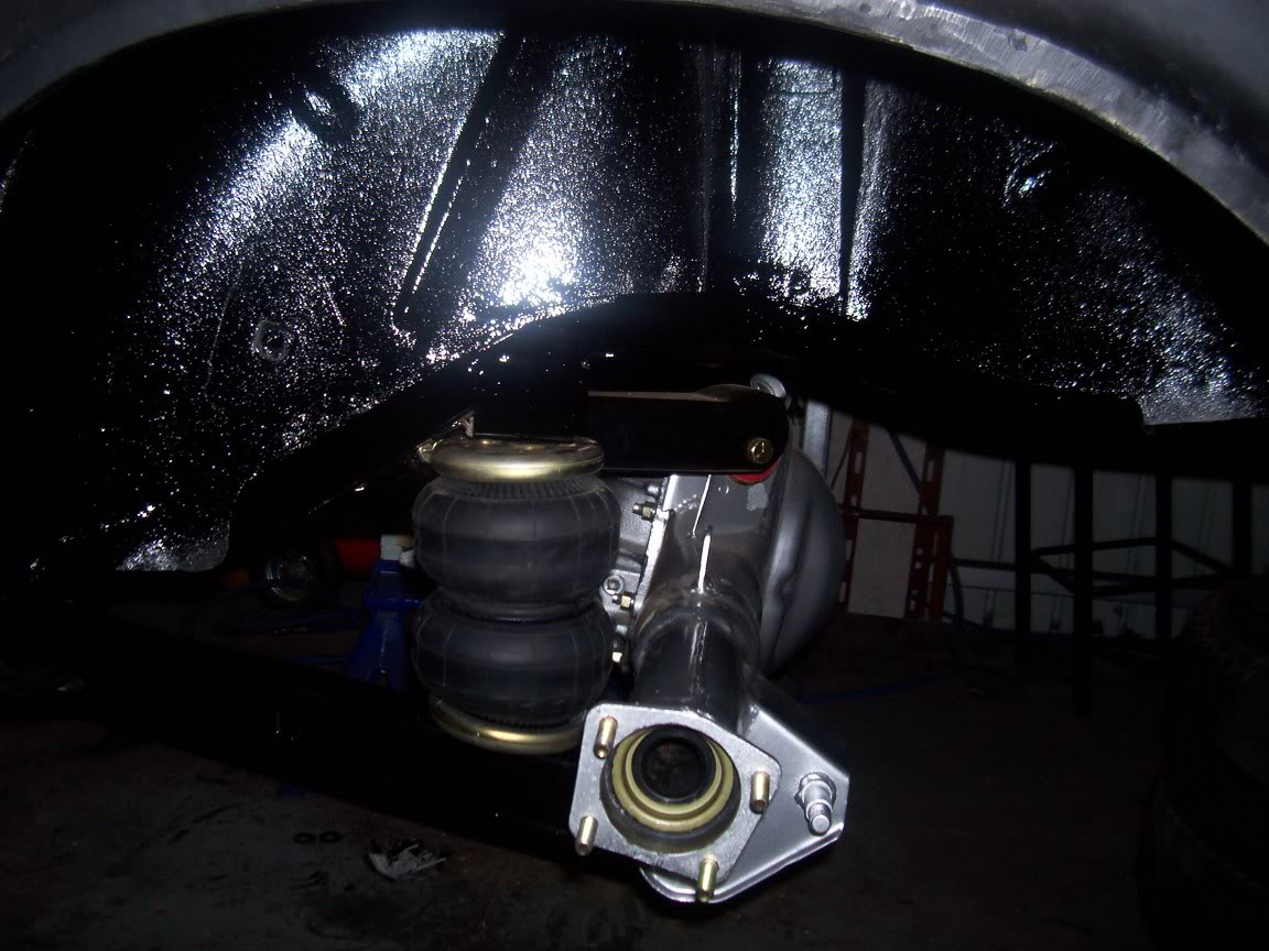

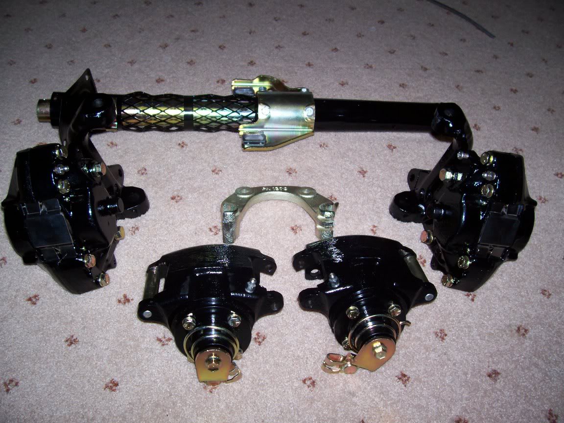

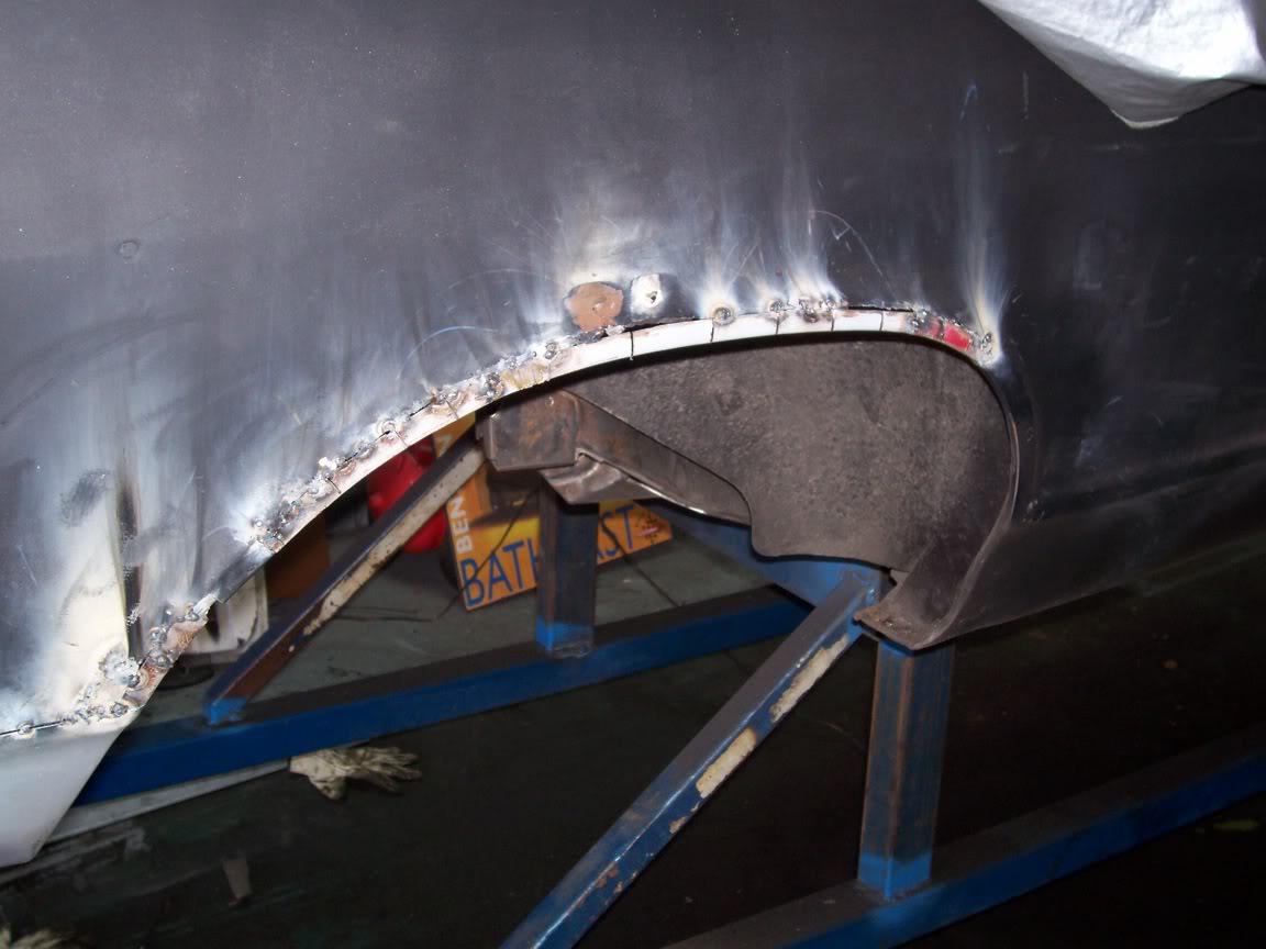

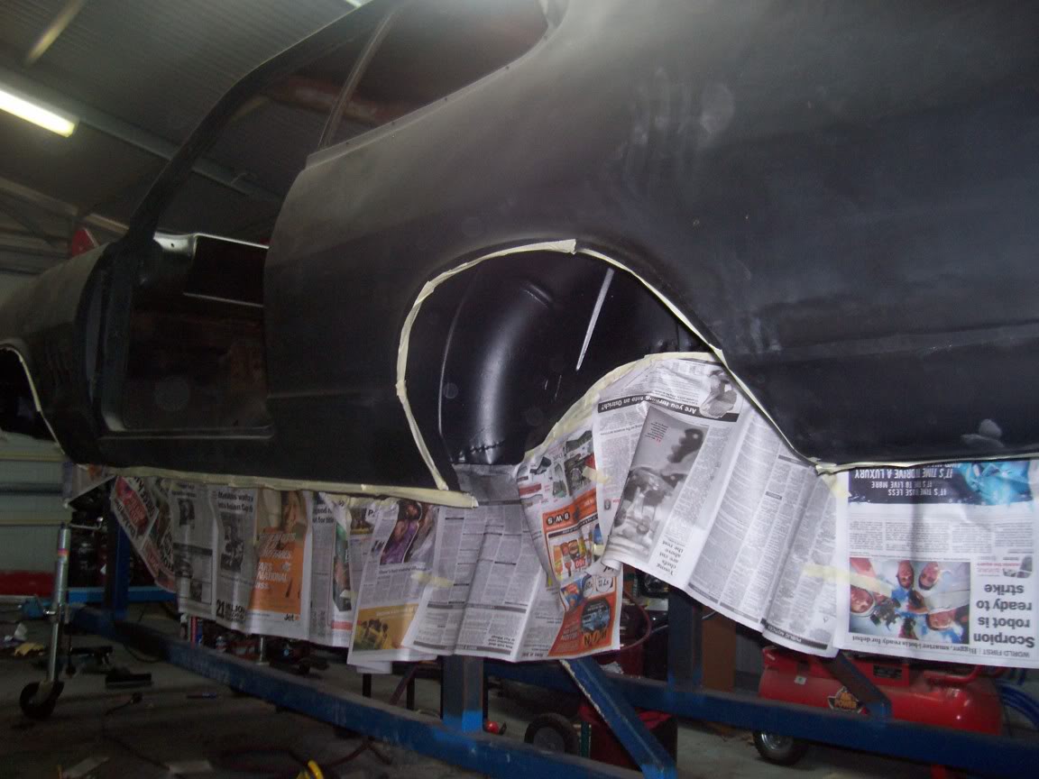

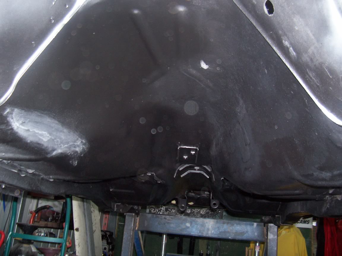

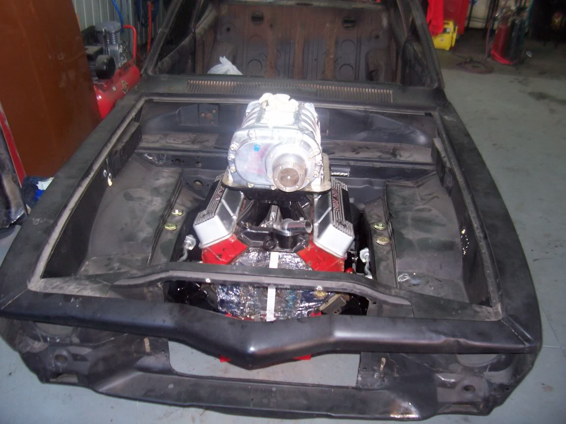

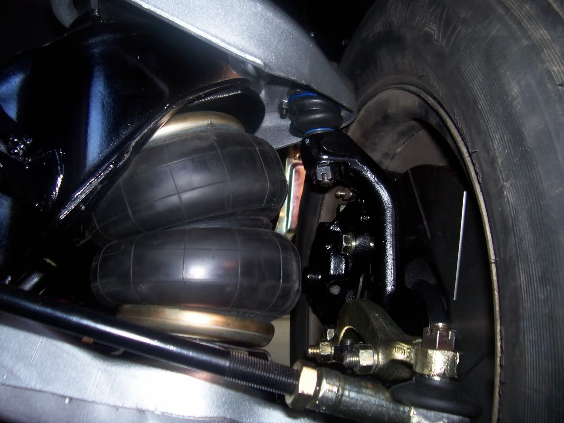

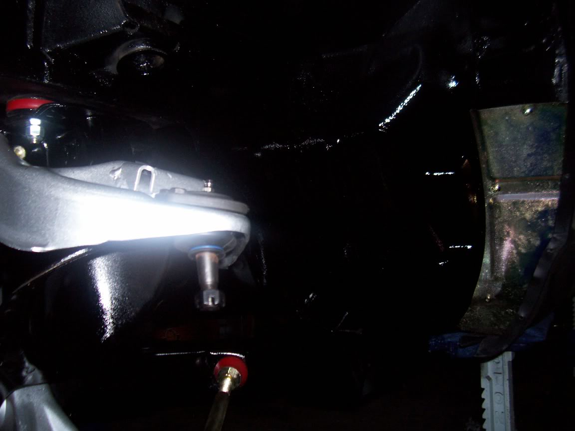

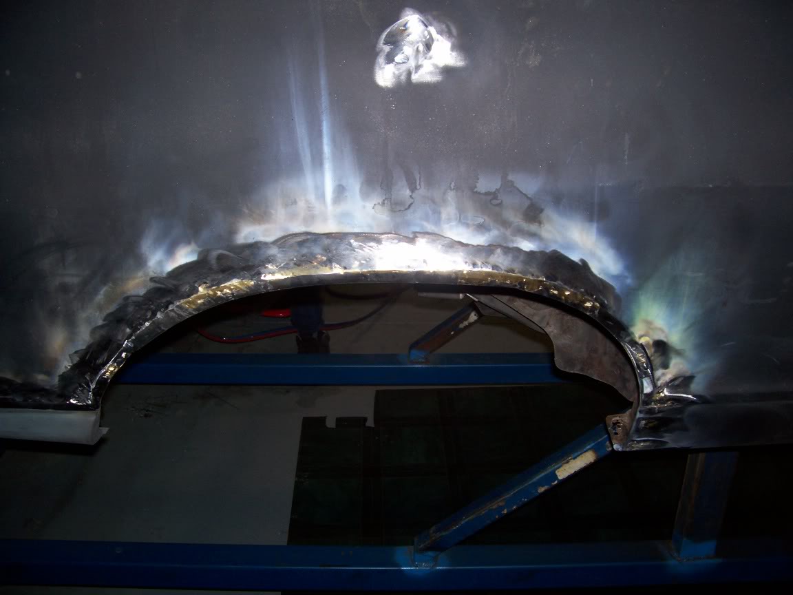

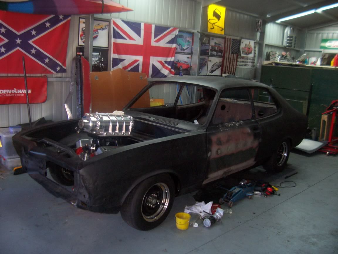

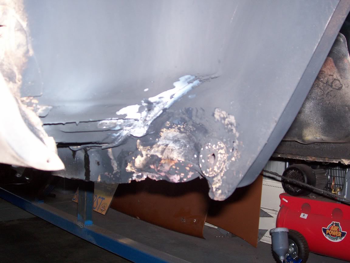

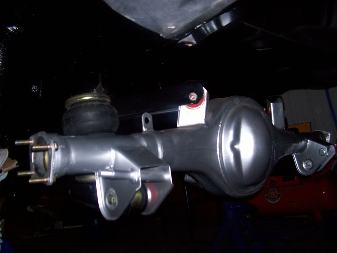

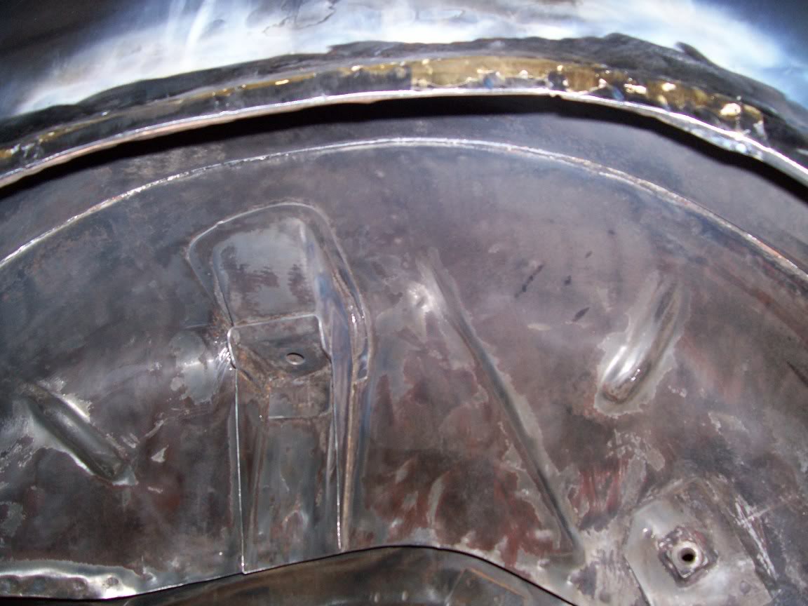

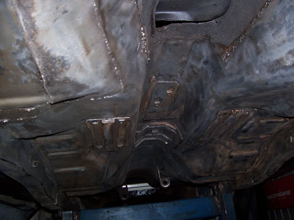

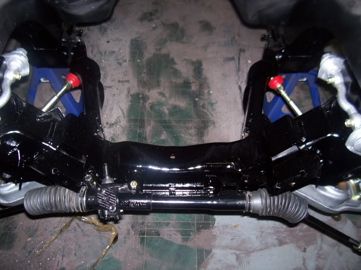

Hi Guys, it has been a while since I have written, so here goes:
- The underbody is done (bare metaled and 2 pac'd in jet black).
- Stone guarded under arches and sides of chassis (after it was bare metaled).
- Stone guarded areas have been etched and 2 pac'd over.
- Steering has been mounted up and realocated.
- Front end has been bare metaled, 2 pac'd and assembled.
- Suspension is now all air bags (each corner).
- Rear diff has been installed.
- New rivets have been rivetted on the panels for chrome strips.

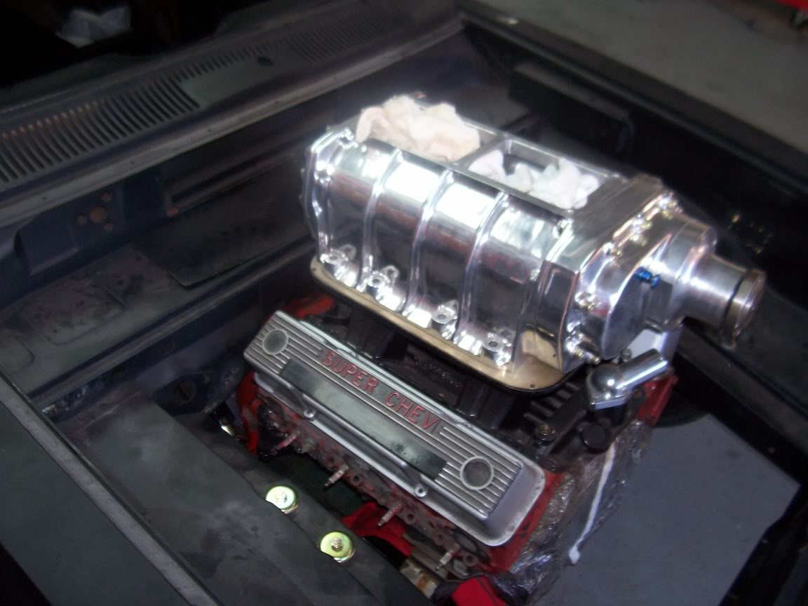

- 383 four bolt has been mock fitted with transmission.
- Chassis kit has been installed and sprayed in 2 pac.
Now I'm waiting for my painter to get his place ready, so I can drop it off.
Hope you guys enjoy the pics.

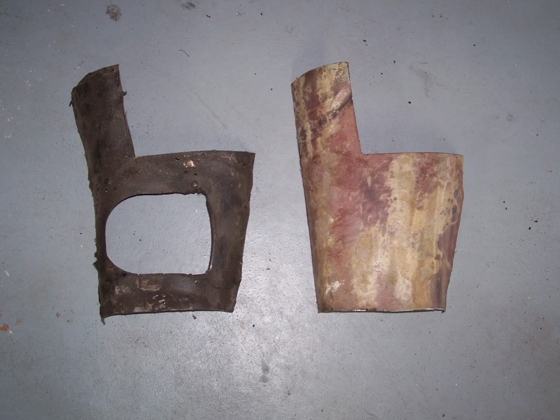

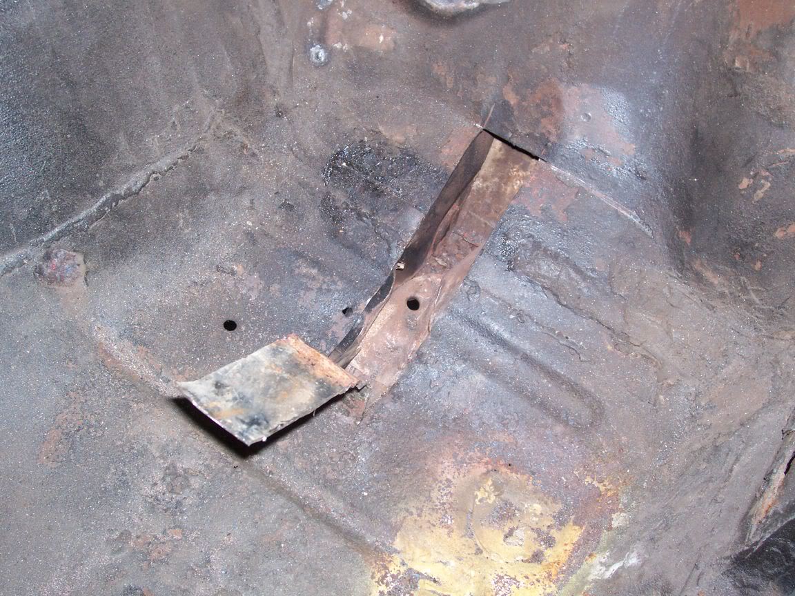

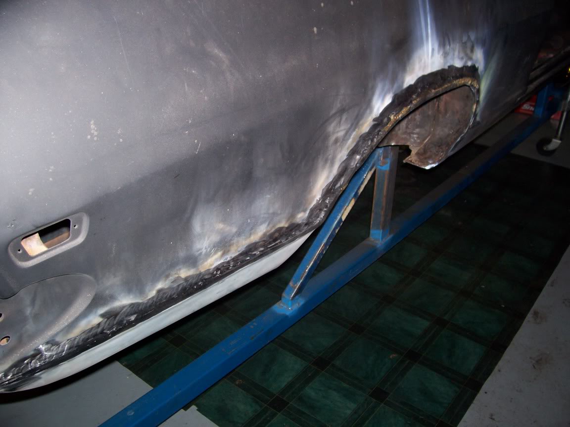

Here are the pics, they are in order from what has been going on for the last four months, hope you guys like it.

And heres a video, but without the blower on:

Wow, never seen airbags on an LC/J before! Top work. If you don't mind me asking, how much did it cost for the paint - underside/stoneguarding?

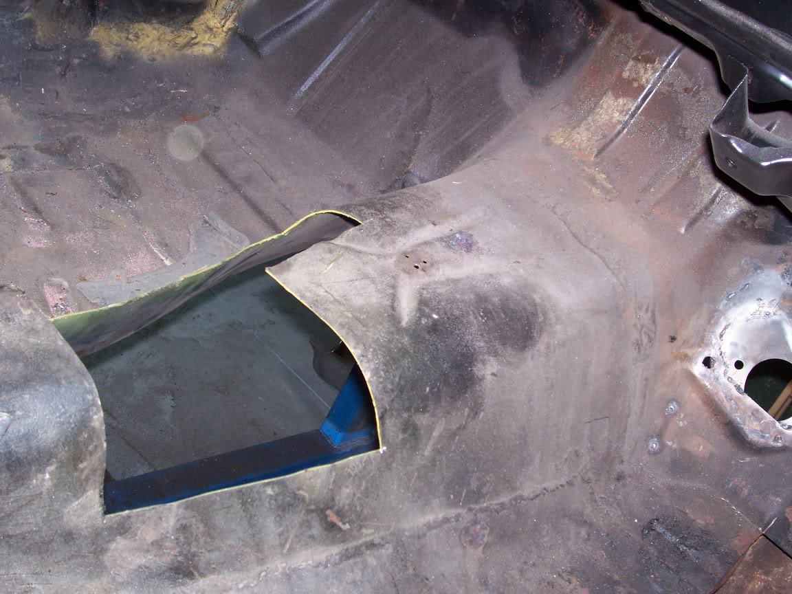

Well I did it my self so it was pretty cheap, stoneguarding, the 2 pac and the etch came to $96.00 It was well worth thew prep time. I had to not only cut out the tunnel and replace it, but someone welded in a floor panel for the drivers side over the rusty one, so I had to cut and weld that all good, as well as fix the bent chassis and all the other dents, all up it took 15 hours to fix and finish the underneath, but anyone elses would prob take half that time. Goodluck with doing it. The end result is really worth it. :spoton: :spoton: :spoton: :spoton: :spoton: :spoton: :spoton: :spoton:

Man yur car is coming along nicely. Does having airbags have any pros over a good coilover/spring/shock set up? Or is it sorta just for show and comfortable straight line work.

hi jbird, the bags are only going to be for cruising and shows as it isn't for handling, so I'll be selling it as a complete unit after its been to all of the shows. A gun is needed. I didn't use a rotisserie. I made a frame, which is for sale, it cost me $500.00 to make and has a jockey wheel on each corner. It bolts to the chassis and gave me plenty of room. My friend is using it at the moment on his 308 ra28 celica project. Take care, Adam. :rockon:

if you dont mind how much did the airbags cost all up im interested in getting the monaro done. do cars with air bags handle okay or do they body roll worse then a dingy in a choppyy sea
#16 _adamlcgtr383blownchev_
Posted 17 August 2006 - 10:54 AM
Torrietree they handle like crap!, hopefully a bit better when the motor and trim are in on the final fitment, but from what I've been told it handles not too great. When I get serious (after the motor is run in), I will prob take them out and run coil ovbers, then possibly tub the rear, but don't thuink I will, genuine GTR, at least I can rip the v8 out and put a six back in and nothing is different. But yeah its a honeydoodle. :spoton:

Does it require structural to fit airbags?
#18 _adamlcgtr383blownchev_
Posted 18 August 2006 - 01:40 AM
Yes it does, but if you do it right you can adapt them so that they can be unbolted and the other springs can be put back in their place. Thats what I have done. Take care, Adam. :rockon:

Its good to see someone putting 'bags under their torrie, it was something I was highly contemplating, but since I am quite keen on the drag strip (hence the handling) I have decided to stick with shocks on my project :) Besides, I was told by a few ppl that if I used bags, when the car bogs down hard as it takes off - there would be a good chance that I would damage them and maybe even pop them..

The bags take 700kg each so thats nearly 3 ton worth of weight, meaning they wont pop at all. Take care, Adam.

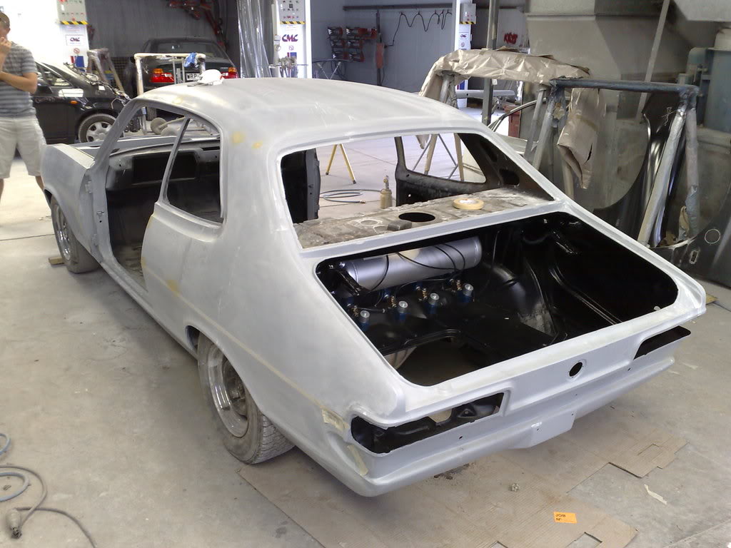

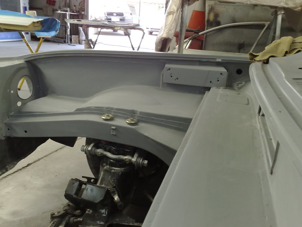

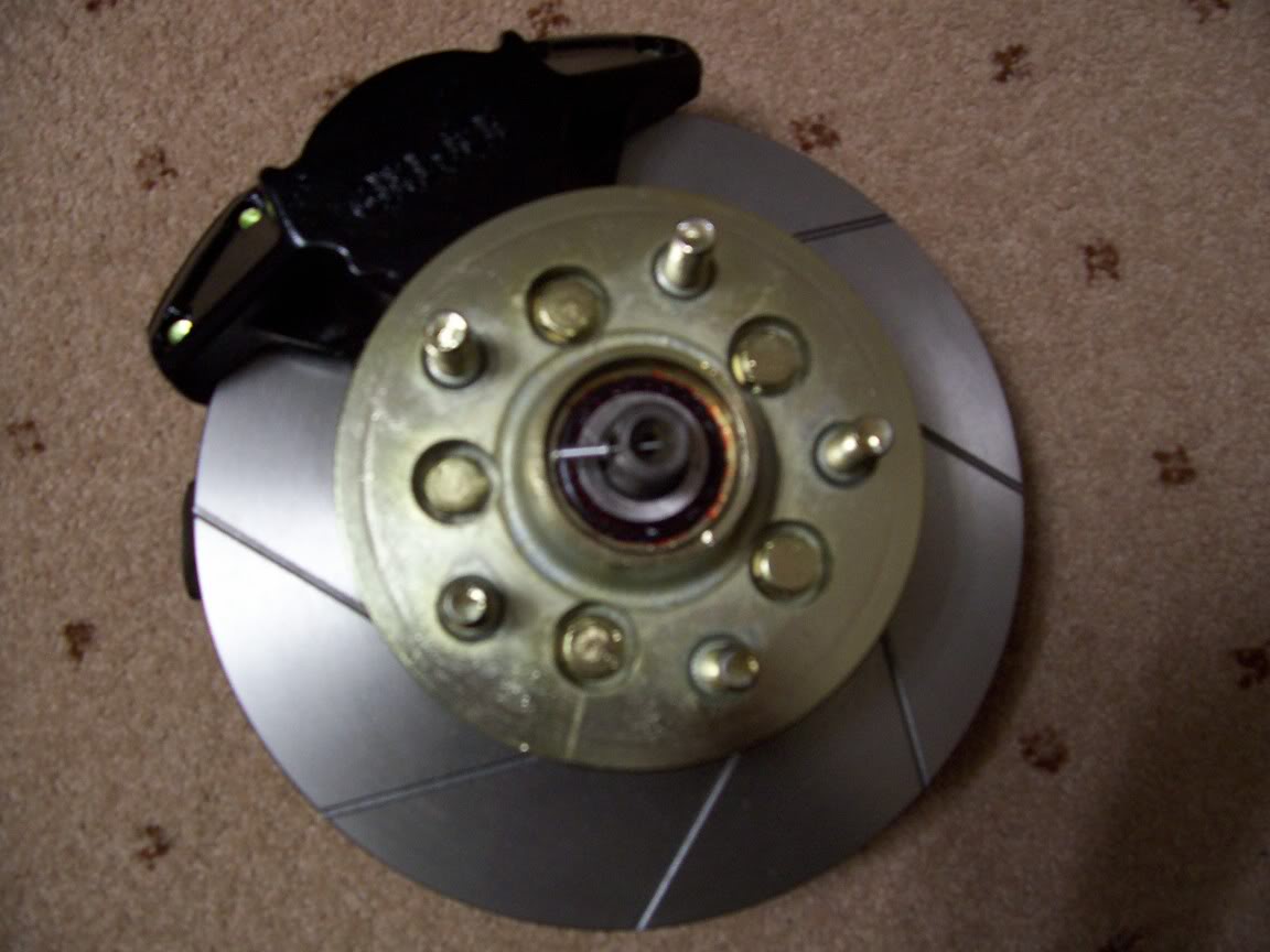

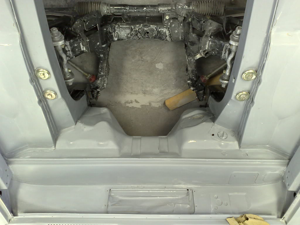

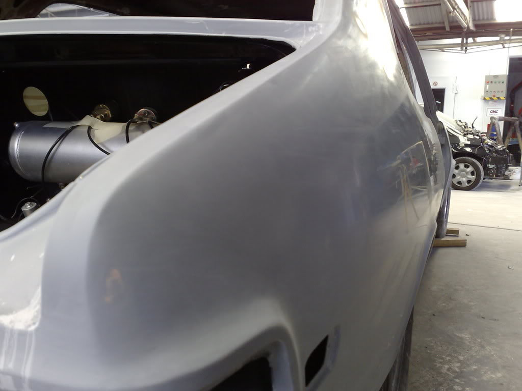

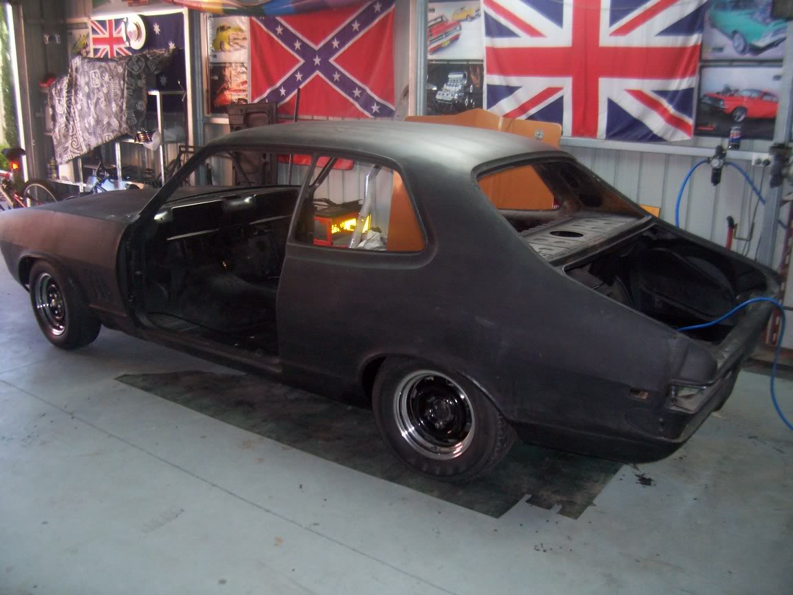

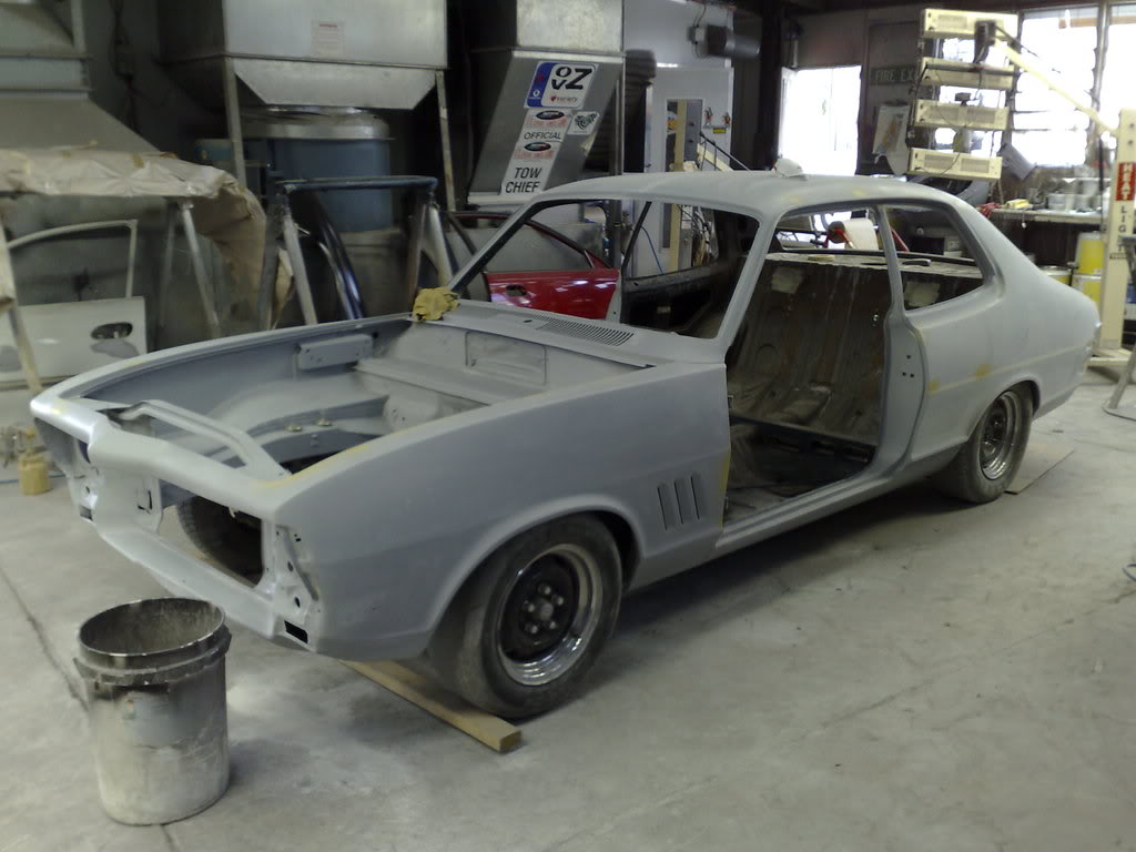

Well it has been awhile since I have worked on the gtr, but I am finally getting it back from the paint shop (after 14 months). I have to decide on which billet wheels I want. Here's some pics of the car in the body shop today
I will get the car back in three weeks. Slowly put it together throughout the year. Wondering what type of block to start the motor build with? I was thinking LS series.
