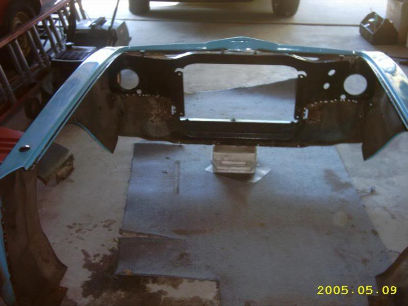

When I first got my LJ, it looked like this -
Obviously, I needed to address the issue of the damaged front panels. I found another shell to take the panels' off, to swap them over.

This is what the finished product should look like!
I only had to take the passenger guard and the top half of the nosecone off. If you need to do any more, its just a case of finiding the spot welds and drilling them out, really.

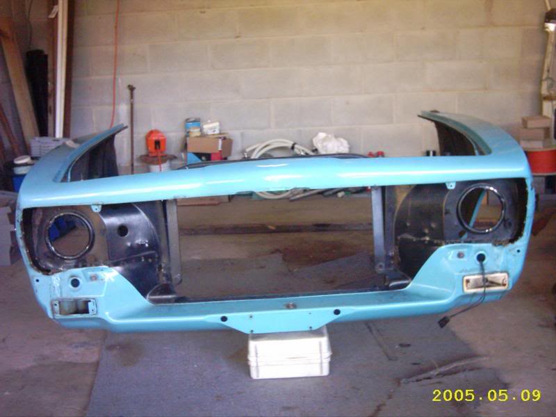

I got the front end off of my other LJ off this morning. I did exactly the same as I did for the first one, but got more pics.
This is where I cut the guard around where the headlight surround covers.
This is the back of the guard, where it is welded to the A pillar.
and this is what I have now!

i did the same to a 4dr lc
https://cache.gmh-to...sidefrntend.jpg
https://cache.gmh-to...frontendoff.jpg
like rim-010 says it is an annoying task but if you take your time and do it neatly there is stuff all work left to fit it back on.
