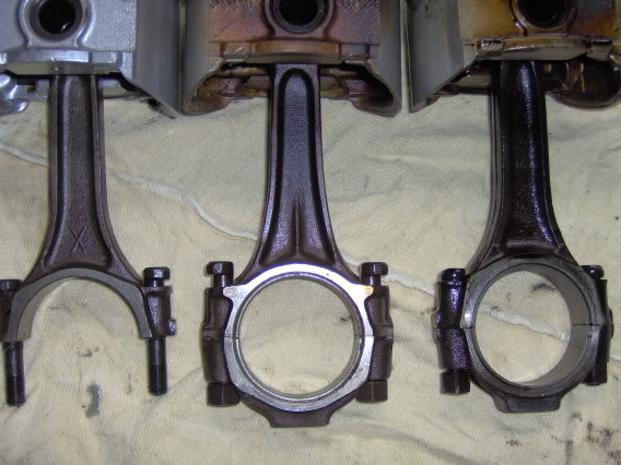

like these
one on the left is a L34 or "X" rod,centre is an A9L and the stock one is on the end
A9L's also have larger rod bolts
