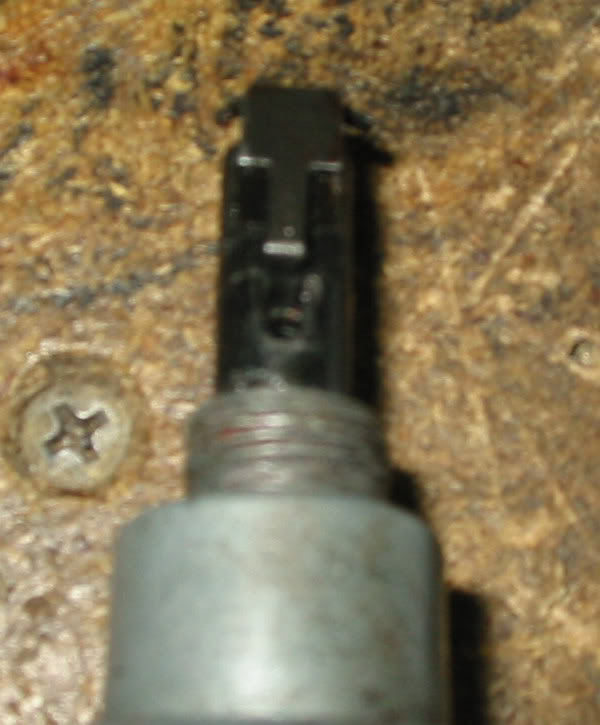

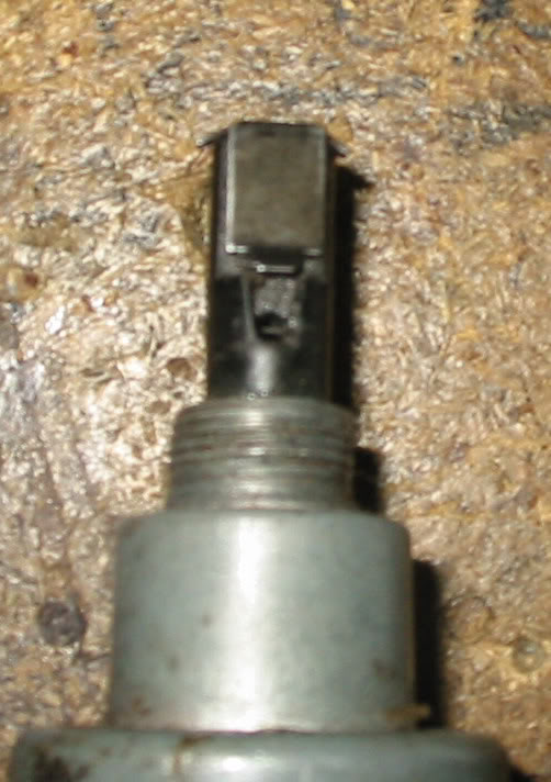

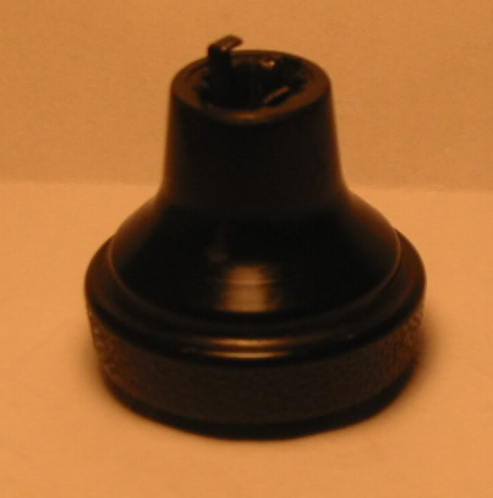

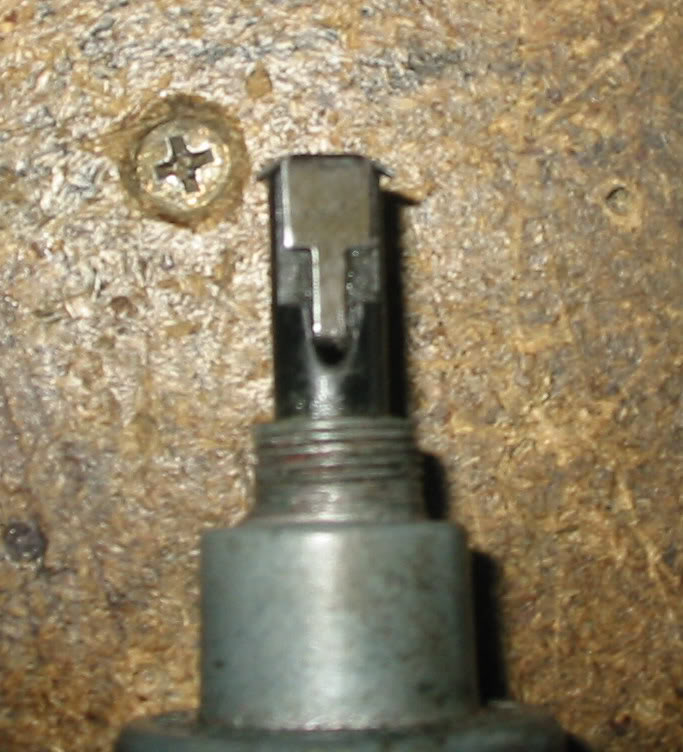

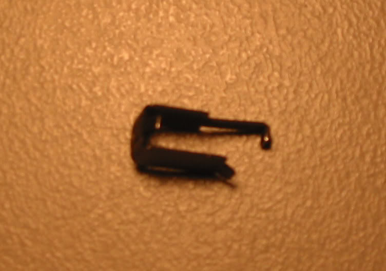

Knob with clip in.
Clip out on shaft, top view.
Clip out on shaft bottom view.
Clip on and fitted in position.
The clip
I measured the hole in the shaft at about 1.75mm.
Push the pin up from underneith.
Like i said i hadn't done this before, so now having investigated it, it is easy but the method is important.
Sorry for the focus, bloody hard to take small photo's so close to get the detail.
Paul
P.S. the hole is not in the knob, it's behind it.
