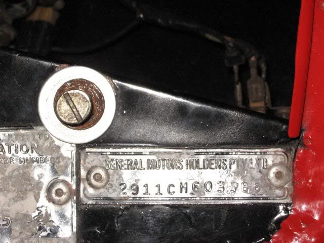

Can anyone give me any information on a LC Torana with this VIN Number? 82911CH603988
Would like to know if it is a GTR or XU-1, Build date etc

Production date is 20-10-69, dealer code 000, no sales date listed, i'd say GTR

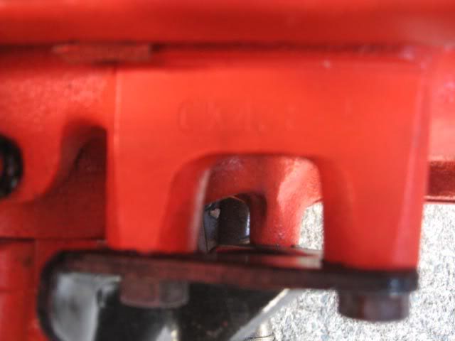

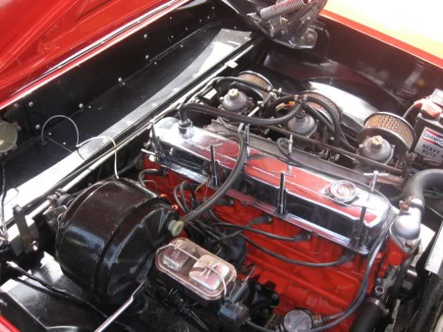

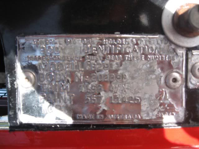

Went to see this car in the weekend.
Engine number ck43845 Does that engine belong in the car (ie factory fitted)
Body 20239B
Trim 1193
Haven't got much more than that

that vin no is 100% gtr only,as per info above,metsbac code 34203C0, but that ck eng would be very interesting. :D

According to the Holden records, this car is a GTR, not XU1. It was built on the 20-10-69. The engine that is in it at the moment is not the original engine. It was an export car but the records do not state when it was sold or by who.

Thanks for all the help guys, you guys might of saved me about 20k.
Even the engine might be a bit suspect, the head part number I got of this car is 7429461. "ck spec" engines had the head part number 2822072

The body number on the tag is 20239B and the number stamped into the lefthand side of the engine bay (near the air filters) is LC20239B

If this car was assembled in Sydney (H6)
Why does the body number indicate a Brisbane car? (20239B) isn't that what the B stands for?
#25 _nzgtrxu1_
_nzgtrxu1_
Posted 13 April 2007 - 07:47 PM
because Brisbane is the body manufacturing plant hence the B & sydney H6 was the vehicle assembly plant. thats all sweet & they are similar in number sequences to the undisturbed tags on my 4/70 gtr. They will be a matching pair of tags even if they have been rerivoted. however that stamped chassis no by carbs should be around LC07***B & would NOT be similar to the body # on the paint tag at all. if it had had an ADR tag it too would be LC07***B but most NZ toranas were not fitted with ADR as NZs primitive rego system didnt req this. ( & it cant be returned to & rereg in aust without )
