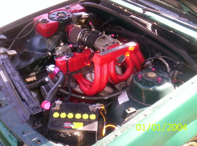

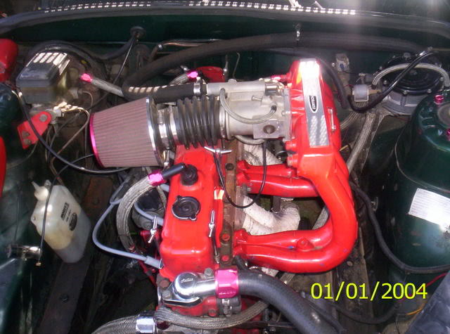

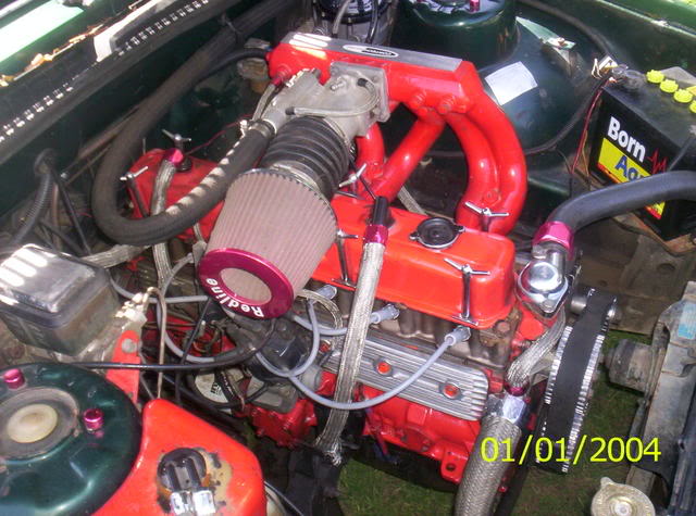

Heres a few picks of the motor I originaly bought for my hatch but I just ended up thrashing it around for a while and sold it
( is'nt that what ya do with commodores )
I'm not sure on the exact specs coz I did'nt build it but it was some thing like this
Red 202 block, 12 port alloy yella terra head, stage 3 heat seeker cam, Steel crank, genie extractors, VK injection, Gas reaserch throtle body, cold air intake,electronic ignition , gilmer drive belt and backed by a celica 5 speed and lsd.
I was gonna add a castlemain rod shop supercharger kit but I ended up going with a V8 insted. I'm spewin now coz the head alone was worth more than what I sold the car for.
But trust me THIS THING HAD NUTS. :D
Apparently 7K was spent on the drive line and gas system and was built by one of the HRT engineers. But who knows ?

Hmmm..steel crank? 202?
Alloy head? that head doesn't look like one to me...but you are right, they are worth a ton...mine cost $2300 new

Yeah like I said I don't know the exact specs of the motor this is just what the previous owner told me. but the bloke I sold it to has been offered 2 grand just for the head
