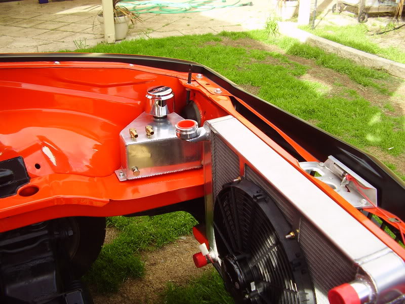

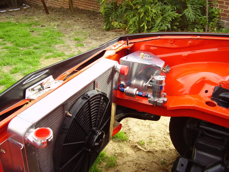

#24 A9X
Posted 18 August 2008 - 10:23 PM
I have a PWR in the hatch.
Very happy.
Welby
