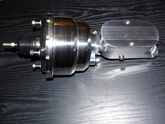

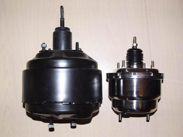

Will a 7" dual diaphragm booster give you enough clearance?
https://cache.gmh-to...tch/booster.jpg
https://cache.gmh-to...ster_master.jpg
that looks like it may do the trick, although i have to see if even the brake booster bracket will fit on the firewall, if it does (ill check tomorrow) it will do the trick.

#15 ls2lxhatch
Posted 11 October 2007 - 04:04 PM
You can buy the chrome and paintable Hotrod 7" dual diaphragm boosters from Dattoman or anyone into Hotrod brakes eg. Hopper Stoppers. The booster takes a GM pattern master cylinder so you can use your exising master and prop valve. My booster is stainless steel, I have only seen them on eBAY. I bought mine from Parts4u4less but they do not have any listed at the moment.
7" Stainless Boosters on eBay
Booster fitting kit from Summit.
SUM-760125
Alloy check valve from Summit.
SUM-G1467
SSBC Billet Aluminium master cylinder from Summit. It has outlets on both sides. I intend to run the lines on the RHS of the master.
SSB-A0468-2
I did buy the SSBC adjustable proportioning valve SSB-A0730 but found it did not have a brake fail indicator switch (ADR 31) so I returned it and bought a Classic Performance 4WD proportioning valve and wiring connector from Summit.
CLP-PV-4 ( This part number is just the prop valve without wiring, brakets or pipes )
CLP-SP015130
SSBC will have an adjustable proportioning valve with brake fail indicator available early 2008.
Edited by ls2lxhatch, 11 October 2007 - 04:06 PM.

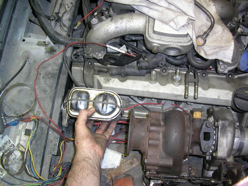

Posted 12 October 2007 - 07:22 PM
okydoky
As shown in the pics above there isnt much room to play with. Further discussion with Terry at Hydroboost, he recomended using a master cylinder from a Ford which is a high fill, ie a little more compact unit to clear the turbo exhaust pipe or use a master with a remote reservoir.
