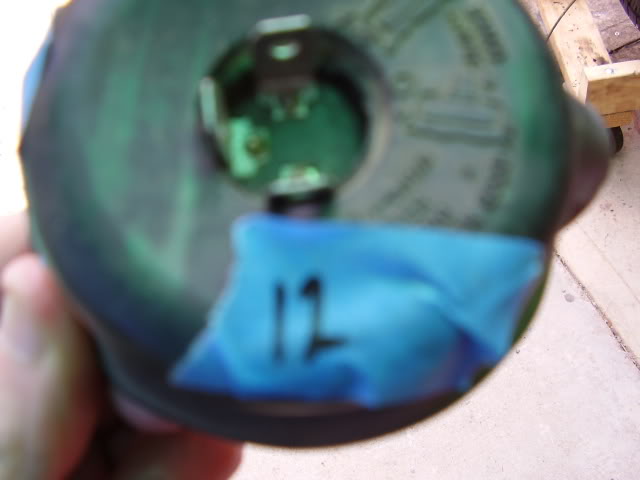

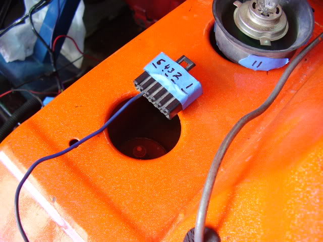

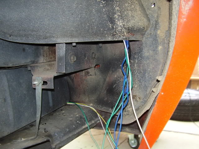

What we did here was to disconnect all the wires we could see in the engine bay (drivers side) As we unplugged them we numbered the wire and the part the number connected to with the same number eg this is a headlight connection number 12 and the corresponding wire was also marked #12
This process was repeated over every wire we disconnected
Once the wires were all individually disconnected and respectively numbered Jeremy then unplugged the harness from inside the car on the drivers side, to do this he reached up under the dash.
Where things were hard wired like the electric fans we cut them and when we replace the wires which we had already labelled they will be reconnected with plugs to enable easy removal should anything need to be worked on in the future.

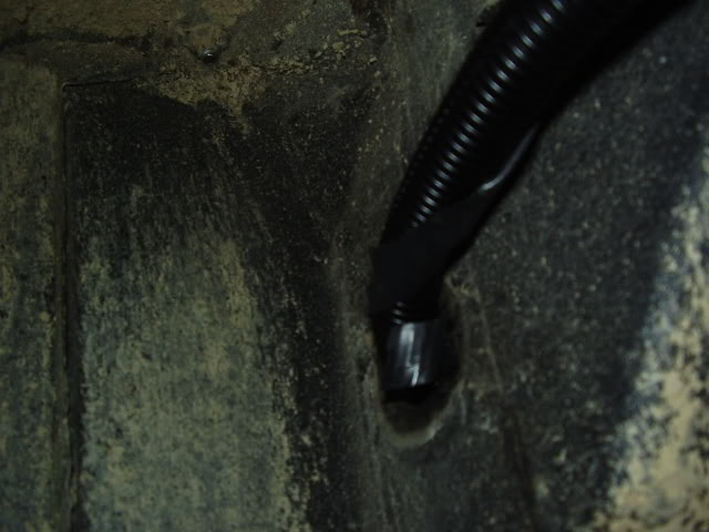

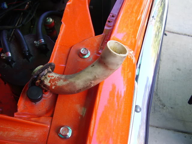

When the harness was unplugged Jeremy removed this pipe - again from inside the car under the dash and run theharness through the hole which comes out under the guard.
This pipe will be replaced but sealed off and any excess water will hopefully transfer to the similar pipe on the passengers side of the car where it will freely run out.

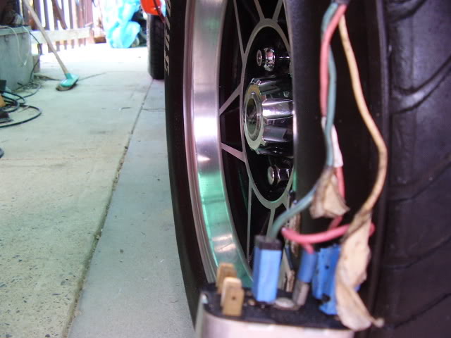

We have yet to finish the job off as we are replacing much of the old headlight wiring which quite frankly was a real mess with wires being cut and rejoined in many places.

im interested to know how it will work with that pipe being blocked off. what you should be careful of is that it doesnt end up being a water trap, where water sits and cant go anywhere... would hate for it to start rusting out that way! :spoton:

I too am wary of that pipe being blocked off. It is my only concern and I will be watching it closely. If need be I will reconnect and extend the pipe thus drilling a new hole for it.
I am told the water runs out the other side with no troubles at all but time will tell! I certainly do not want any water traps that can be avoided, Torana's rust away willingly by themselves and certainly don't need a helping hand lol.

I to have been thinking after reading I think if we get that stopper and run a smaller tube herne in the same hole we will buypass any water siting there
I just dont like to drill holes as these cars twist and need all the metal thay have
I will make this on sunday and get herne to take photos of this before putting it in the car

why cant you just drill another hole next to it and put a glad/grommet in there
save mucking around and wont mess with any water run off

Problem has been solved, I gave Jeremy the part required today and he has manufactured a fix. More on this and photo's by the end of this weekend.
We decided not to drill yet another hole :)

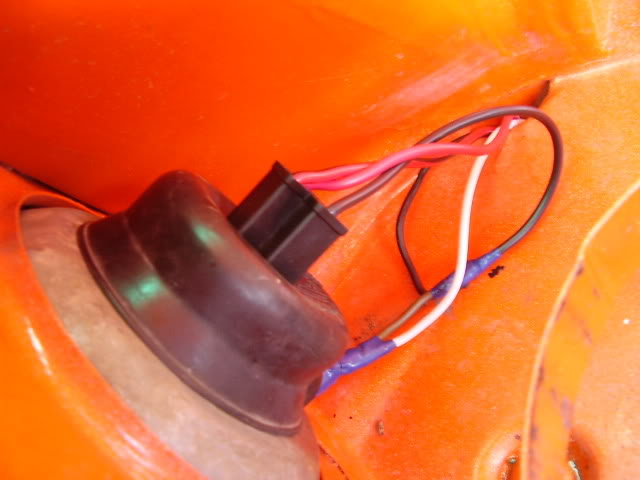

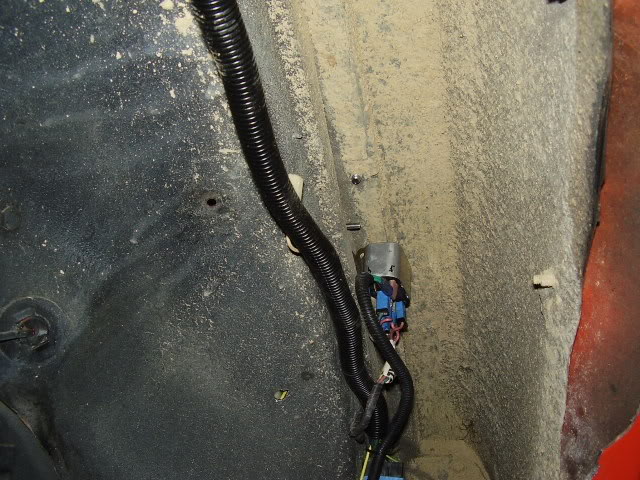

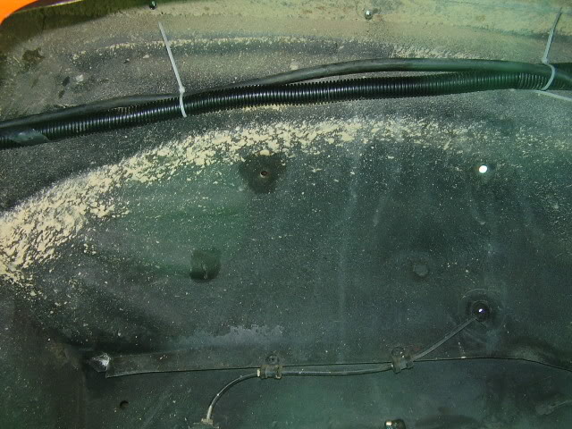

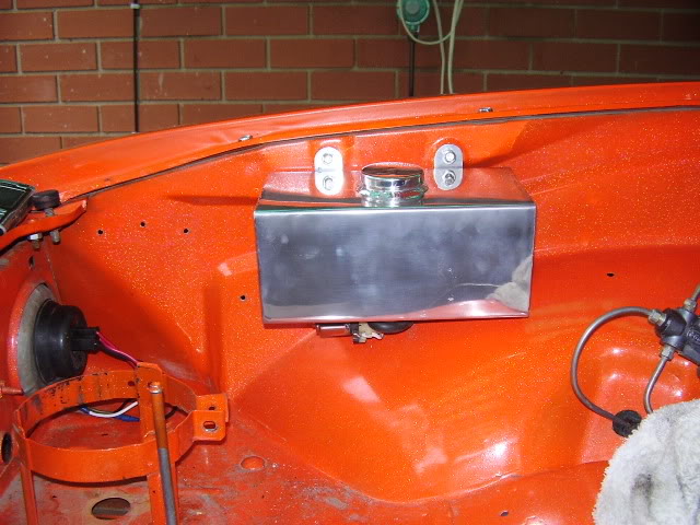

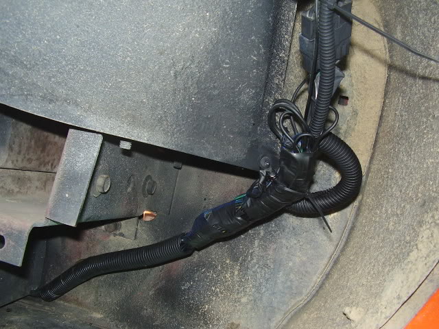

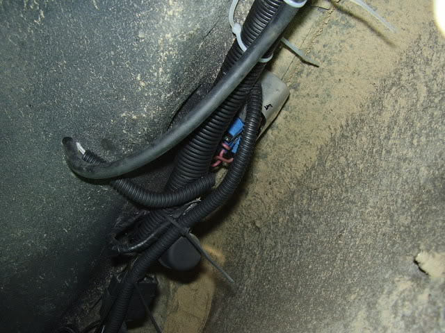

The wiring where it enters the underneath of the mudguard:
Advancing along the mudguard towards the headlight and behind the water bottle for the wipers. I need to remove the wheels and give all 4 wheel arches a good scrub:

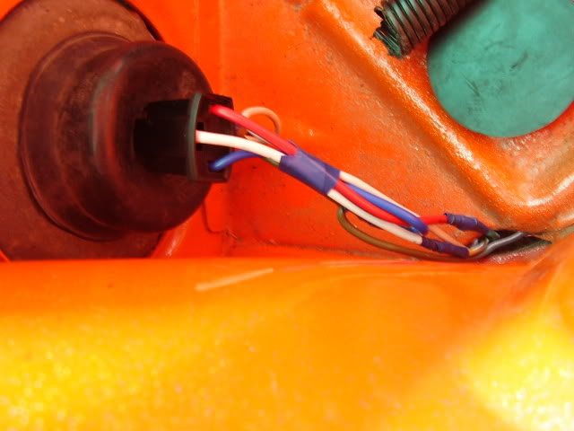

Engine bay before tidying up, note new headlight connector plug which replaces the old individual push on connections.
Battery side of engine bay not completed:

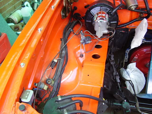

Battery side after tidying:
Drivers side after tidying:

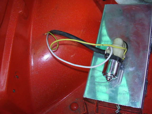

Water bottle plumbing and wiring:

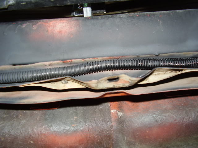

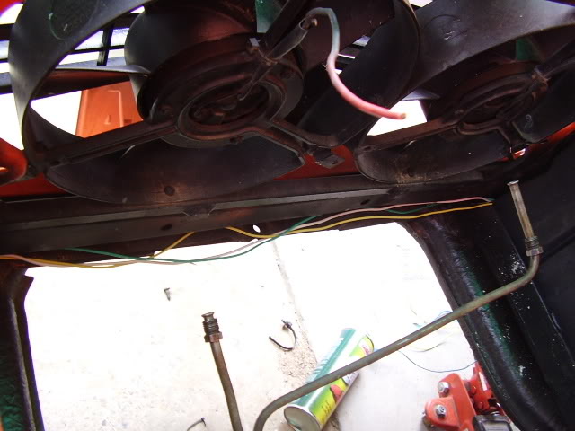

Wiring being hidden along lower radiator support panel:
Wiring finalised along rad support panel which will be further hidden when the radiator is fitted:

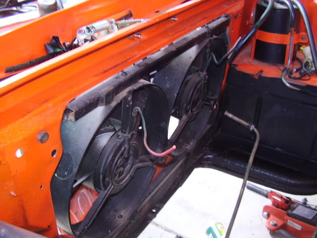

These are the headlight and horn wires we ran from passengers side to drivers side

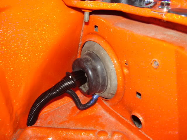

The first remodelled water vent, still not fitted and we are about to have a go at a second version of this:

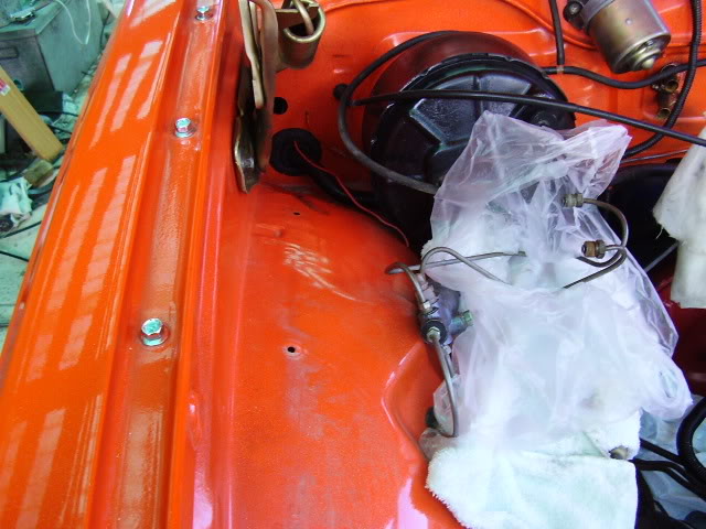

I just finished hiding the wiring in mine just yesterday. Mine wasn't as elaborate as Hernes' - i just snuck it under the brake booster as it came out of the original firewall spot, then down and around under the chassis rail where I just zip tied it to the fuel line, then all the way along to the front then up again underneath the radiator over flow bottle where it branched out to the lights. Very simple but effective. I'll take photos tonight.

As said, my little scheme wasn't as elaborate as Herne's but it seems to have come up ok. All I did was go out of the firewall, under the booster, down to the fuel lines, then back up again underneath the radiator over flow, then out to the respected outputs. I had to solder in about another 20-30cm of extended wires to make it fit. Sorry about the blurry, crappy photos - lets say my brother is a good actor, but not a photographer...
You see the wiring running zip tied to the fuel line. I might replace the tacky looking yellow insulation tape with a bit of black heat shrink to make it a little tidier and not so conspicuous.
Lastly, the end result - you can't really see in this light but the wires just sneak up behind my ...world war 2 type looking radiator flow bottle.
