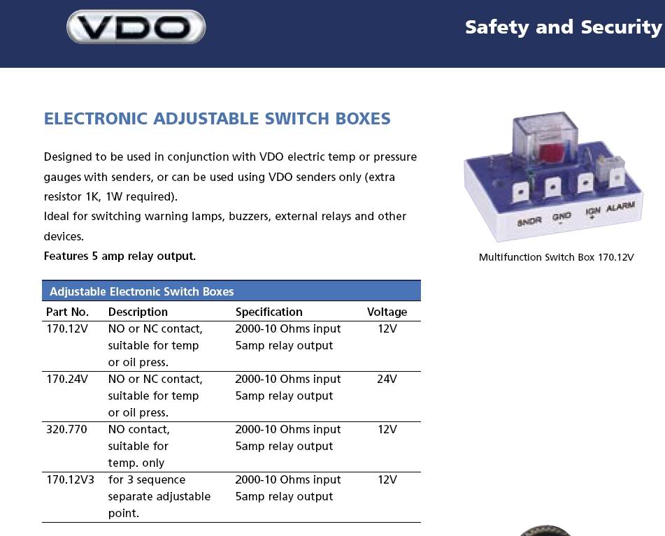

Posted 25 February 2006 - 10:48 AM
Here is another option from VDO:
i have no idea on the cost of these though.
#21 _tj81_
_tj81_
Posted 25 February 2006 - 11:37 AM
Interesting gizmo that !!
Might ring the brother and see if repco stockem, and how much...then see ow much trade price to the old man...
