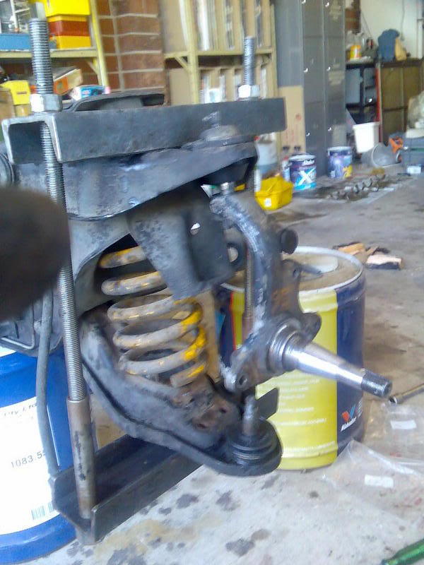

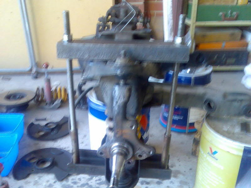

just adding these pics for future reference.
searched the site but no pics of this homemade job, which was described somewhere
i used 500mm of M10 threaded rod from bunings, 2x washers and nuts. plus the bar with hole in the centre.
cut the end off the old shock and had it welded to the end of the threaded rod.
worked great
in use
Edited by SnotGobbler, 09 January 2009 - 06:03 PM.
