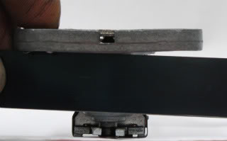

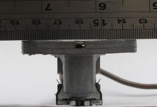

OK, the service was done at Eltham Automatics (BBE Auto P/L)
The culprit
The problem
The body is warped and gets worse when heated, the fluid starts to pass and down shifts.
Turns out the owner has an LX Torrie sedan that he's building, so i invited him to the site and mentioned the prefered supplier forum, to which he said he would have a look?
