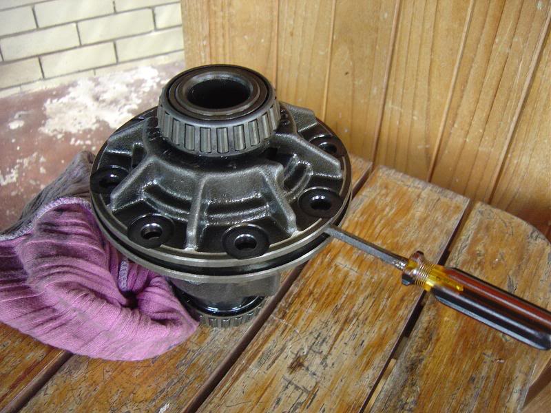

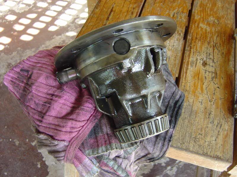

The bare carrier...to get the crown wheel off remember it has left hand bolts...big L on them.
There are 3 pins holding the 2 halves together...punch them out being aware that there are only 3 holes that go all the way through on the bottom half but there are 4 holes on the top half so mark the halves so it goes back together the same way.
Prise the 2 halves apart.

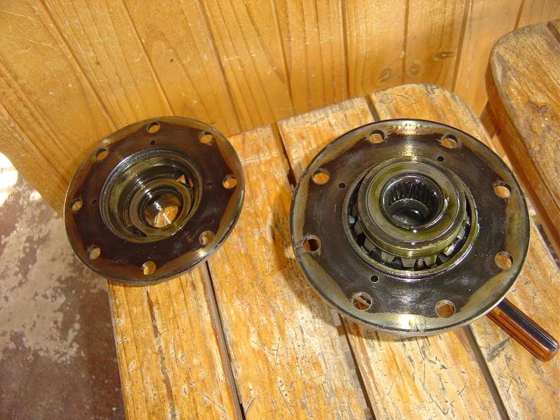

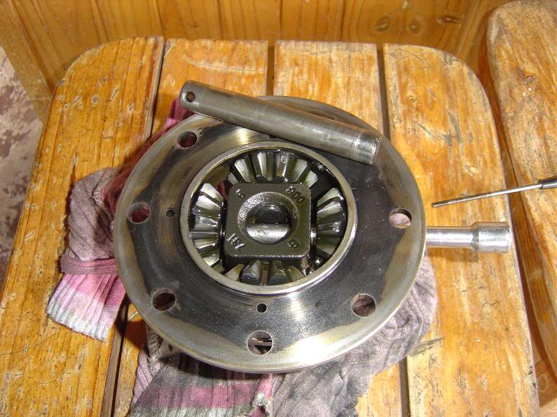

This is what you see..

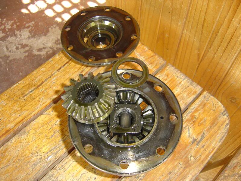

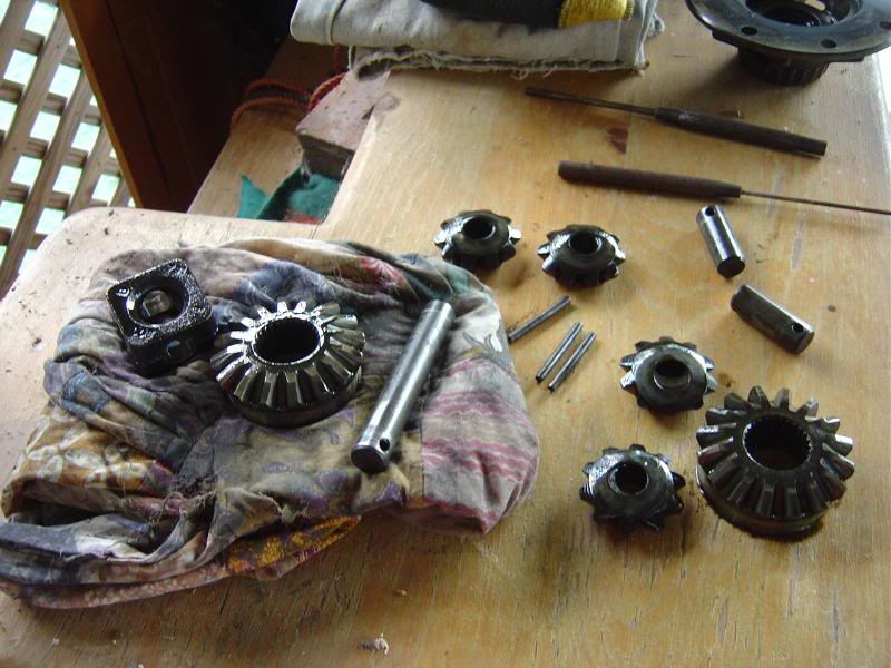

Lift out the top spider gears...making sure you also get the thrust washers from inside...these are vital and must go back in with the Lokka.

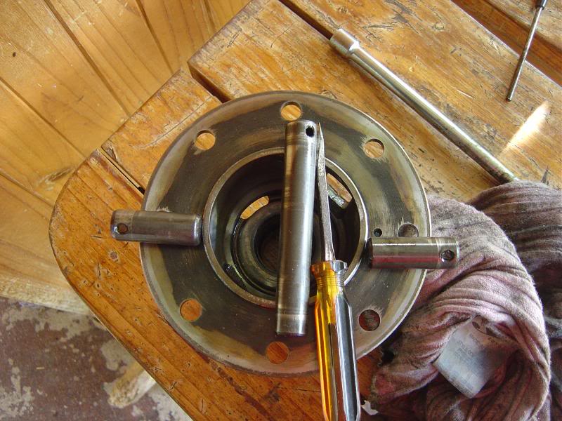

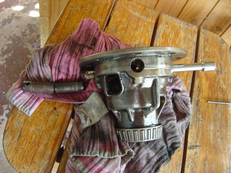

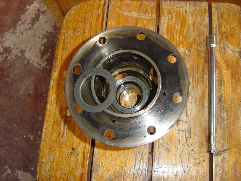

Next..knock out the long centre pin right through from one side...same with the half pins...knock one through to the other then out that side.
This is what comes out...there are flat thin washers that stick to the inside of the carrier at the ends of the spider gears..makes sure you have the 4 out. Clean the inside of the carrier with a clean cloth.
Clean, gease and replace thrust washers in carrier.
Get new centre pin and old half pins ready.

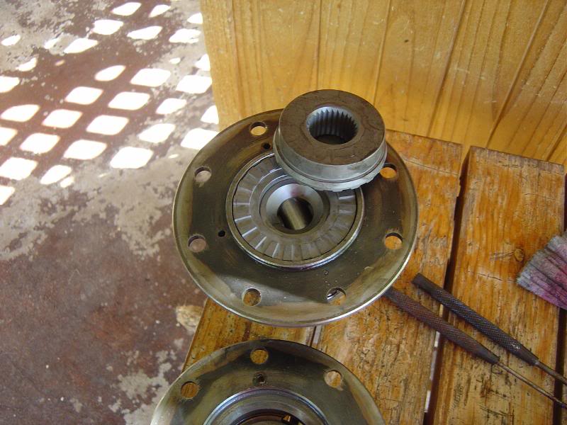

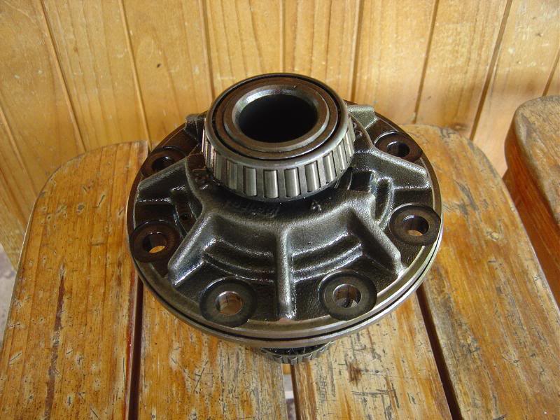

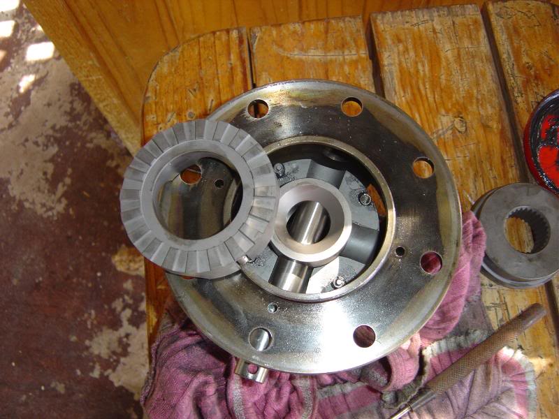

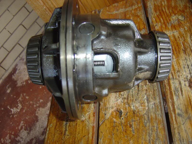

Install bottom half of Lokka as per instructions...fit centre pin and line up for the joiner pins to go through the end hole.
Fit rest of Lokka as per instructions and 2 short pins also lining them up for pins..

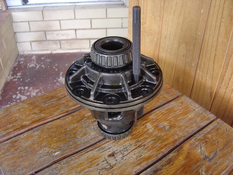

Fit thrust washer to other half...tap together..all the time lining up pin holes to hold 3 centre pins in place..Tap home pins..Bingo!..Finished! Fit crown wheel..remembering the bolts are left hand thread. The measured gap between the 2 Lokka halves should be 4mm...but it is a bitch to measure.

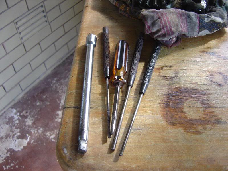

You will need these punches.

What sizes are those punches?

about 4mm, 6mm and 8mm.roughly. Supercheap stuff...they come in a set.
