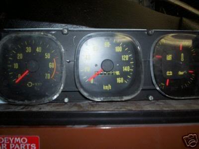

Ok so yellow we think, well that's all good but do we know why some have red needles and some have yellow or orange. Are they for different models or has someone painted them? Cause sometimes the needles can vary big time?
Eg.

The second set has been made up from a speedo from a SL. All of the needles have been painted in an attempt to make the whole cluster match.
#8 ls2lxhatch
Posted 07 April 2008 - 01:24 PM
You can tell it is an SL speedo because it only goes up to 160 km/h. The SS/SLR speedo is 200 km/h

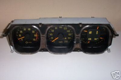

This one has a red needle on the centre gauge, is that factory do you think or it's been mucked with?It's on ebay at the moment...
Posted Imageith?

The red needle in the middle has definitely been 'mucked with'
The needles on a particular cluster should all be the same colour, and have the same level of fading- given that they have been exposed to the same level of light over the years.

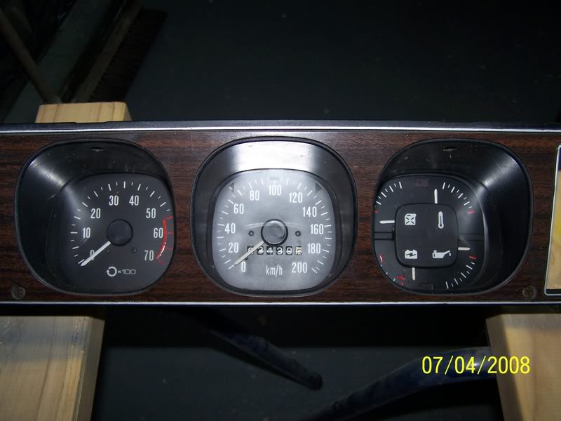

There are basically 5 sets of SLR gauges, I decided to go and take some pics of the 3 different sets I have. All are in very good condition so you can get an idea of what they should look like.
first up, LH. There are 3 different types of LH I have seen, the first has miles and KM, the second is as pictured, and the 3rd has 7 digits in the odometer while this one has 6

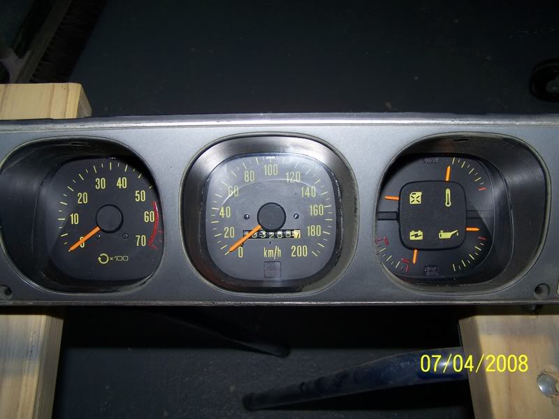

The next is the early LX SLR type

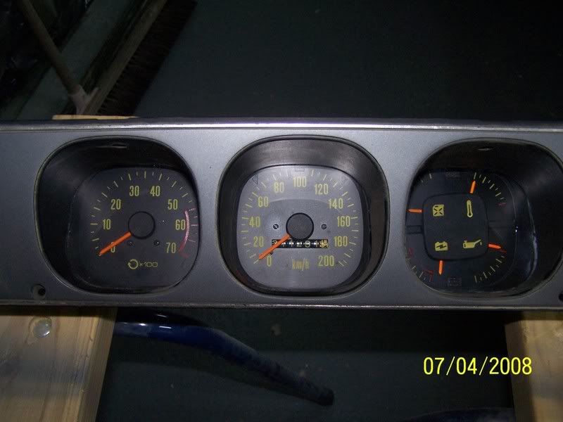

Late LX type. These appeared in around mid 77 and have the park brake in the bottom of the speedo as you can see.
