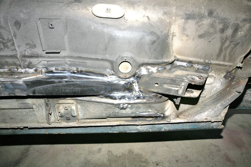

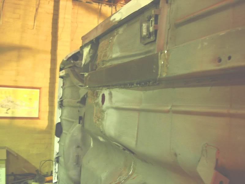

Hey fella's,
Ive been thinking of ways to strenghten up the chassis of my hatch, Im putting in an injected 6.3L so that means mountains of tourqe which means twisting chassis
I have thought of purchasing a chassis bolt on kit from castlemaine rod shop,
But also have seen a few forum members doing the chassis rail extension mod,
I just want to know if anyone knows the legallity's of this, It means chopping out some floor pan to fit the extension, would this be something that an engineer would need to do for it to be legal on the street, Because its not something you can just change back for roadworthy,
Heres a couple of pics i stole from 355LX.
Any information would be appreciated
Cheers :spoton:

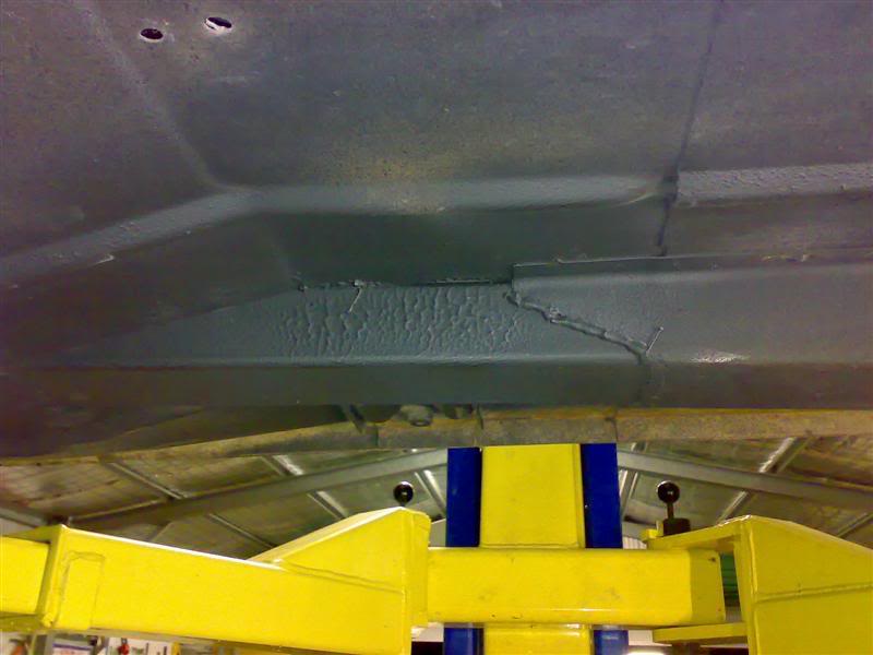

Thanks Squarepants, I profiled them to the floor so there is no intrusion into the cars cabin, when I stonguard and painted them they look factory but best off all the strength and handeling was improved out of site, I dont like CRS design heavy and still has flex. I am punching 513hp and just over 500ft pounds of torque on 10" sticky tyres and eaton L.S.D
Attached File  torana 048.JPG   1.56MB   158 downloads
Yeah that is the way I was planning on doing mine.
I may be wrong with this theory as I am not an engineer, but I think using the same method as factory will increase the twisting strength by using the floorpan as part of the structure. Cutting the floorpan and putting in a piece of RHS is relying more on just the RHS. I know this is still welded to the floor but the twisting location is now moved above the floor, rather than on the floor. Does that make sense ??

#24 ls2lxhatch
Posted 03 June 2010 - 11:04 AM
How does extending the chassis rail make the rest of the chassis rail stronger?
If the factory chassis rail is flexing and twisting throughout its length then I can not see how adding a bit on the end will do anything other than make the lower control arm mount stronger.
Following the floor instead of going through the floor makes the sides of the extension so low that it is almost a flat plate for most of its length.
