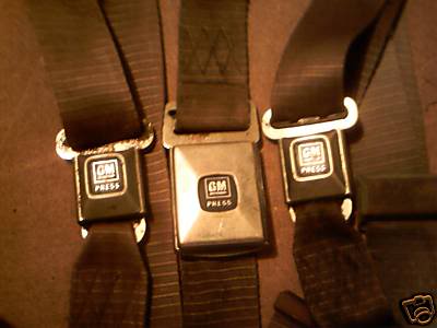

I own a 08/72 Adelaide built LJ XU-1, completed on the 04-08-1972. When i purchased my car it did not have the original seat belts in the front (Aftermarket Replacements) which is pretty common. However in the rear it still has which i believe to be its original seat belts, similar to those pictured below but with black webbing.
I will try in the near future to see if there is any dating on my rear seat belts.......
Does anyone else own a very original 6th, 7th, 8th or 9th month 1972 plated Adelaide built LJ Torana which still has its original belts intact ???
Your help would be much appreciated.......

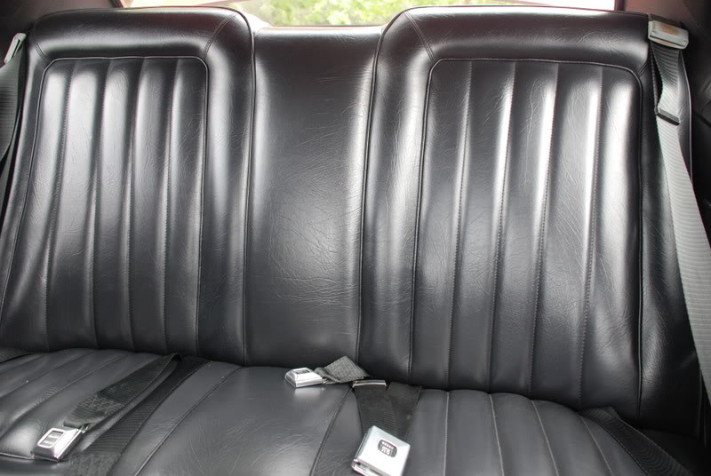

I don't know if this is any help but here is a friends original 6/73 Adelaide gtr rear belts

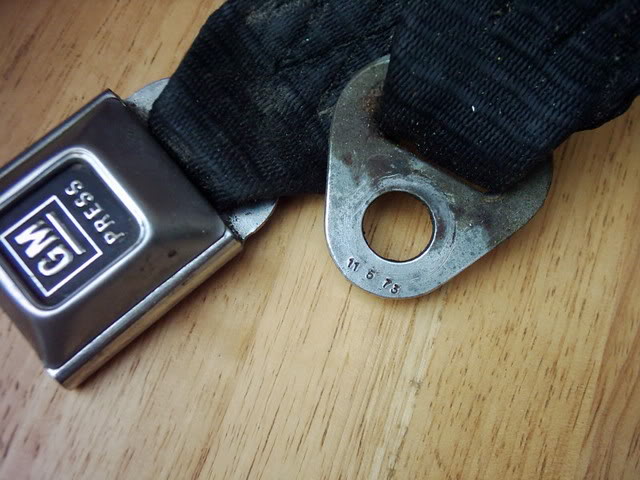

Thanks for your help Nitter, thats an awsome picture of 1973 Adelaide rear seat belts. Thanks JR, (wingnut) for your info. Thanks Bazza. I removed my rear seat belts on the weekend and checked the dates. I was sure they were the orginals but i was wrong. They were dated 11-5-73 and cant possibly be correct for a 08/72 car. Looks as though i now need a full set of the larger buckles for both front and rear to nicole...............
11-5-73
Thanks guys for your help :spoton:
Cheers B.

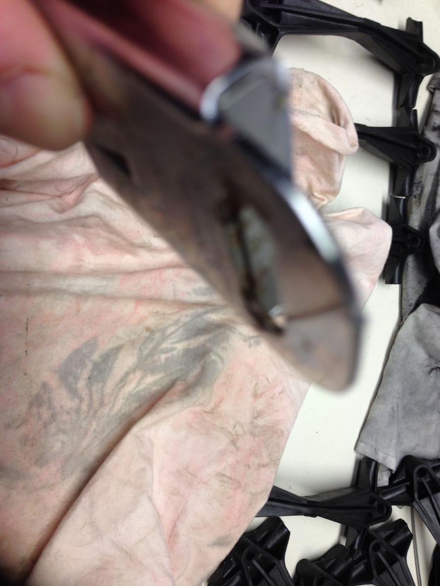

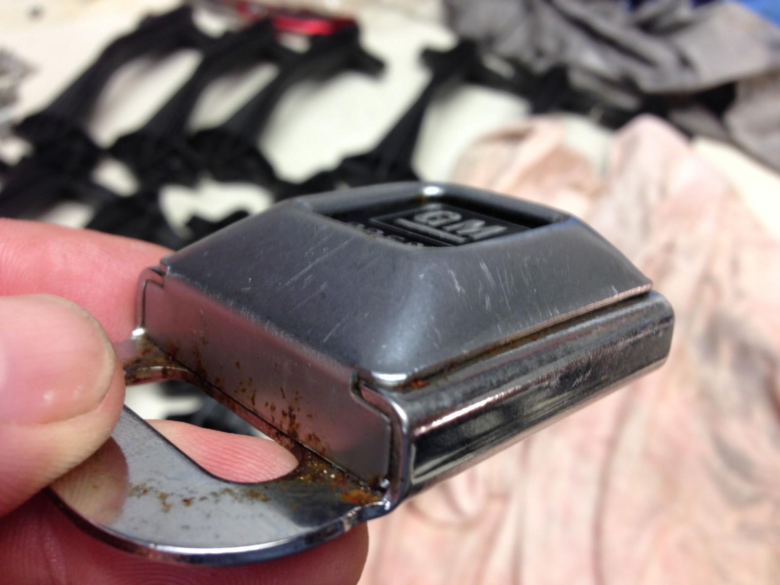

i have an early 73 Adelaide car and am about to start restoring the seat belts, does anybody know how
to get these little bastards apart?
Attached File  buckle1.jpg   239.48K   2 downloads
Attached File  buckle3.jpg   209.21K   1 downloads
Attached File  buckle4.jpg   118.99K   2 downloads
any ideas would be appreciated

In your last photo you can see where the top cover folds down with two little tabs at the sides, just get a flat head screwdriver etc and gently flex those tabs forward (without bending them) and then you should be able to remove the top cover.

just had a look, the cover actually returns into the area where the buckle goes about 10mm.

Brian, can you put up a pic of the opposite end to that in your last pic?

Appears the raised section of the buckle (contains the press button) may slide/press (with force) onto the base? Perhaps it comes apart by pressing the raised section back towards your thumb?  Your decision if you wish to chance destroying one.

thanks Dave, I did give it a tap today but maybe not hard enough. Try again tomorrow, this is a spare I picked up today at a swap meet along with those battery retainers.

Try to look inside the buckle to see if there is anything that would foul the raised section pressing off the base.

Try as I said earlier but from the other end, it's coming back to me more now I think.
