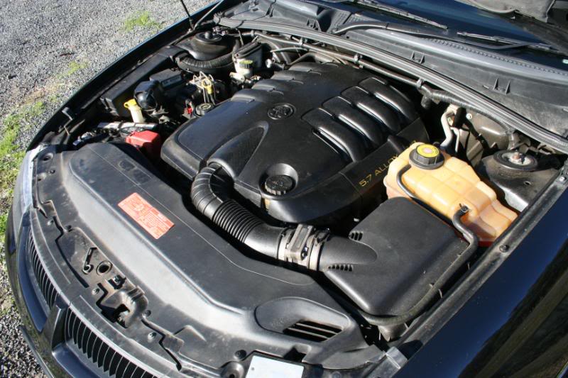

Ok, When i first got my ute, Fuel economy was at about 15.5L/100km's (Around town avg speed about 50-60km/h). I thought that was a little bit ridiculous.
Here is a boring plastic fantastic shot of the engine bay when i got it

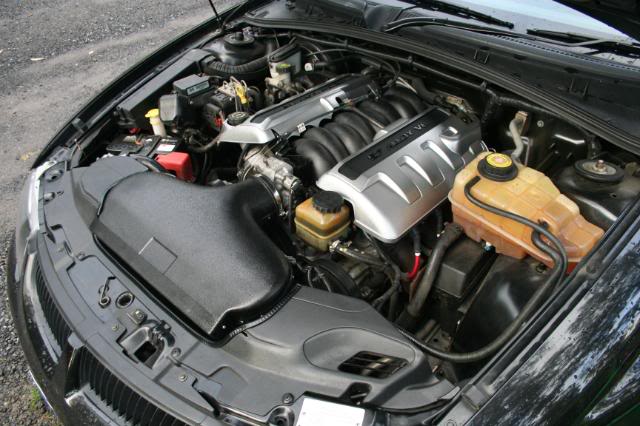

I bought some VZ twin monaro engine covers to make the engine bay presentable, They only cover the coil packs, so heat from the Inlet manifold can kind of escape.
I found that it also made my engine actually look like an engine! No more hiding things! HAHA

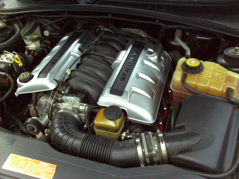

Here is how my engine bay looks now as well.
