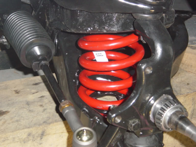

i JUST managed to fit standard length 330mm length pedders heavy duty springs to my front end.big deal u say,well it is cause the front end wasnt in the car.it was awfully hard and took a fair bit of trial and error.i had the front end ratch strapped to my truck floor with the whish bone hanging over the back.with a lot of prying, got the spring in and a transmision jack under the whish bone to jack it up.it just worked and we lived in fear of the spring jumping out and getting us.
question is, the upper whish bone bump stop,is squashed flat as a pizza,is there anything i can do besides fit the motor to balance it back

i had 2 sets of spring compressors.neither set,once compressed was able to be fitted in.there just wasnt room.we even cut the threaded bar so it was shorter.the spring compressors foul the lower controll arm and the cavity at the top of the k frame.i couldnt get the lower ball joint into the stub with compressors . has any one fitted springs in with compressors.bear in mind thet werent lowered springs.
and u cant put the shocks in till the spring is in.i dont have much experience pulling apart the front end completly like i did.its the second time i have removed a k frame and striped it.

That's awful advice from a suspension place. You can of course use spring compressors, but you need the right type, similar to this (goes up through the centre):

No more pics but the arms/bars/hooks/whatever go at the bottom in the lowest coil possible, and the threaded rod goes right up through the shock mount and you do it up from the top
