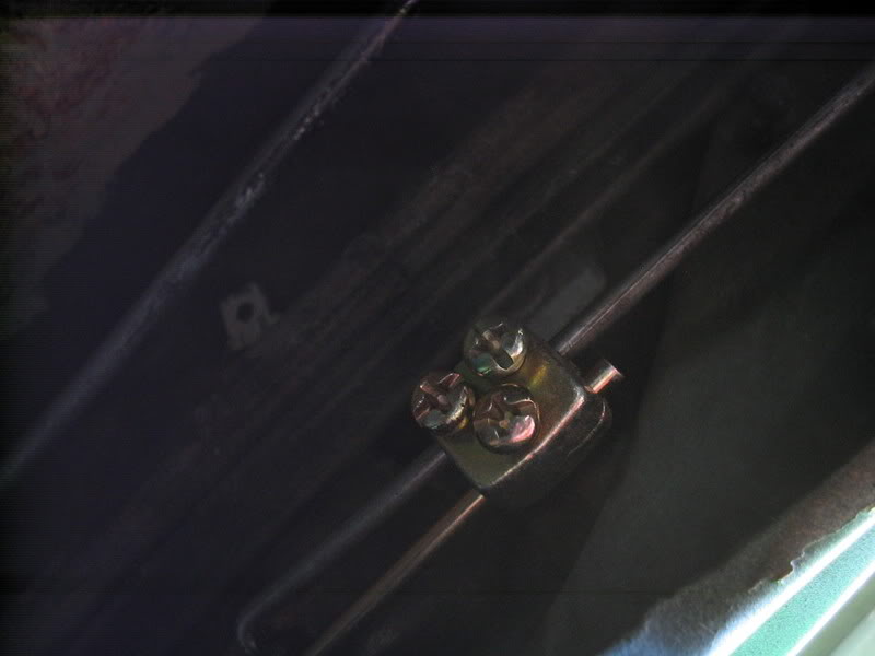

what this means is all the adjustment is now in the rod connector thingy
so do a trait fit, by putting the solenoid on the existing locking rod,
the one that does up to the top inside where you unlock and lock the door
the rod should have a little bit of a bend in it, so put the connector thing just above that
and do it all up, make sure the lock and the solenoid are in the same position (locked or unlocked)
so the solenoid should just dangle down the bottom

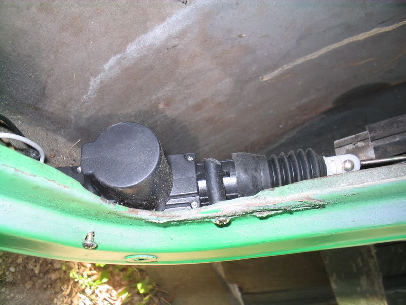

now this is about where you want to bolt it in
because this is basically parallel, which is what you want so there's no force being wasted in a side movement
now you should test for window clearance, hold the solenoid against the door and wind the window down to the bottom
all misses? good good.. if it hits you've done something wrong and your solenoid needs to go longer,
so move the rod and or connector down etc. till it clears
now marky, drilly and mounty!
and win! you now have central locking, in one door at least...
the rears are much teh same, i used the mounting/adjusting plate in the, but it has no adjustment to it...
so it's a bit of a waste, picture will show where i mounted it, i had to shorten the rod but this is easy

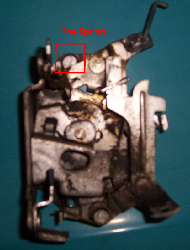

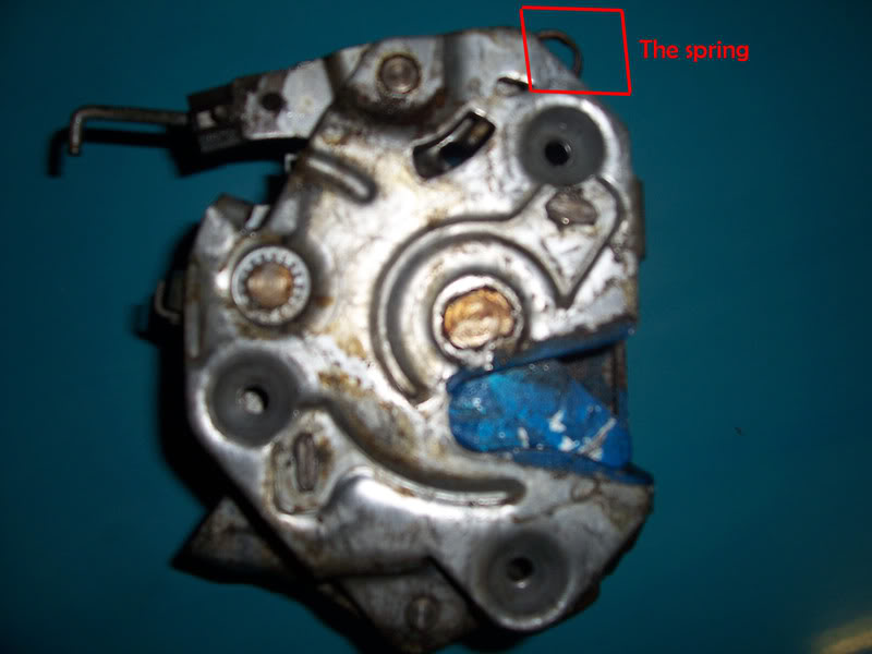

#4 Heath
Posted 16 November 2008 - 08:53 PM
Hey Josh just a bit of advice (not sure if you tried or not; may or may not know about it); most digital cameras have a 'macro' setting (makes the focus appropriate for up-close stuff), I use it for close-in technical photos. If you use a Canon, it is a rose pictured button, may be the same on other cameras. Woulda really helped those first two photos.
I've got some spare latches... I will get off my arse and take some appropriate replacement photos that look a bit sharper if you aren't offended :)

Reviving an old thread, I am seeking a clear photo of the front door lock mechanism to help me replace the detent spring. Whilst the idea of removing it to assist the solenoid was good, I am finding the driver door is locking itelf continuously which is more annoying than anything (with central locking at least the other doors remain open!).
The photo in this thread is blurry so I cannot see how the spring should sit. Any help would be appreciated!
