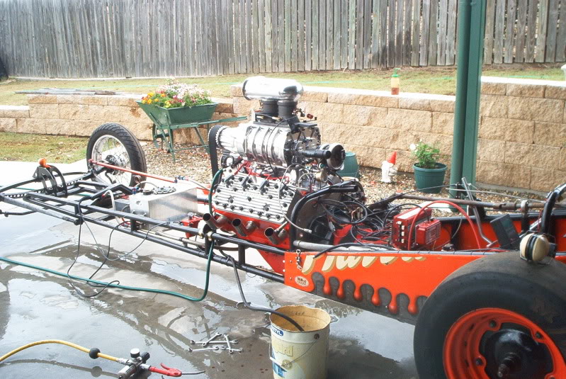

hi, this is one of the other reasons i have not been doing much one the lc as i have been busy helping
the old boy with his new engine it has got scat stroker crank h beam rods ross forgies 4/71 huge bottom
end girdle whitch we made the sump clear he has got some 29.5" tall tyres coming this week as we are
taking it out in a few weeks . we finaly started it yesterday and it sounded great there is a bit more to
starting this one now compared to the last one with just the mech injection on it.
Thanks Hayden

Nice ! thats gotta be friggin loud ! :D
Any shots with all the panels on?
Also ,Just wondered whats the go with the air line having the pressure reg/water trap on the end ? looks like it would be a bit awkward to use.
MT

mumstaxi,
i dont have any pics of it here at the moment with all pannels on ,yes it was very loud the air line with regulator was to check the msd timing retard was working it was a bit wild but it did work.
Thanks Hayden

Hey Hayden, Dad wants to know what that blue bottle beside it is :P.
#5 LX2DR
LX2DR
  • 1,763 posts
  • Joined: 21-November 05
Posted 11 November 2008 - 09:23 PM
Foam fire extinguisher is my guess.
Best to be prepaired
#6 _Drag lc_
_Drag lc_
Posted 12 November 2008 - 07:31 PM
D.J.,
yes it is a fire extinguisher foam or some stuff that puts out methanol fires.
Thanks hayden

3 of us made the whole car dad bent it all up then my mate pete (runner 202) welded it all including cutting down
the early ford diff making rear rims.grafted anglia front end,grafted cut down model A ford steering box on unsure
if you know but it has a trimatic in it you remember a while ago i told you he had a hydaulic shop well he has made
all his own t/brake,manual valve body for it(you can just see one of the orange hoses in top photo) he has now
worked out how to do it at the rear where the modulator valve used to go and has made one with a brought manual
valve body for pete to use when he turbo charges his 202.
he had the andra tec fella around today but i am unsure what the outcome was i think they want him to convert the
rear to full floater. as when we were in the usa we spoke to don garlits and he told us that those diffs would handle
1,000hp with a oil change every meet and when they made 1,300hp he told us that alot of people got hert using them.
so dads 300odd would proberly be ok.
Thanks hayden
