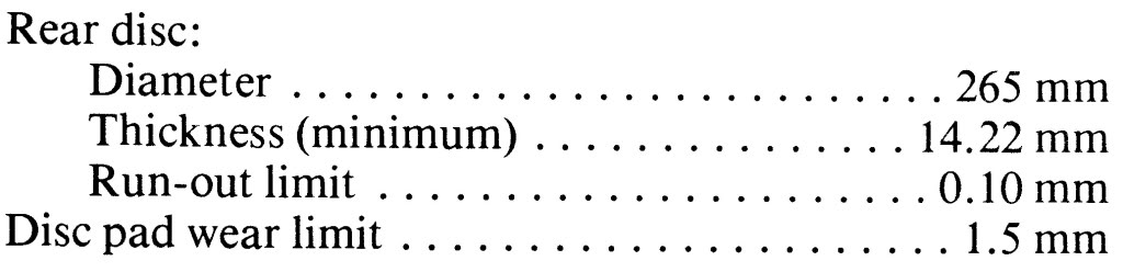

My Scientific Publications UC manual.
14.22 minimum
Cant find anything that says new thickness yet!

Rob, the rear disc listed there is 292mm diameter, which means it's an HZ rear. From what I can gather, the UC rear disc is 265mm diameter. My book also lists a 14.22mm minimum.
