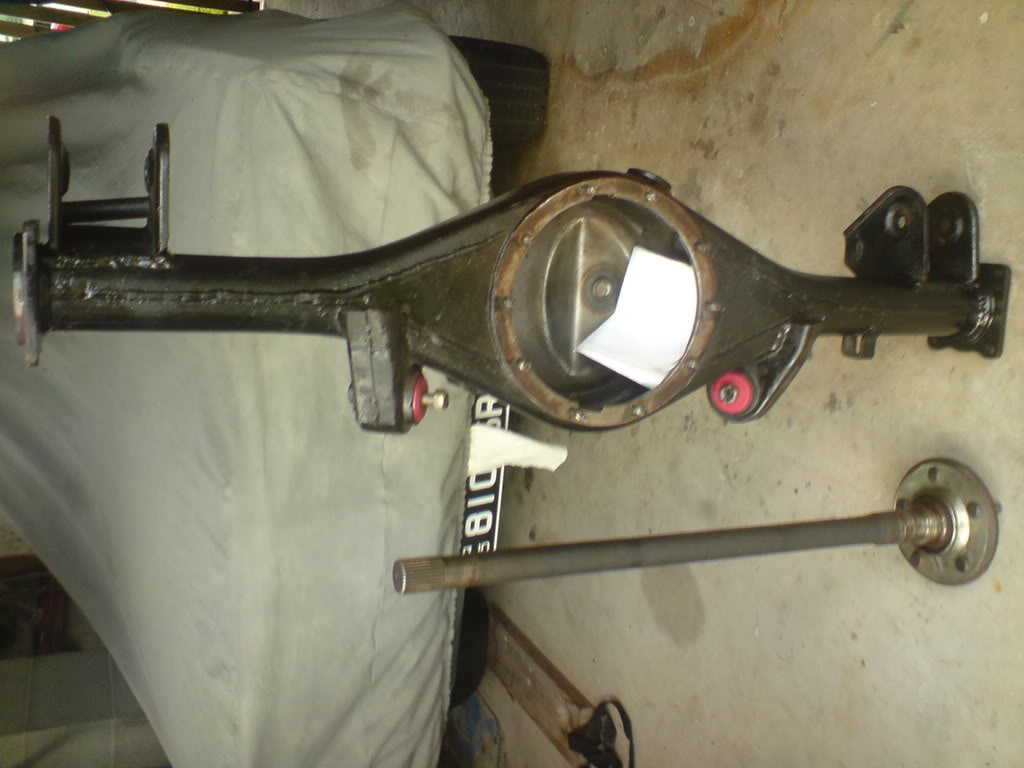

Hey guys,
I have a Borg Warner diff in my LC torana. It came out of an R31 Skyline and is still completely standard length with standard axles (28-spline). Until now I've corrected the additional diff length simply by having wheels with front wheel drive offset. OK, so now I want to change over to deep dish wheels (Weld Prostars) and will need to shorten my diff by about 3 inches.
Shortening the diff housing appears to be a straight forward job. However, what's the go with the axles?
Can you shorten and respline standard axles?
I don't suppose there are any off-the-shelf axles available or some from another car that would be shorter than the ones I have now, and fit perfectly?
I guess the final option for me is to get some Billet axles made... how would they cost?
Thanks in advance.

In order to shorten a standard axle I believe you need to cut off all the existing machining which would be more than 3 inches. Maybe Commodore axles would be long enough to shorten to your desired length?

i doubt you'd shorten the stock axles 3". the stock axles taper just after the spline,and you cant re-cut a spline into a taper.you'll probably have to get new axles made.

The short axle from a VL commodore is used on both sides.

definately dont shorten them,the axle is designed to twist a little and you will have to respline in this area and may result in a sheer off.the 2 vl axles sound like the way to go if you dont want to get new ones.if you are going to do the housing yourself,there is a bit of measuring to do and you need to get the yoke in the same place as it would be on the normal set up.the basis of it is,all measurements should be taken from the centre of the yoke being the centre of the tail shaft as well,not the centre of the housing.if put a line theer and then measure out either side,this will give you the right position for the brackets and overall lenght.to get the brackets in the right position.before you cut them of the lc one,put a line in the centre of the housing the entire lenght of it.this is done by using the flange on the end of thediff.half way between the top holes will be centre.once you have marked the line across the lentgh of the diff,then mark on each bracket where it interesects the line.then strip the brackets off the bg diff and mark a line acroos the centr of that housing.then measure from the centre of the yoke to the positon of each bracket,mark that on the bg diff,then you can cut them off and just put it where your mark on lc bracket meets the centre line off the bg housing at the right measurements.i would strongly suggest you that you spend more time marking and planning it before you start cutting as you only get one chance at it.also you need to make sure the end flange is on at sqare as well.

Hmmm..now you have me thinking...all my spare axles are in the new shed so cant measure them...maybe..just maybe....you could use another short axle on the other side and shorten the diff housing that way,,,moving the centre back into almost the...centre..if you get what I mean...?? I would have to measure the axles..you will have to move the brackets anyway...just a thought.

LHoon I have some VP axles in the shed - the short one is 705mm and could be cut to 590mm or shorter, the long one is 800mm and could be cut to 690mm or shorter (this is where the machining is). Both measurements taken from inside of wheel flange to very end of axle.

I am not advocating shortening axles, but have a look at HQ-WB tonner axles. These can't be shortened to LH-UC length, but could be done to LC/LJ length. This is of course when using a 10-bolt centre hence equal length axles. Might be worth a look for the BW centre, especially for the shorter axle?

R31 Skylines are 675mm and 725mm.

you can get the standard b/w axles shortend I had a set done they lasted me 7 years before the splines started to twist
after that I brought a set of mosers. Price wise $120 to $200 per axle to be shortend and resplined.

PM me on what you need and pricing. Axles can be resplined. Twisting is not an issue, as they normally twist/shear near the splines anyway, the old ones which are cut off when you respline. Little bro can do the whole job, or just the axles.

If done the right way a shortened axle can be fine. One problem that can happen is if the axle is too much bigger in diameter than the spline you want to cut, you end up cutting too deep into the case hardening of the axle and into the soft core. The other major problem that occurs is not seen much these days but what guys used to do was cut the flange end of the axle off and machine and reweld the flange further along the axle. This means that you could shorten an axle only using a lathe and not need to cut a new spline.But this was very dangerous as a failure would often result in the car loosing a wheel and the brake assembly. at least with a resplined axle failure you just break the spline off..I have great experience with the broken axle scenario, never with flange breakage but many twisted splines. I have used many resplined axles in cars that run into the 11's in the 1/4, many of which are still going today. One of my mates has big block uc and runs 10.3 1/4 using resplined 28's yikes !!!. Having said that i have also seen a pile of factory spline axles fail too
By the time you buy some billet axles have them trimmed and bearing spaceing set up with correct wheel studs and centre hub then squeeze on some new bearings they will probably owe you a grand, but you can usually get away with resplined axles for 500bucks. depends on budget i spose
