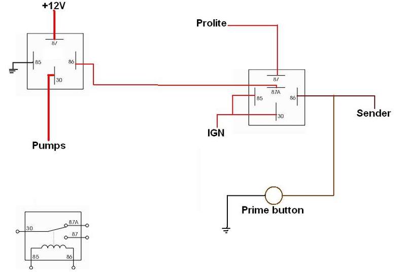

im using an autometer 15psi switch to trigger an autometer prolite warning light and also have it wired to a relay which cuts the fuel pumps when pressure drops due to engine trouble or a crash

to prime the fuel system i put a button switch on the dash which supplies a relay with the earth to switch the pumps on. so turn on ignition, push button to prime then start.
it took a lot of messing around with relays to get it to work properly. ill try dig out the diagram i drew up for it

pretty basic. use a 2 pole relay. pin 87A is live when the solenoid is off ( have oil pressure). then when pressure drops, the solenoid sends the earth to pin 86 which drops power to 87A and activates 87 lighting up the warning light and dropping feed to the fuel pump relay and cutting the pumps. to prime tap a button into the wire leading to the pressure switch to trip the relay and allow ignition feed to go to the pump relay.
the motor wont cut right away as there will be still fuel in the bowls unless its EFI

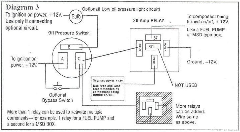

G'day Tiny I am actually in the process of wiring Ant's carter fuel pump. I will be using an oil pressure safety switch to cut power to the fuel pump. I am planning on using this product from summit, link below.
Summit oil pressure safety switch
This safety switch opens the circuit once oil pressure drops below 7psi. I will not use it to cut engine power, but to cut power to the fuel pump. As mentioned by Why-psi I will also include a primer button to prime the pump with the ignition on without the engine running. This is labelled on the diagram as the optional bypass switch. The wiring diagram also shows how to wire in a light to show low oil pressure. I can't see why you couldn't also wire in a buzzer with the light.

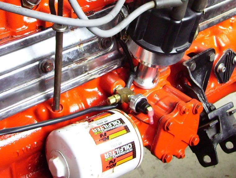

here is a few pics of the hobbswitch we use they are quite expensive i think but we use one side for oil warning light
the other switches the hour meter as to get a good idea of how much work the engine has done. sorry for the poor
quality of the pic that is under the rubber plug you can adjust the pressur at witch it switches by adjusting this grub srew.
i just got them from the local auto electrial place.
thanks Hayden

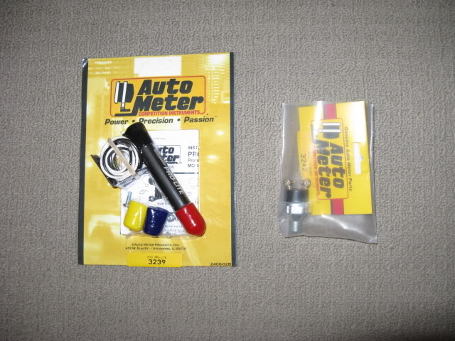

Have just bought an Autometer Mini Pro-Lite, and the 30 PSI switch. Currently running an Autometer Pro Comp oil pressure gauge which will remain - was wondering what sort of T-fitting people use to run the Pro-Lite AND a gauge? Couldn't find anything in the Autometer catalog. Are they just a fairly standard part that can be found at most performance shops?
Thanks!

Harve: Did you have the autometer mini pro-lite or did you buy it? It's something i'd like to use as my warning light too, but i think i've left myself little or no time to find/buy one before i need this job done!

Tiny: I bought the Mini Pro-Lite about a month ago, just haven't got around to getting it fitted yet. I ordered one and it arrived 2-3 days later, so i'd say you'd have no probs getting your hands on one from American Autos. Just in case it helps, the Mini Pro-Lite Warning Lite (in black) is part no. 3239. The 30psi Pressure Switch is part no. 3242 (i assume this would be the go for your 400 chev).
