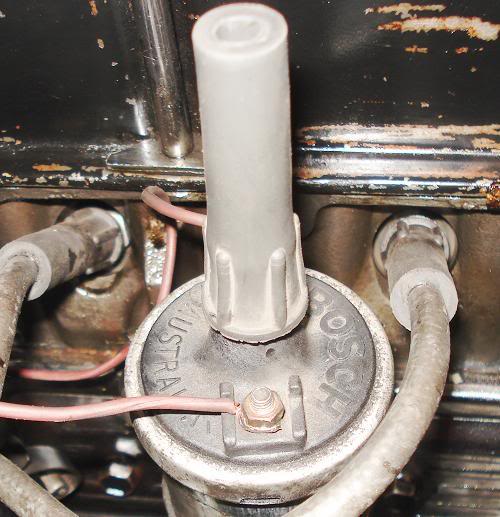

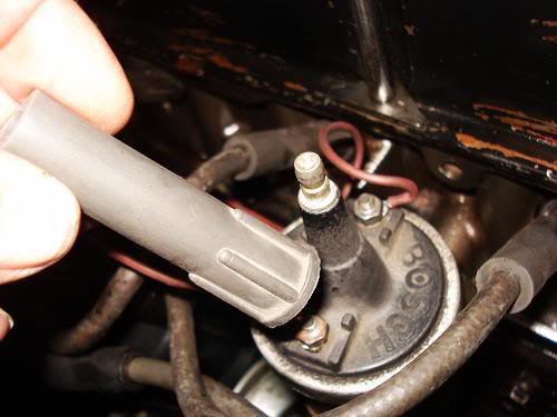

I removed a cap from an old lead and placed it on top of the second dizzy as the electronic ones protrude out from the coil. If using points fill the hole with something like silicon or arildite as long as the arildite can handle the temps to stop spark escaping.
A pic would be good. I'm having trouble with this bit.

I have a few bad plug leads lying around and just cut the lead and removed the rubber plug part of it.
I always say it isn't a pretty car as I can't afford to have both go and show so I make mods that increase power over looks :)
#6 rodomo
Posted 28 February 2009 - 11:33 AM
Thanks for the pic but what does this achieve? :huh:
