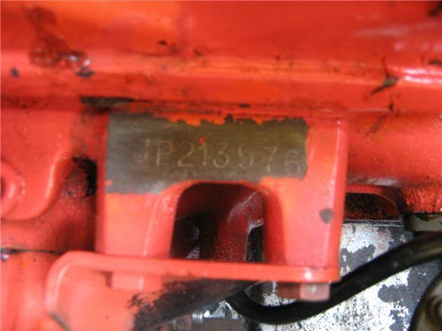

i have been talking to the owner of a yellow dolly 72 bathurst car on car point, he has sent me some extra pics and this one pic of the engine number, it looks sus as what do you guys think.

im no guru but geez the j and 6 are way out of line from what i can see.

Looks OK... they were hand stamped.. ask him for the cast date.

Looks like the engine stamper on the day fell asleep
Ha Ha - or it was the work experience kid.
The font and size looks ok (and it is the correct engine number).

looks not quite right from where i sit ... the J looks like a fishing hook and should not ....

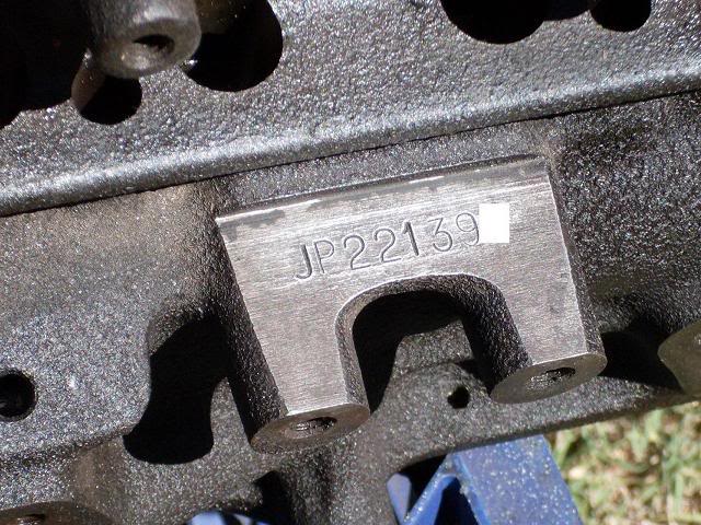

Posted ImagePosted Image
Yes i would agree that the hook on the j appears to be to long however he may have forgot to grind it off :<_<: and check out the 2

at the very least the J and the 1 are different font.

82911JL215996, JP2205 _ _. I am still skeptical of the Bathurst cars... although i thought it was only the 9th not 8th monthers that qualified ?
and still not sure on that engine number.... One comparison with an "apparently" original stamping is hardly proof.... though mine also appears not to be hooked quite as much... but maybe they just didnt hit the punch hard enough !

I don't think that the picture of the engine number is clear enough to doubt its authenticity. The font looks OK to me but as I said it's not a very clear picture.
