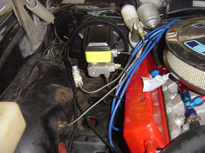

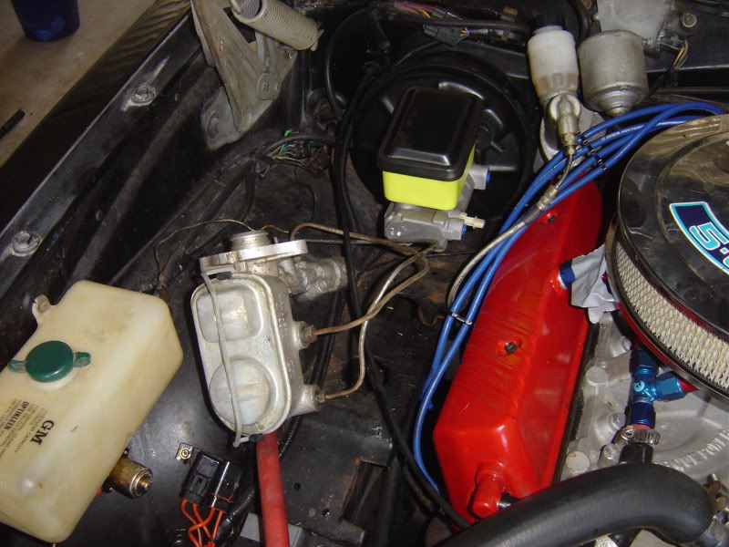

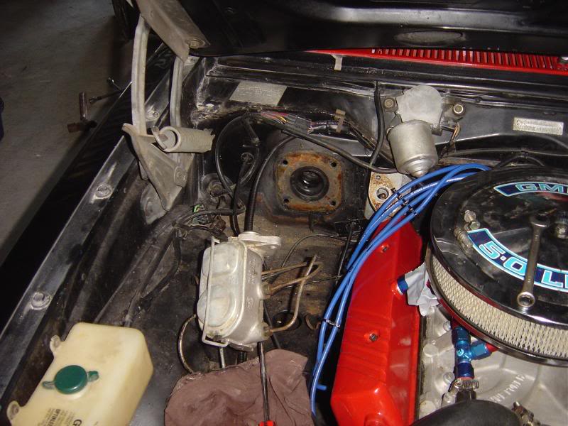

Remove your old booster and master cylinder. Don't take the lines off the master just yet..pull it aside out of the way.
Items needed.

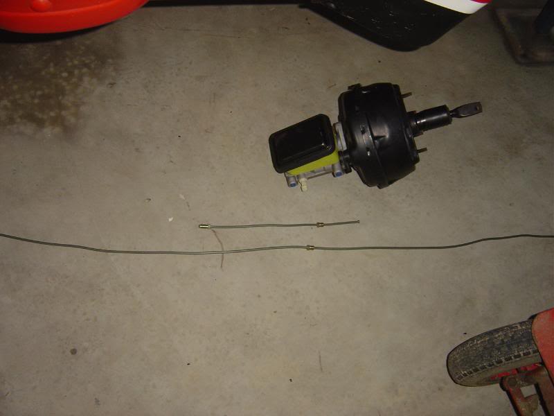

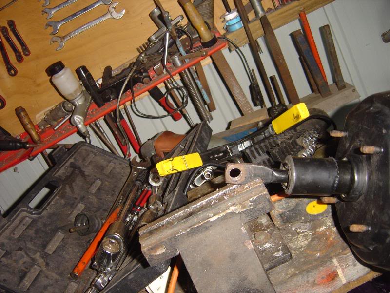

1 x VB - VR Dual brake booster. Booster arm needs to be shortened 50mm back to 140mm fron the body face to the centre of the arm pin hole.

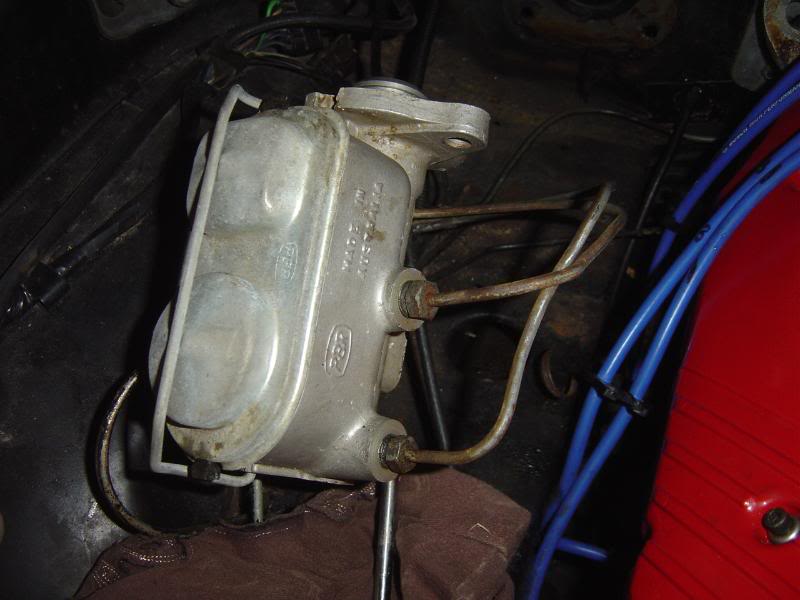

1 x PBR P10050 master cylinder.
1 x brake line made for front passenger side with Torana end with double flare and long Ford end with ball tip.
1 x brake line for drivers side same set up as above.

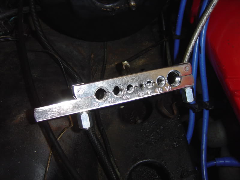

Now on the rear inlet pipe you need to cut off the tip...remove the large screw head and fit a Ford long type end and ball flare the end.
I bought one of these to do the ball tip or you can truck the car to a brake specialist.
Obviously the 2 front lines go to the front and the rear line goes up the back on the new master cylinder.
Don't forget to drill the new booster arm hole the same size as the Torana one as the Commodore pin is smaller.
I am plumbing in a Wilwood Bias brake adjuster into the rear line as well but the principle is the same.
More pics as I finish off the job.

Yes you can cut and mod the lines if you like..I chose to do new ones as they were $25 for the lot so seemed cheap to me.
P10050 from Repco or any brake/parts place.

Fit the Commodore booster witout the master...I had to take it off again.
Next you need to cut the end of the rear line off and remove the big flared end and fit a small Torana one, same ason the front guard lines.
Now remove the passenger side line and feed in the new line. When bending it just make wide bends with your fingers. Don't kink the line anywhere. Remove the old booster and prop valve as a complete unit. When you have the passenger side line basically in place fit it to the new master. Now bolt the master onto the booster.
Now fit the other lines, I have plumbed in a brake bias adjusting valve but the principle is the same.
Bleed the system.
Drive.

Only do this if you are fitting a bias adjuster into the rear..otherwise you will do a Ford ball flare type end and long Ford screw flare to suit onto the rear line straight into the rear hole of the new master.

One last thing....on the later Dual booster the rod is not adjustable..and with the P10050 the rod end needs to be dead inline flush with the bolt up face of the booster so it doesnt pre load the master.
Also,I couldn't get fluid out of the rear hole of the new master until I reverse bled it with that bloody big syringe and a bit of tube I have. Just push some fluid back up the rear hole...the bubbles will appear in the master...bolt on the rear line and bleed.
I also had to shorten the rod back 3/16" to be flush with the face with a grinder...as Datto said...slowly, slowly.
