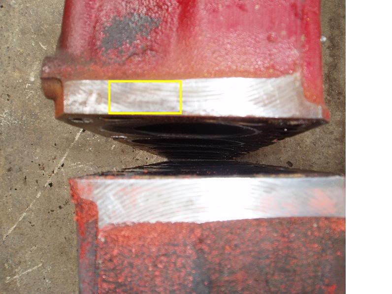

From the pic in you other thread its a small chamber head...It is either a 149 head if the date code is 1964...or it could possibly be a 173 head if its 1974.
Can someone confirm 173 has a small chamber head?..and cast number
The Holden part numbers have nothing to do with what Yella Terra might have done to it...does it have some numbers stamped here:
