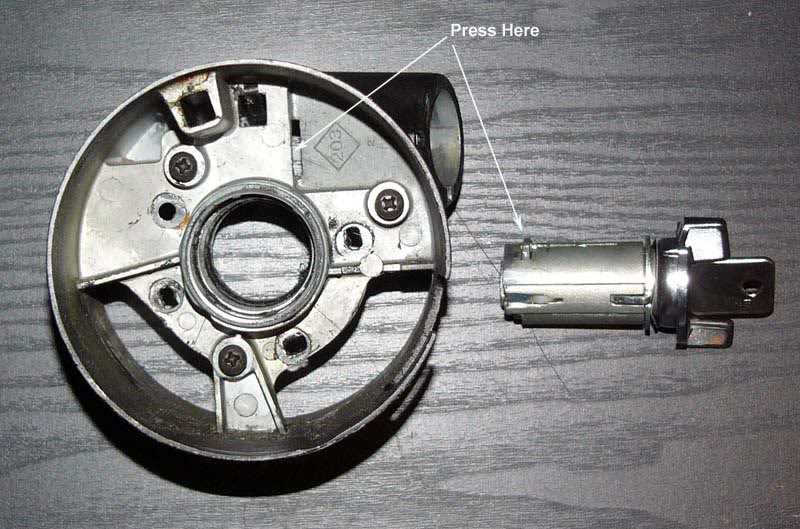

So, I found this thread in the Google time machine. My story is, to get the barrel out I was basically going off videos on youtube featuring WB's and H whatevers, because there aren't any Torana ones.
As per those, I pulled the external part using multigrips, and it popped right off. Now I don't know how much trouble I'm in. It looks like there's a little collar holding the barrel in, but I can't be sure. Is that the spring steel someone mentioned above?

Basicly the same as the H serirs car any way. Key must be in the correct position, Dont rember if it is Acc or on but you can not press in the locking tab if it is not correct. Push in the lock tab in through the slot (long and narrow in the upper RH of your Picture in line with the end of the lock) I normaly find a small screwdriver will do the job. It is often possable to push sideways on the screwdriver once the tab hase moved in to start the barrel moveing, Then just slowley pull it out. Not into applying force to the tab at the end of the lock, They tend to pop off as yours has. Can still be sorted by a locksmith if you dont loose the part,
     I normaly fit a compleat new lock set to my older Holdens anyway, Makes it a lot harder for any old worn key to open and start the car. I have had dammaged locks by someone trying to force the door and ignishen in the past but the new locks stoped them getting the car.

Thanks! I was pushing the tab and pulling the lock, because that's how a video showed it. ☹
I'm replacing the barrel because at one point my key was just spinning around and around. I couldn't select any position, but now it seems to do a couple of positions. One of the comments above said it doesn't matter, but it obviously can't hurt!

Success! The screwdriver got no sideways movement going, but the pointy vice grips did the trick. Although I have no idea really about what position the key was.
