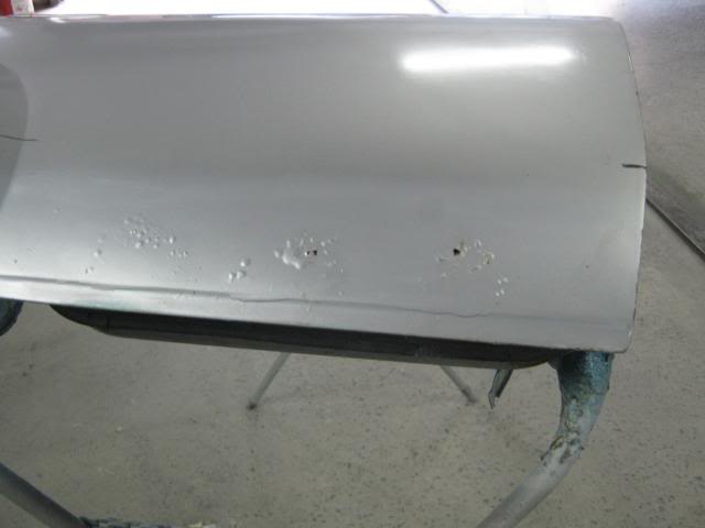

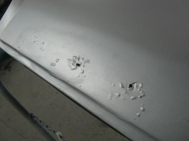

The door on my car was badly damaged from contact with a garage wall or something so was beyond reasonable repair. I was lucky & found a genuine NOS skin for $200 which is cheap as a VZ Commodore skin is over $220 & easily found.
First step is to remove the trims, door glass etc. I leave the rubber seal (in this case I pulled back & taped away from the main part of the door to the top of the window frame) & door latch in place for reasons i'll explain later. Once disassembled & placed upside down on a suitable stand, there will usually be spot welds around the flange fold. These will have to be drilled or ground away. This door had been reskinned in the past & had the folds brass welded.
Once these are removed, using a disc sander with coarse grit disc, carefully gring around the edge until two layers of steel are visible. Once this done the flange fold should come off relatively easy.

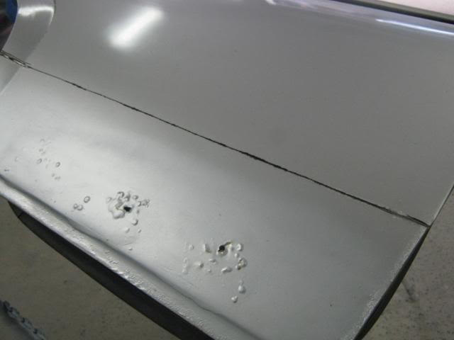

Before trying to remove the skin, you will have to find the join on the window frame. I don't think Rare Spares skins join the same, in which case I would lay the new skin over the old one & mark out the join & cut acordingly leaving about 10mm overlap.
Carefully cut the join, taking care not to cut through the frame as well. You will have to turn the door over & cut the flange fold too. Now the skin should lift off.

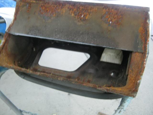

Using a wire wheel & sander, clean any rust etc off the edge of the door shell so it is clean, even & rust free. If any serious rust is found, it will have to be repaired before the new skin goes on. If is only lightly pitted treat with POR or deoxidine. Once this is done, apply zinc primer aound the shell frame including the flange fold. To avoid water from getting in between the skin & shell, I apply a bead of seamsealer around the edge before I lay the skin down.
