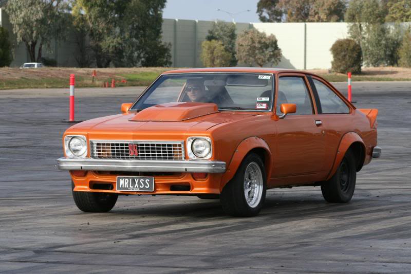

This was my car with
225/50/15 Tyres and KHFL-14
I am hoping that the A9X lowered ones are lower than these ones 15-20mm would be spot on for me.
The ones i have in now are modified and too soft for my liking.
But I'd like to be around this (current) ride height.

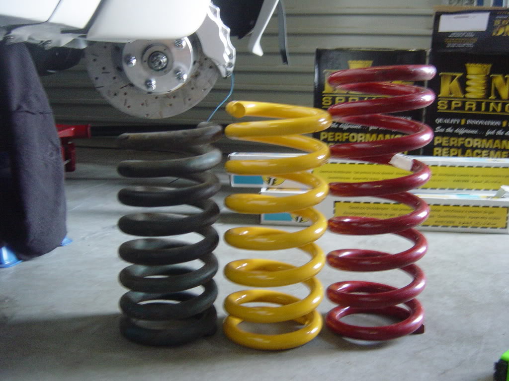

theese are pretty much the 3 sizes u are looking at.i just remeasured them exept the yellows.they are in my car
red spring=pedders standard 330mm long
yellow spring=king spring khfl-14(2 inches lower than standard.pretty sure it 280mm long)
blue spring=lovels 255mm long (this was in my hatch when i first got it.running 14/50/245 bf godriches.the wheel was similar that last photo,nice and low.u could hardly get a jack under it)

Thats a good pic of the springs... I wonder what the A9X springs look like...
Just wait... I am going searching for something

the A9X spring will be between the blue and the yellow.im pretty sure it was about 10 mm higher than the lovells spring.if im right the A9X spring will be 265mm long.thats from
memory.
if u want u can trial fit my 255mm long ones

No point comparing free length, for ride height comparison you need to compare installed height and spring rate.
#16 _cruiza_
_cruiza_
Posted 16 June 2009 - 05:57 PM
I think you will find that comparsions between springs sitting out of the car are no good as the stiffeness of the springs means that a tall looking spring once fitted to the car could compress more then then a short stiff spring. So the only real way of knowing is asking the manufacturers or fitting them to your car and letting them settle for a week or two, car must be complete too
