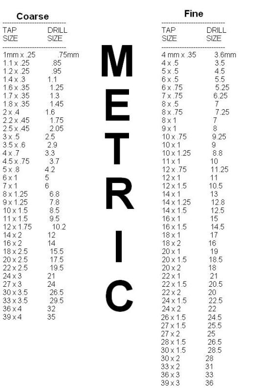

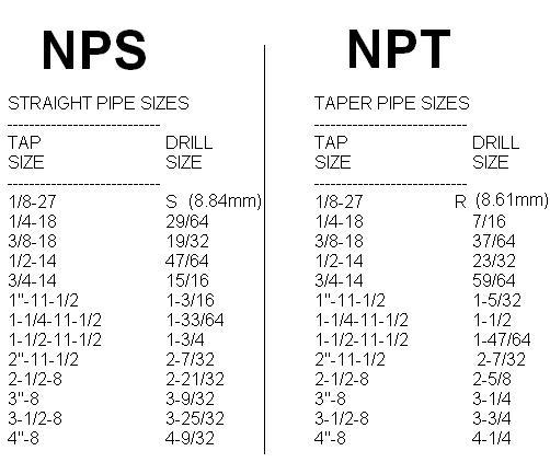

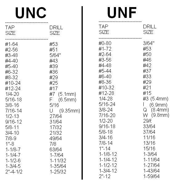

a while ago i made myself this guide and i keep it handy in the garage. thought u guys could use it too. print it out, laminate it, or watever.
(i keep the pics in my iPhone cos im a yuppie, and its always there when i need it)

Metric is very easy. you minus the pitch from the diameter to give the drill size
M16x2.0 pitch = 14mm drill bit
it also has something to do with material hardness as well but probably not worth going into unless the thread strength is critical
