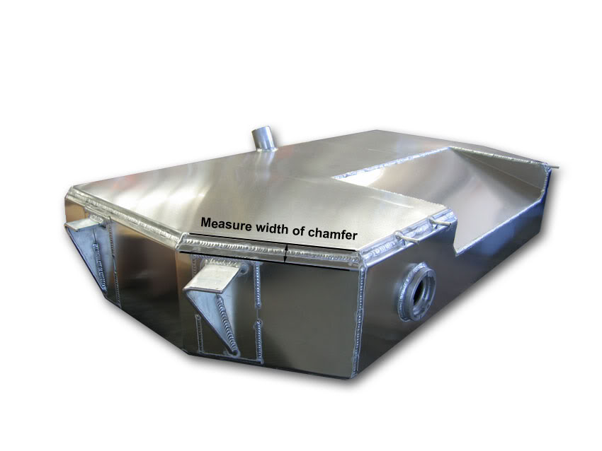

Could someone please measure how wide the chamfers are on a Brown Davis drop tank?

I made mine 25mm in and 25mm down giving it a 35mm width, this was copied from a Brown & Davis tank (all other dimensions differ).

about 30mm max,and i didnt measure the top.i cant get to it.
thats a measurement from the bottom chamfer.

Thanks for the measurements, I am designing a tank to be built by a licenced fabricator. I can not decide whether to have the chamfered joins or straight butt joins.

The reason for the 45deg edge is to stop the buckle and wave that you can get when welding, plus it looks good :D

Correct, Brown Davis use 2 mm sheet which requires the 45 degree join for strength and to eliminate distortion. If you use 3 mm sheet then the tank is heavier but the 45 degree join is not required. The 45 deg join is more complicated to design, cut and bend.
I am undecided which type of join I prefer in terms of appearance so I was planning to design two tanks and make prototypes of both.
