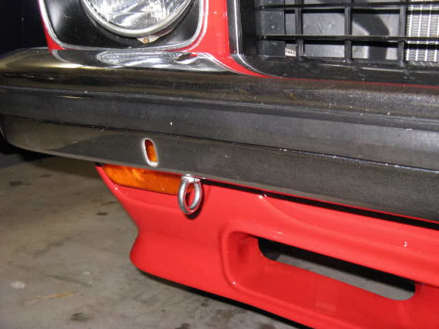

I don't know if it's the "best" spot or not, but I fitted an eyelet in place of one of the bumper bolts. It was going to be temporary, but I've ended up leaving it there permanently in case of emergencies. It works like a dream, and because it's screwed directly into the main bumper bracket, it's plenty strong enough... well at least for short towing situations like you described. It's come in handy and saved my ass a couple of times now.... here's a pic..... look to the right of the drivers side indicator lense....

#5 _fatlh5000_
_fatlh5000_
Posted 26 July 2009 - 09:46 PM
Thank you guys.
I will get myself and eyelet asap, and fit it up.
Thanks for the photo LX Chev- PERFECT !!!

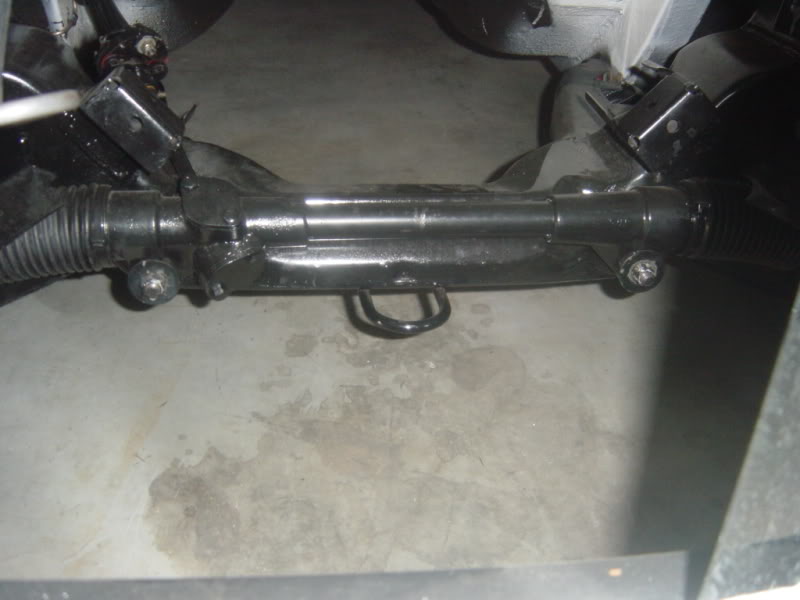

I saw a pic on these forums somewhere.....there was a loop welded on the shocky mount [diff].
I thought it was a great idea, so i'm doing it too.
#10 Heath
Posted 27 July 2009 - 05:56 PM
Yeah I saw the same thing and thought the same thing! :P

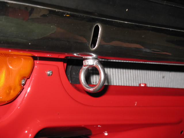

Great idea, hardly noticeable really, I'll be doing the same!
Does the eyelet section actually need to press up against the bumper, or is it spaced out a little by the way that it's secured? (if that makes any sense)

#15 _SS Hatchback_
_SS Hatchback_
Posted 28 July 2009 - 10:11 PM
Harve , get a collared eyebolt, the eyelet then has a flat section which is what i think you asking for

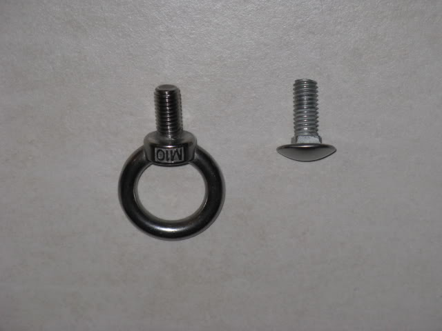

Here's the loop that I grabbed today. It has not got the square section that sits inside the bumper/bracket, as per the orig standard bolt (on the right). Not sure if this would be possible to find anyway. With a washer in place, I assume that this will still be fine?? I guess the square section only stops the orig bolt from spinning when being tightened. How does this compare to yours LXCHEV?
Just placed in, not tightened yet:
#19 Tiny
Posted 15 February 2010 - 07:40 PM
Spot on i think Harve!
The square only stops the bolt from spinning during tighteneing.
I like the idea gents! Especially for a well raced vehicle!!
Fatlh5000: You dont need to go to mascot steel, you can go to any nut and bolt supplier at all - I would be asking for a stainless steel - collared eye bolt as SShatchback suggested, they have flat bearing surface where the thread comes out from. You can also buy a nylon washer (for the top - so you dont scratch the bar!) and a NYLOX nut so that it doesnt rattle off the back!
