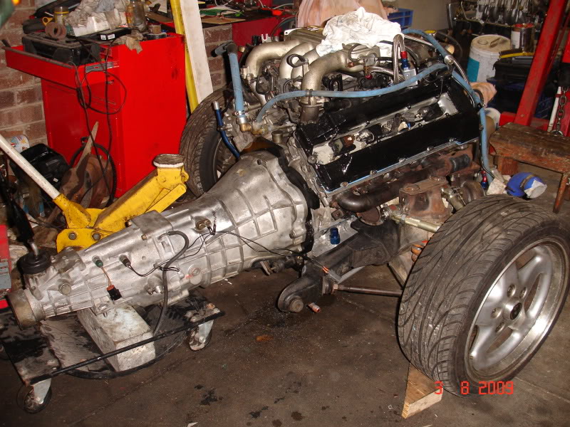

I have already cut out the tunnel and bought cold rolled sheet metal, should arrive Tue so I will be withdrawing for a few days for not doing any work on the Torri
The RB25T Nissan box is pretty tall and fat so your tunnel my not be the go.

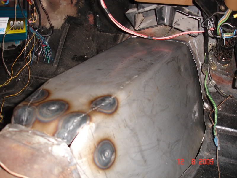

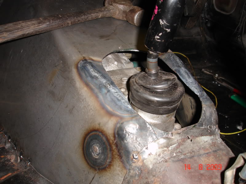

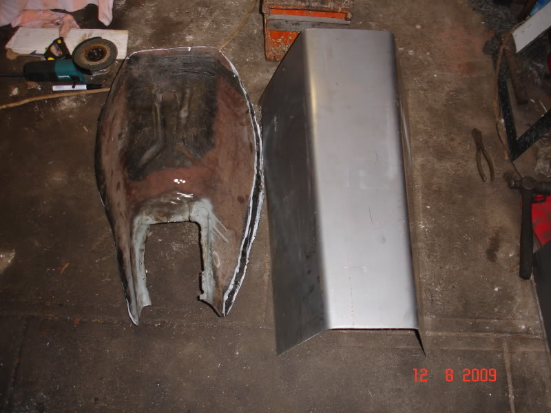

Posted 11 August 2009 - 10:59 PM
Still early days, looks a little too angular, but then i probably shouldnt worry too much about asthetics since its just a tunnel.

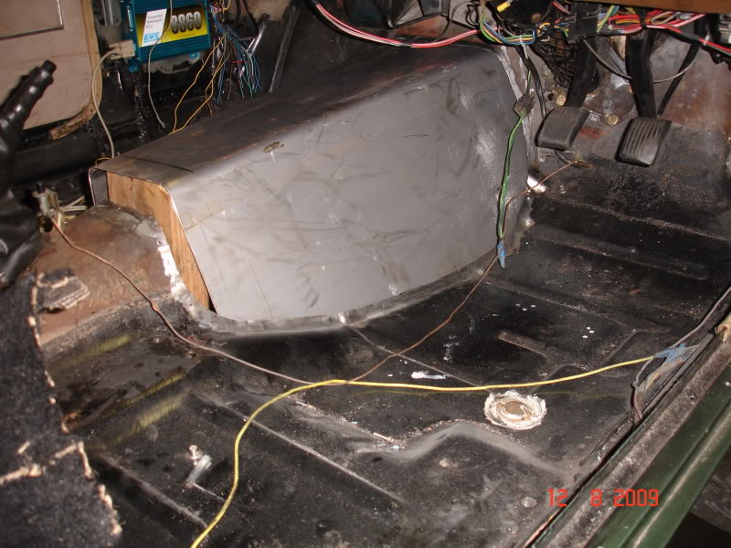

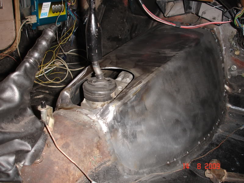

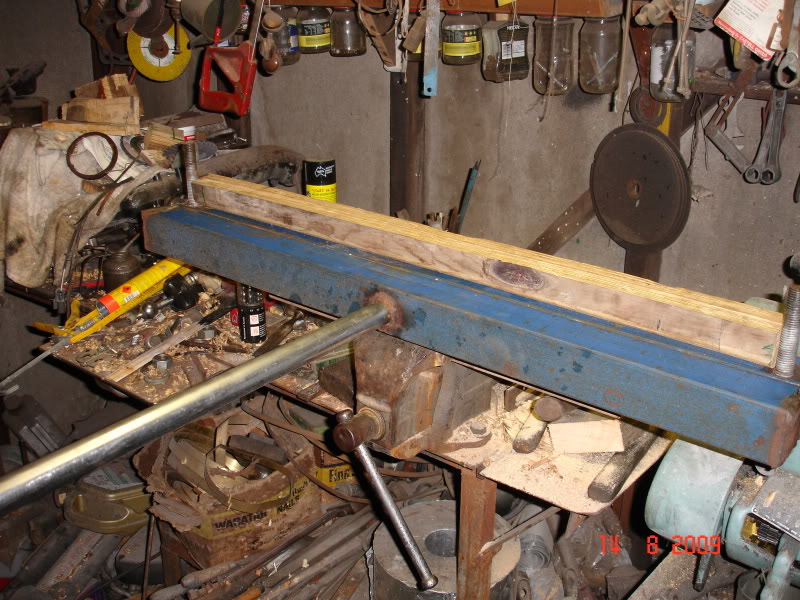

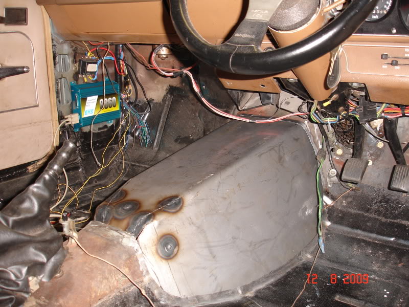

Posted 14 August 2009 - 01:48 AM
This is my home made folder originally made to fold aluminium, to my surprise it folded 2mm cold rolled steel.
Tunnel progress, i have tappered the back end of the tunnel a little more.

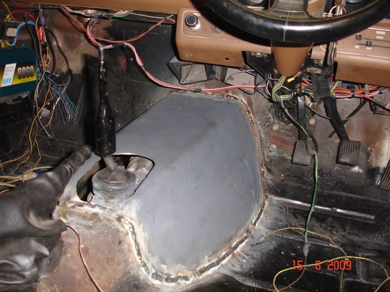

Posted 14 August 2009 - 12:24 PM
Time to fully weld it in today.

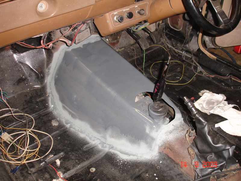

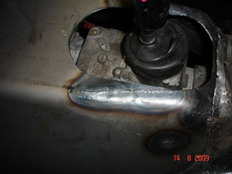

  • Joined: 20-November 05

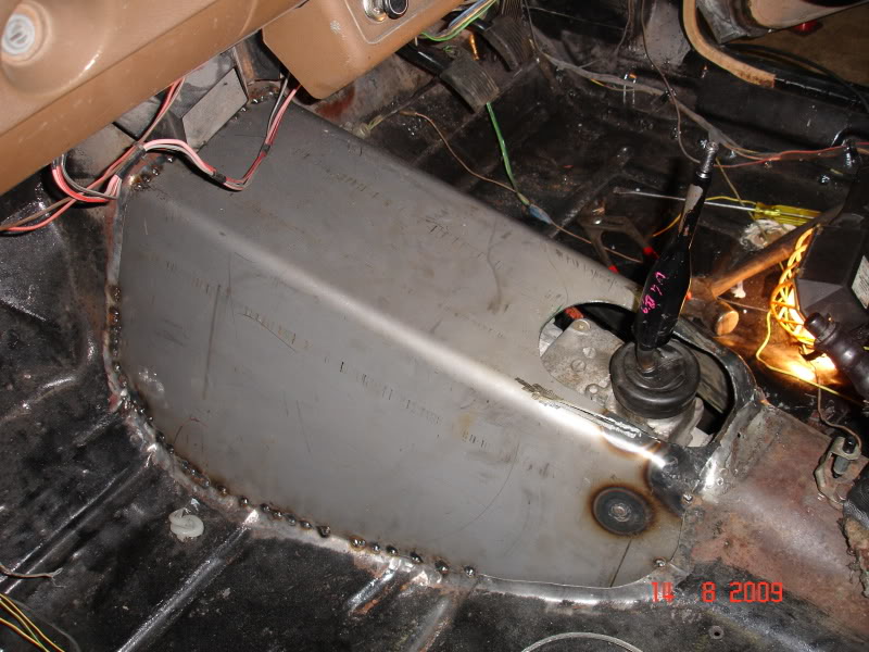

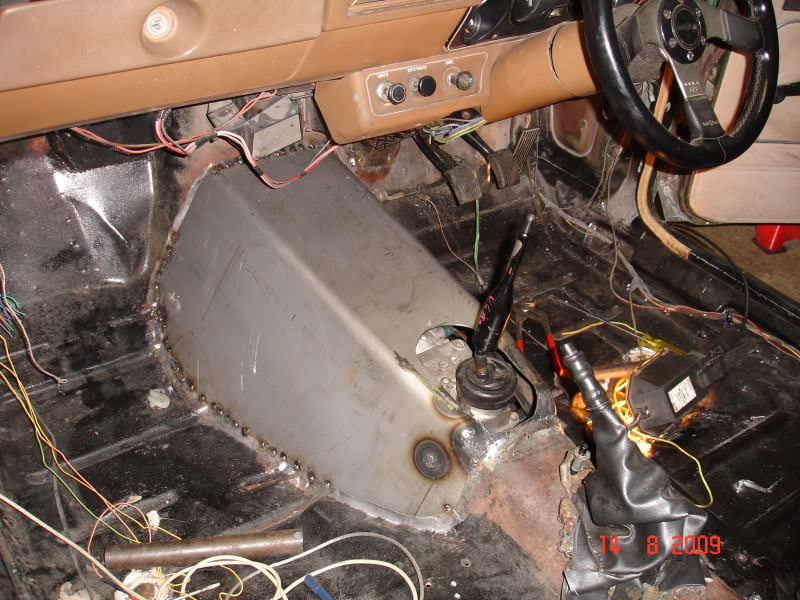

Posted 14 August 2009 - 10:50 PM
Fully welded
Real prick to get my head in there, welded a little blind near the fire wall but got there at the end.

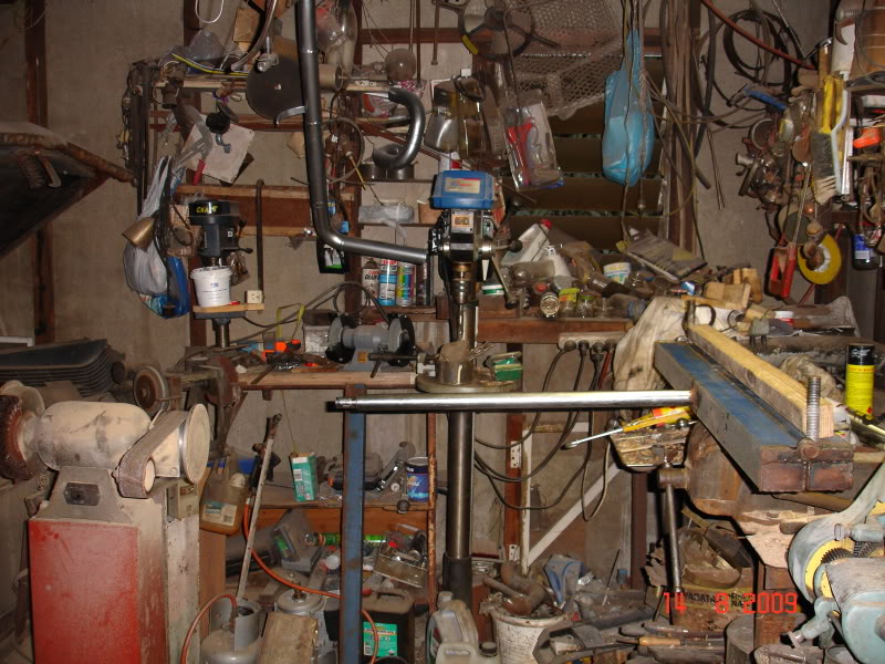

#21 rodomo
  • 18,080 posts
Posted 14 August 2009 - 10:59 PM
Love your shed mate. Looks like mine :D
Better than some of the gurly sheds you see :stirpot:
AND.. I have bent sheets with a bender just like that :clap:
#22 Heath
Posted 14 August 2009 - 11:12 PM
LOL I could not work in a shed like that, but clearly Bart can. That looks sensational! Very simple in its form (which I'm sure made it much easier to shape) but it just looks perfect. No excessively large dimensions... looks like there is still a fair bit of room left in the footwell for your feet to operate in etc. Tops!
#23 Bart
Bart
    Shit a brick
  • 2,559 posts
  • Car:LJ Torana
Posted 15 August 2009 - 10:44 PM
Thanks mate its a little crowded in there but does the job, occasionally trip over shit lol
I have plans on building a 8m X 5m out back maybe a little bigger, have to see what the bloody council allows, damn Nazi's :<_<:
