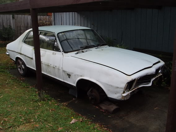

#21 rodomo
Posted 03 February 2006 - 12:33 AM
These are 15" volvo on the back of my LJ but the fronts foul on the upper wish bone. Will need spacers to fit.
https://cache.gmh-to...WHITETORANA.jpg
RACV MAN
