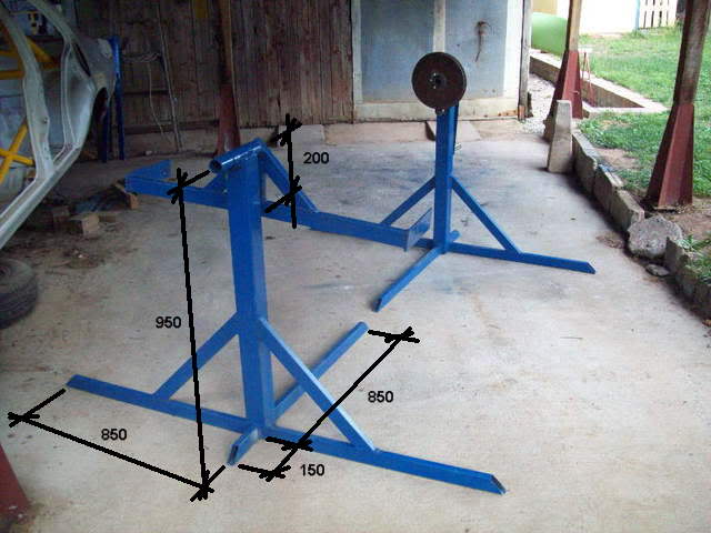

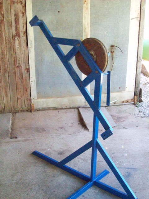

Hope you can read the dimensions on the picture, but if you can't, it is basically 950 from the floor to the rotating centre tube. Brackets both ends are offset 200mm from the centre to the centre of the bumper bar supports.
This allows you to spin the car within a total height of 2.1m, with the top corner of the turret clearing the ground by about 100mm. The heights also allow you to mount the car onto the rotisserie using a standard hydraulic trolley jack.
This is the bracket at the other end. It is similarly offset by 200mm, same as the front one. Also Mark 1 posts that got changed to 90x90x3mm wall SHS.
Have fun. They are easy to make, and you'll have it done in a day and a bit.

Why do you have a 200mm drop from
the centreline of the pivot point?
Chris.
#11 _Yella SLuR_
Posted 19 January 2010 - 06:46 PM
I read somewhere that that is approximately where the centre of gravity is. It's not exactly right, but close enough. Car stays put in just about any location, and no locking mechanism.

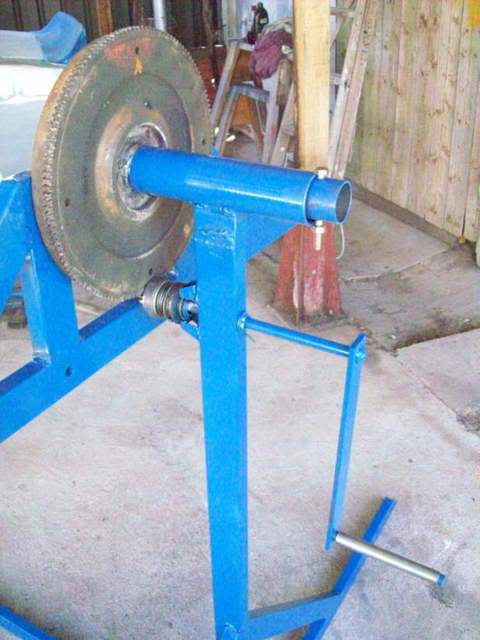

Believe it or not, the biggest problem with balance is when the car is sitting level. Sorta likes to have the right or the left side sitting a bit low. I just but a small piece of 10mm MS in the end of the shaft for the handle to stop against to keep it level.
Oh, just a tip. If I were doing another one, I'd offset the rear bracket more where it mounts into the rear bumper mounts so you can get in there and paint it while it's on the rotisserie. As it stands at the moment, I'll be painting all but the ass, then filling it in when it comes off the rotisserie. Just something to consider.

^ yep just add some length to the arms to put some space between the back of the car and the rotisserie so you can get some paint in there. Will still work doing the ass after though.

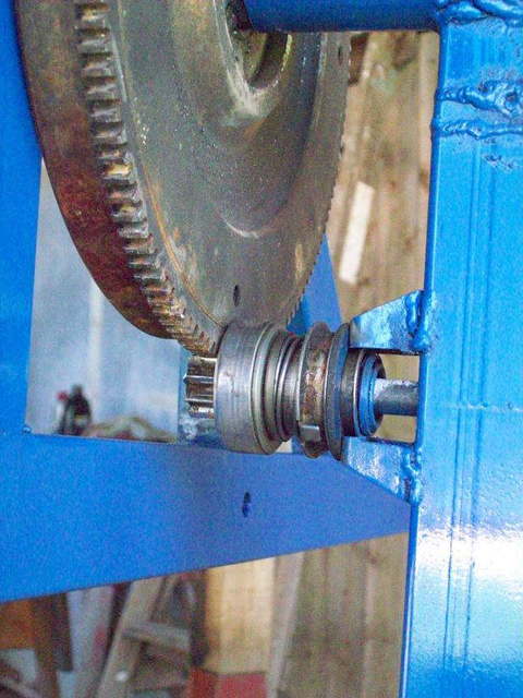

I was going to use engine stands and just add material to them, but when it came down to doing it, I realised, all I was using the engine stands for is to get the angles all correct, and it was expensive. If you are getting an engine stand for free, well I spose that changes the equation. I was given an engine stand, and well, it now has an engine on it.
Here is a pick of the flywheel, I'm told your better off using a drive plate, as it is steel, not cast. I just pulled apart the throw out gear from a starter motor, stuck a shaft through it (16mm OD from memory), used the throughout spring, and a bit of 25SHS, and voila, a 16:1 ratio handle.

#16 _Yella SLuR_
Posted 19 January 2010 - 10:25 PM

The LX is now on the Rotisserie,
pics link for all of them,
Car Rotisserie Pics
Thanks Yella for the measurements,
work well,
We used a height of 950mm from top of centre bar to centreline of pivot,
Drop from the centre line of pivot to centreline the bumper bar of 200mm,
and the car rotates great,
still am going to add a handle on one end,
and a tie bar from one to the other
to link them for moving the car around the workshop,
it works great.
We built this from 2nd hand steel from the local metal recyclers,
hence the different colours, but was cheap as, 50 cents a kilo for the steel,
instead of $23 to $28 per metre.
Total job cost including wheels at $15 each,
(from a large hardware chain, not because I endose them,
they are cheap and near my workshop)
The 100mm wheels are solid rubber, steel centre load rated 100kg each
We built with materials cost for the job for less than $200.
We used 75mm x 75mm x 3.5mm for modifying the old engine stand,
show as Part 1 in the photos,
Stand 2 is 65mm x 65mm x 3.5mm
The turn head, very 2nd hand flex plate ex V8 auto,
75mm outer tube,
65mm inner stell tube.
Front and rear bar mounts,
50mm x 50mm x 3mm on the front
75mm x 45mm x 4mm on the rear.
these sizes because that was all we could find on the rack of scrap.
Upside Down
Right way up
