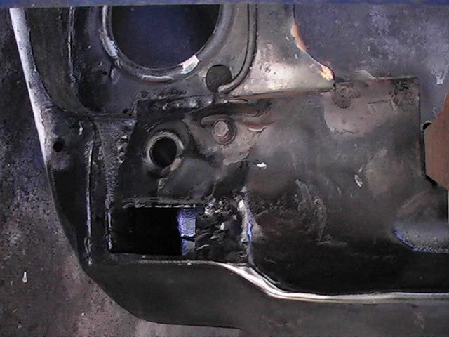

When attaching the valance to the rad support; does anyone know how to properly address this gap here?
It looks like an epic way to collect water in the valance.
#14 S pack
Posted 17 September 2025 - 05:30 PM
Worrying about nothing. Plenty of water will also get in via the big holes for the indicator wiring directly above the indicators.
Just ensure the insides of that valance area is well rustproofed and the drain holes are clear.
