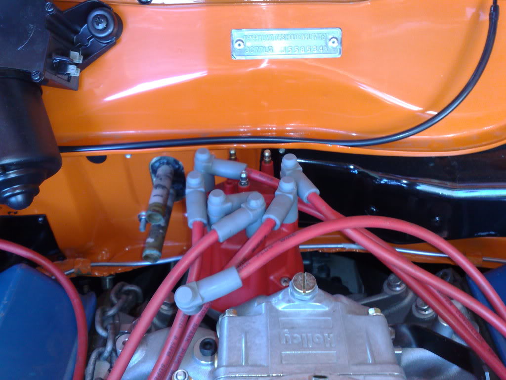

Posted 23 January 2010 - 06:54 PM
Here's how well mine fitted. I think I had HQ mounts at this stage. Torry mounts didn't really make it any better. When they say std leads I assume that this style of lead connection isn't std. Correct?
Correct, standard cap has female terminals

Posted 23 January 2010 - 07:16 PM
Mine has the same cap as yours so it must be the engine mounts my engine seems to sit ferther forward.
My dizy is not under the lip like yours it just in front

Posted 23 January 2010 - 07:24 PM
I'm sure it was HQ mounts at this stage. The Torry mounts made it worse as they lifted the front of the motor, which made the extractors fit... That rear lead terminal was only a couple of mm away from the firewall lip. That crab cap would probably work ok. I don't have picture of the dissy from the side.

Posted 23 January 2010 - 09:00 PM
Mumbo, In the picture it looks like the gutter has been trimmed off the lip on your car. This would increase the clearance a small amount.
Another possible cause of clearance issues is the angle of the engine. The engine angle can vary considerably depending on gearbox and crossmember choice. It may be the engine is lower at the back on cars with clearance problems which would cause the dizzy to lean into the lip. A spacer under the gearbox mount may do the trick.
