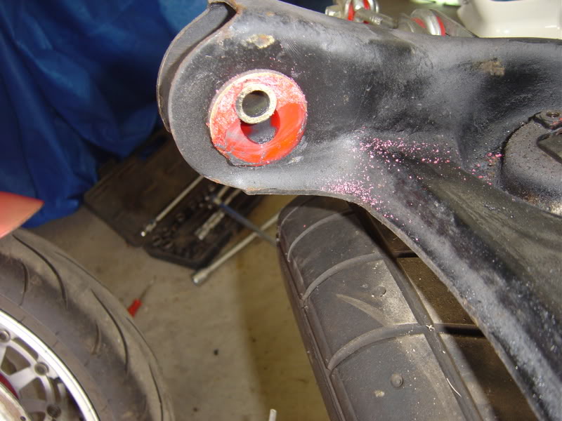

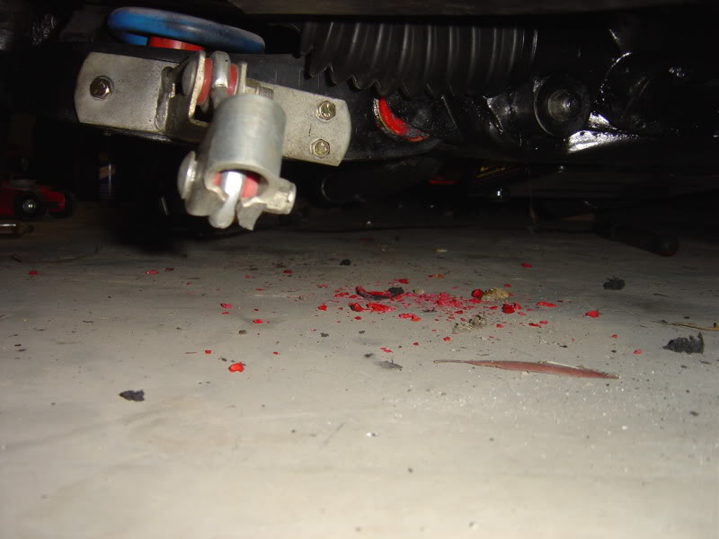

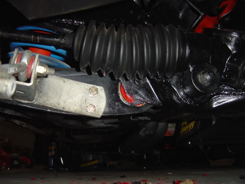

Fitting the extractors today I noticed a pile of red nolathene on the front near the front of the car...I thought Shit! I have rats!...but looking closer it was obvious that rodents couldnt get into the nolathne rubbers...then on looking closer...it was more obvious..the nolathene was just sitting there breaking up in the LCA and falling out...look at the second pic at where the bolt is now sitting ...at the top..not in the centre as it is supposed to be.
I will replace it but just thought I would throw it up here...heard of it but never seen it before....it is just sitting there decompossing onto the floor...weird.

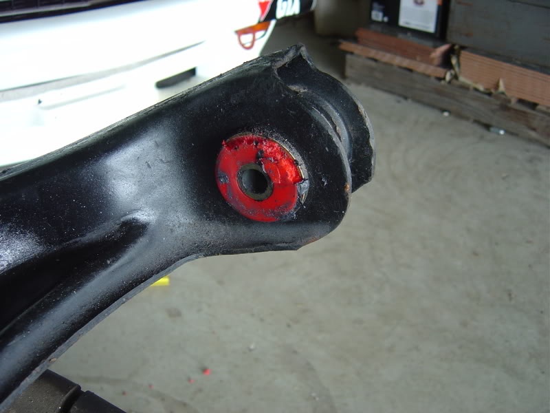

Whipped the LCA out this morning...you can see the results.other one is starting as well.
Appears to only be the 2 on the drivers side..all others are fine.

After rechecking the left side...it has collapsed too...I have done the drivers side..now have to do the passengers as well! Shit!!!
