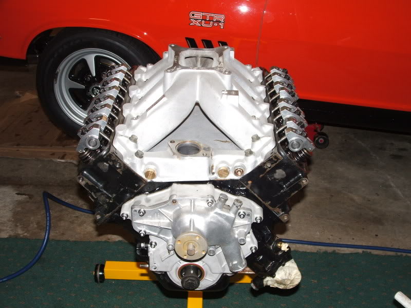

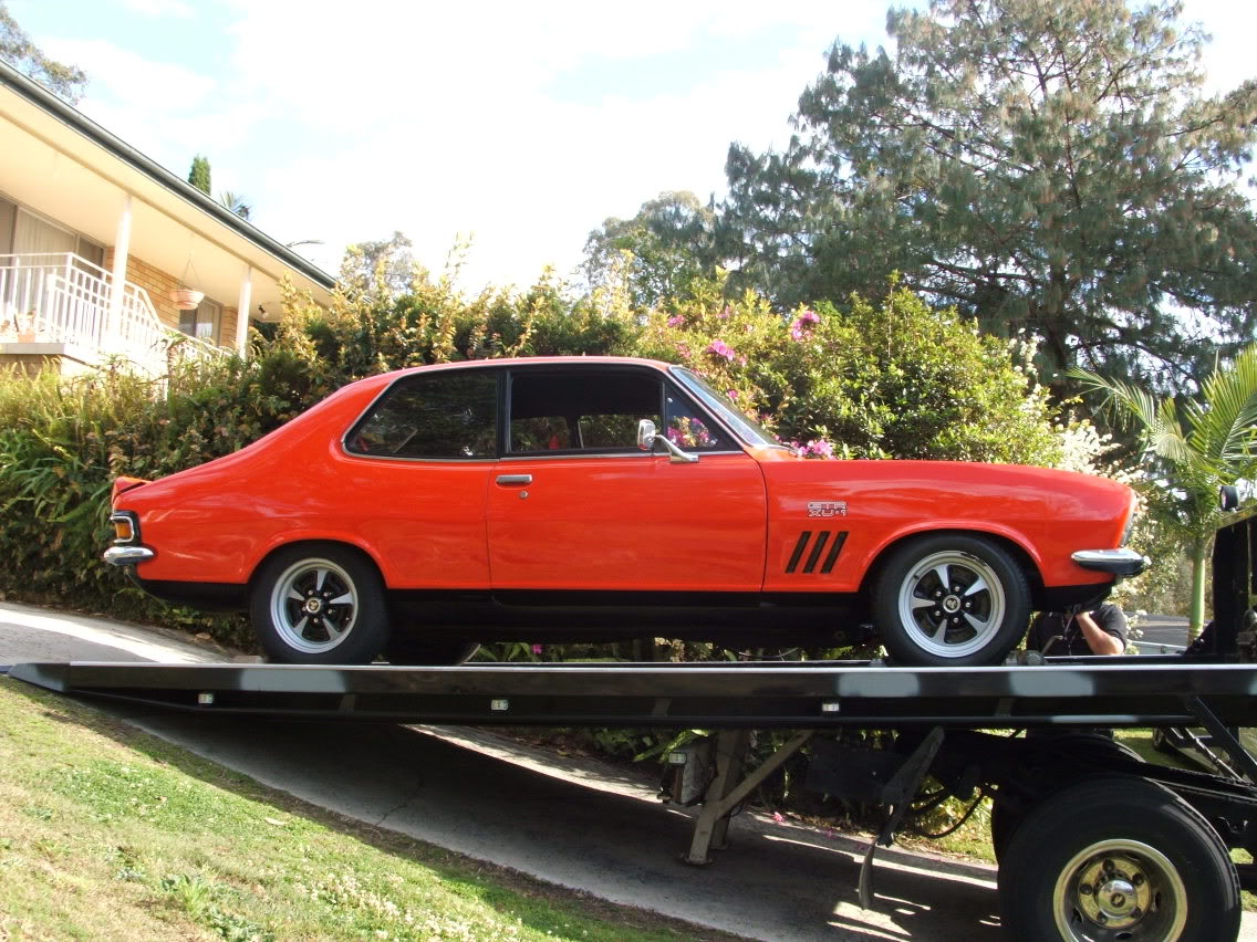

Hey everyone thought id share my new project hear for you its a LJ currently running a 355 stroker vn heads harrop manifold th350 4000 stall 4.11 nine inch mini spool very loose on the street

https://cache.gmh-to...5/GTRXU1021.jpg
#5 _LJ355_
_LJ355_
Posted 22 April 2006 - 11:56 PM
https://cache.gmh-to...5/GTRXU1019.jpg
#6 _LJ355_
_LJ355_
Posted 22 April 2006 - 11:57 PM
#7 _LJ355_
_LJ355_
Posted 22 April 2006 - 11:58 PM
https://cache.gmh-to...5/GTRXU1116.jpg
#8 _LJ355_
_LJ355_
Posted 22 April 2006 - 11:59 PM
https://cache.gmh-to...5/GTRXU1074.jpg

Good to see another lj v8 on the forum.

love the gts rims on it it really sets it off :spoton: :spoton: :spoton:

Sweeeet!!!! Where'd you get the extractors from? Are they custom made?

Thanks rodomo ill try that next time im new to this stuff ! noslh they are crs extractors with jethot coating there a little small for my liking i would like a set of 4 into 1 with a 3 inch collecter these are only 2 1/4 bart i just got some genuine dress gts dress rims they look tops very sleeperish ! as i have no scoop on the bonnet it looks standard im now just getting it sorted out for the engineer just little things like demister(12volt hairdryer !) i wired it to the original switch speedo cable reverse lights think thats it ill keep you posted.

thats a sweet lookin chariot mate i like the GTS rims also nice look,i can understand the traction issues mine pretty sick when it comes to wheel spin.no tubs allowed in WA thats why im thinking of selling mine i want more power but theres no point if its just going to spin more. anyway awesome car mate.

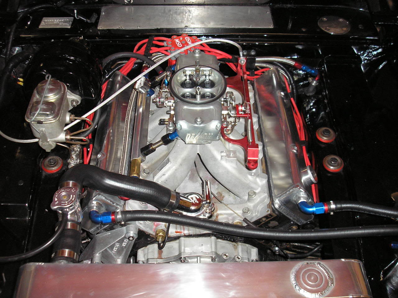

Heres exactly what im running

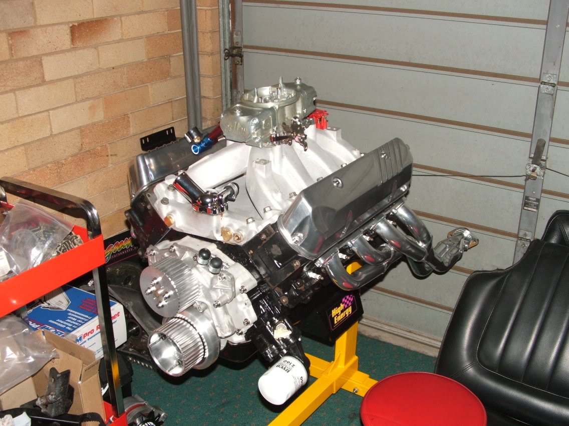

ENGINE
308 black block bored 40 thou
harrop 355 crank
chev rods
keith black pistons
full arp stud kit
VN heads ported and throated
roller rockers
hi energy sump
solid camtech cam
GEARBOX
Turbo 350 fully manulised
Kevlar plates
4000 dominator stall
B&M pro ratchet
DIFF
9 inch 28 spline billet axles
4.11 mini spool
3 inch thick wall tailshaft
FUEL
Barry grant 750 mighty demon
carter 15 psi pump
1/2 inch lines
harrop manifold
external filter
ELECTRICAL
MSD 6AL
blaster 2 coil
pro billet dizzy
MSD leads
COOLING
Alloy desert cooler
2 10 inch fans (sucking)
1 14 inch (blowing) back up !
oil cooler 1 8 inch fan

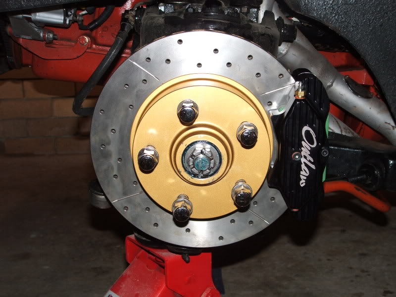

BRAKES
HQ stud patern all round
outlaw 4 spot calipers
slotted rotors
HZ drums
XA booster

That looks pretty sweet mate. :spoton: :spoton: :spoton: :rockon: How does it pull up with the larger brakes?

Yeah it stops really good mate im doing discs on the back next but those outlaw calipers are really good and not that expensive.

Does your extractors require any mods to the crossmember? ive got early heads and extractors on mine, but a mate has offered me a vn head setup thats just to tempting, is your car a gtr?

Hey mate the extractors fit straight in the VN setup is the way to go my car is a genuine XU1 but before any has a go at me for putting a V8 in it its missing one tag and didnt have the JP 202 when i got it so i didnt see the point of keeping it original also to if i wanted to i could put it back to standard but i just want V8 !
