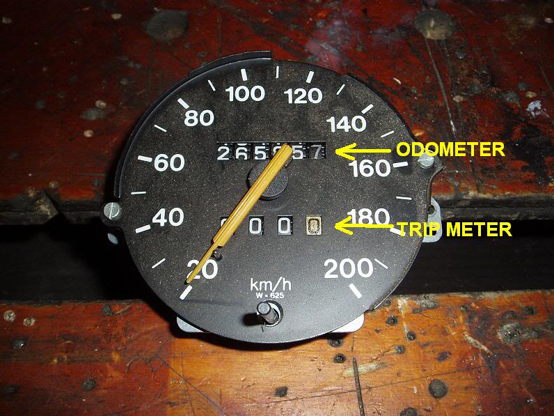

This pic identifys the difference between your speedo and your odometer.
This speedo is Commodore (no Torana speedo was harmed during the production of this thread)as sometimes people might say my speedo isn't working when in fact it is, but the odometer isn't.
Also shown is a trip meter.

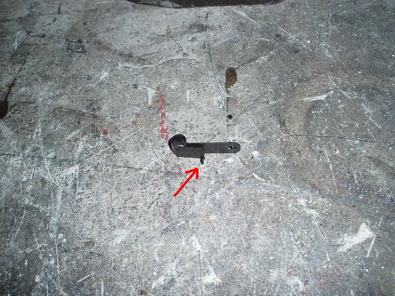

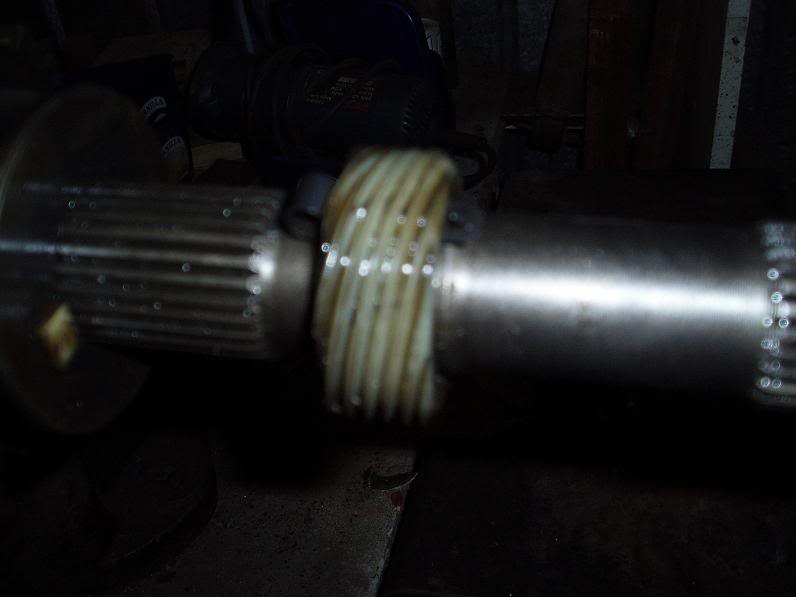

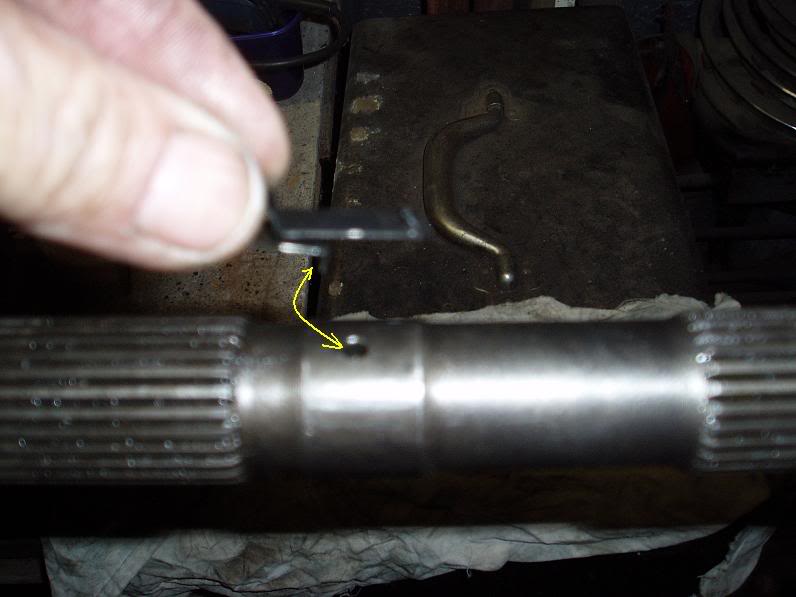

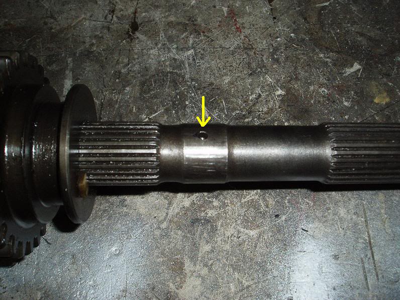

This is the output shaft of an Aussie 4 speed. You will see the hole in the shaft that drives the clip for the speedo gear. This shaft also drives your tail shaft.
The speedo drive gear clip is made from spring steel.
It fits into the hole in the output shaft.
And the clip drives the plastic speedo drive gear. The splines you can see in the gear are just to let the gear slide over the splines in the shaft, they do not drive the gear, only the clip does.
So here is the output shaft, driving the clip which drives the gear. These are all housed in the extension housing.

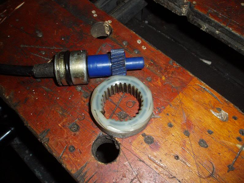

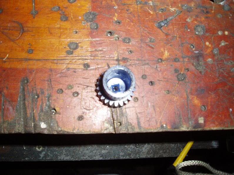

The drive gear drives the driven gear which drives the damn cable.
Driven gear is blue in this instance but there are other colours as well as different coloured drive gears.

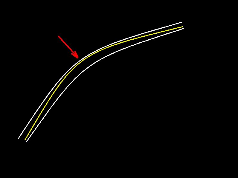

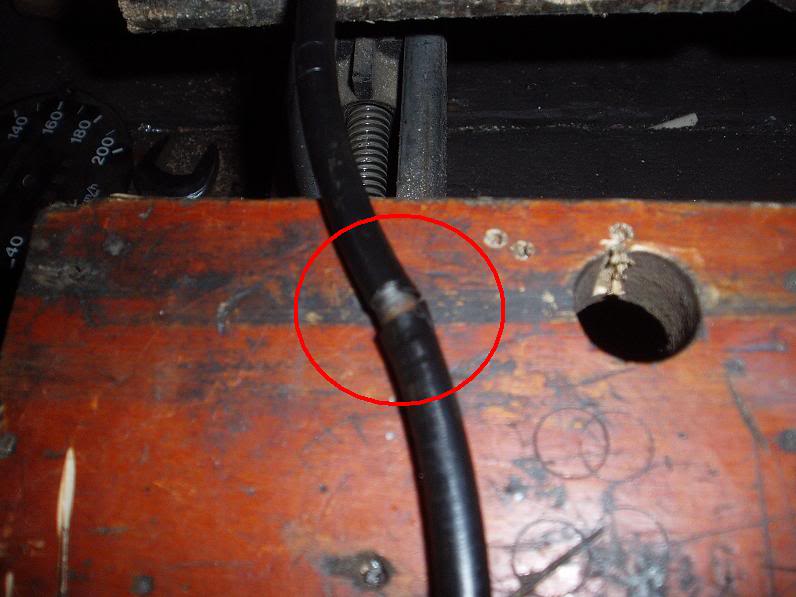

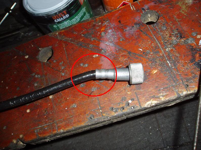

This cable was recently removed from a LC. The inner cable was broken at this kink near the speedo head.
Here is a recent thread which tells of this type of kink being common on LC/J if the cable isn't correctly routed.
http://www.gmh-torana.com.au/forums/index.php?showtopic=46456&st=0&p=513321&hl=speedo%20cable&fromsearch=1&#entry513321

Undue load on the cable can also cause the cable to "whip" while rotating. This means the cable can slow or stop momentarily in a tight spot but then as the cable is still being driven, and therefore wound up, it will "whip" suddenly as it is released, much like a wind up spring would.
This will cause a flicking/jerky needle at the speedo head and you might also hear noises from the cable.

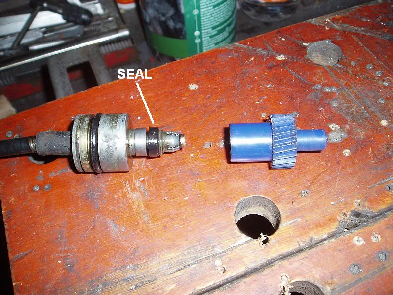

The cable also has a seal where it enters the driven gear. This is to stop gearbox oil from entering the cable. I'm not sure about Torana but I have seen cars leaking oil from the speedo head. :blink2:

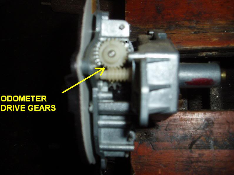

And we know that the odo and trip in almost every early Commodore ever made stopped around 200k because they stripped one side of the stupid worm gear...
Yes, and the little gears running up the side also split and no longer grip the shaft.

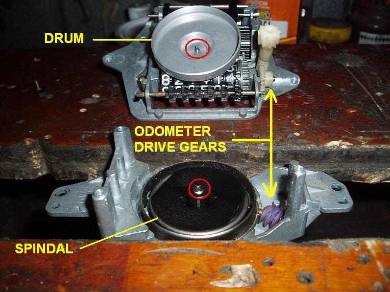

SPEEDO HEAD.

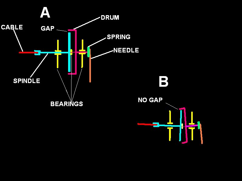

This next pic shows the sacrificial Commodore speedo head apart. The spindle is magnetized and as it rotates, it starts to drag the drum in the same direction magnetically and the needle starts to lift against spring pressure.
The only mechanical link between the spindle and the drum is a tiny spigot that still allows the spindle and drum to move independantly of each other.
The diagram shows a side view. B shows what happens as the spindle and drum bearings wear.
The spindle and drum cock in the bearings and the gap between lessens to a point where the spindle and drum can actually touch. A give away to this initially could be a noise in the speedo head and the needle reading higher than it should or the needle will act very erratically, violently jumping backwards and forwards.

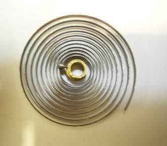

A bit hard to get a clear pic of the needle return spring but they look a bit like this and hide in behind the speedo face.
I've heard that 4cyl Toranas dont have a needle return spring as they struggle to find enough horsepower just to lift the needle? :dontknow:

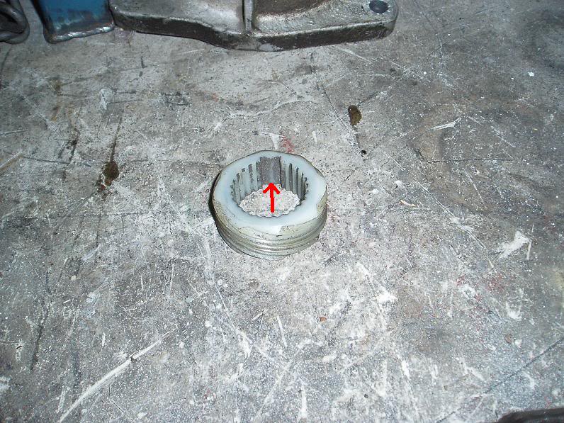

Make sure the square holes in the driven gear and speedo head are clear of any debris before you fit a new cable. If the holes have crap in them, it can compress the inner cable as you tighten the nut at the speedo head. This can put undue load on the inner cable as it will be pushing against the sides of the outer cable.

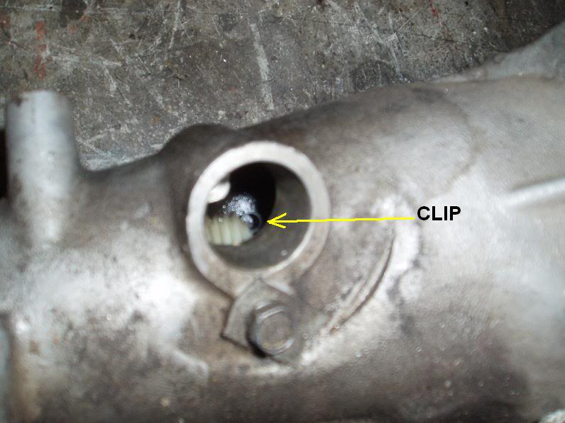

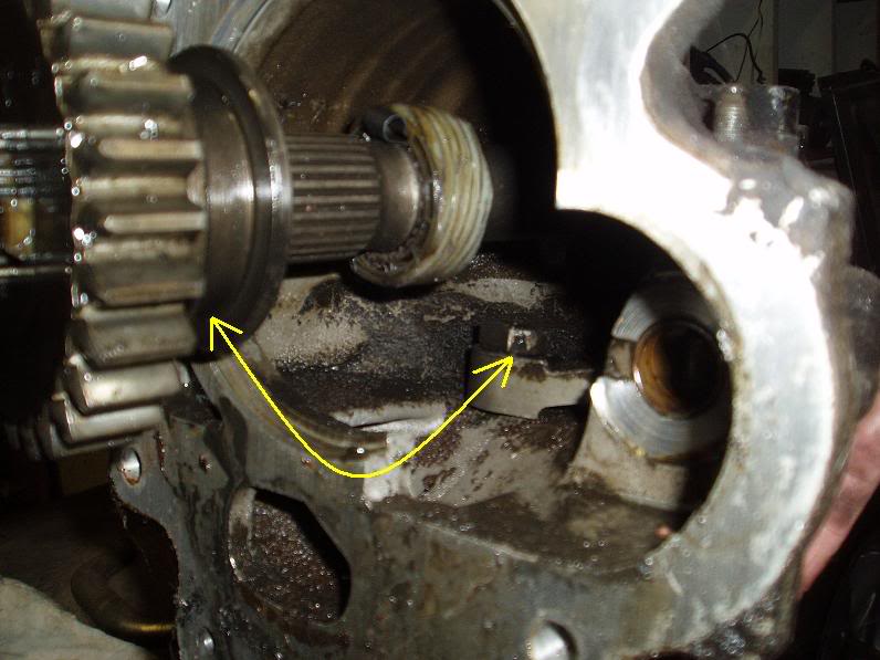

With a mirror and light, you should be able to see the condition of the drive gear and clip without pulling the extension housing off. Rotate the tailshaft to position the clip into view.
If you have to pull the extension housing off, take care when refitting it to align the reverse gear selector back into the groove on the gear.
Also, use the correct gasket or if you have to cut one, use the same thickness paper as original.
If the paper is too thick, the output shaft can move backwards enough to start synchro or jumping out of top gear issues.
