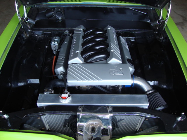

i've got a radiator from a mob called Fenix radiators they are a New Zealand based company who have recently set up in Australia, all the radiators are made in kiwiland. i have one in my LJ (5L) and have had absoulutely no problem with it even in summer sitting in traffic. The best thing about it is it was only $350 and it looks tops. :rockon:
http://www.fenixautopart.com/
#16 ls2lxhatch
Posted 26 June 2010 - 01:04 PM
It is interesting that they have put the radiator cap in the wrong spot. Normally it would be as far away from the top inlet as possible.
